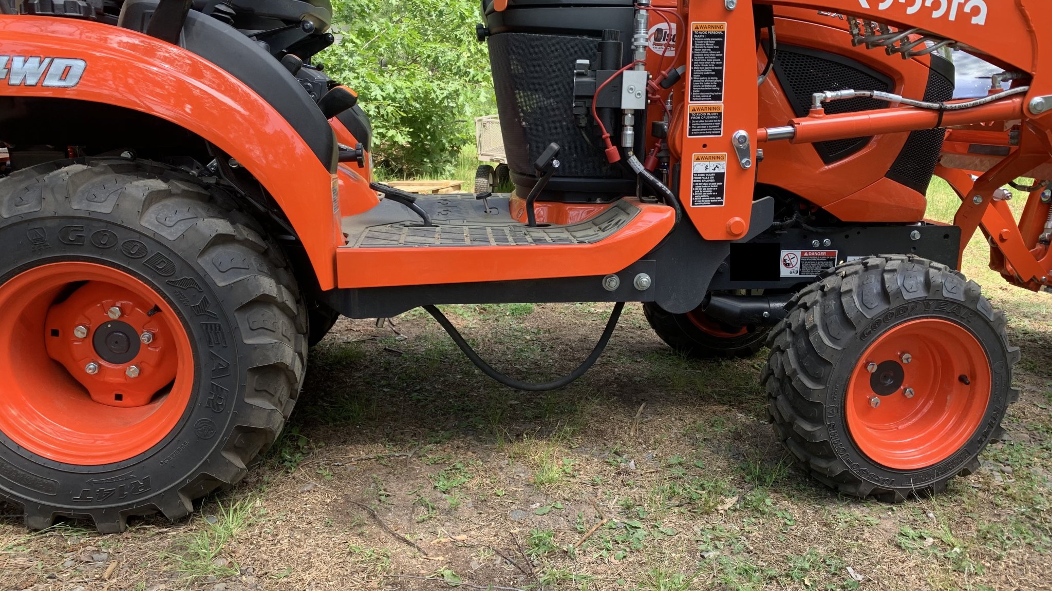

Hey. Got a BX23S, Landpride 3rd function, bucket, grapple, pallet forks, 3 point kit. My first tractor, but really my first real piece of hydraulic equipment as well. I've got a few acres I want to better maintain. Some trails (~1.5 miles), a driveway (0.5 miles), lots of forest and some food plots. I am excited to move from shoveling gravel into a wheelbarrow to something that is a lot better use of my time, especially now that I have kids. I have a 6x4 gators with a dump bucket, should really make life easier.

Below is pic of dangling hose. Not sure how the dealership missed this... Of course I found it immediately after their delivery guy left, not in their parking lot during the walk around.

#3 The third function kit likely has hoses for a tractor that doesn't have a backhoe, have new hoses made that fit.

#3 Yes zip tie it up out of harms way!

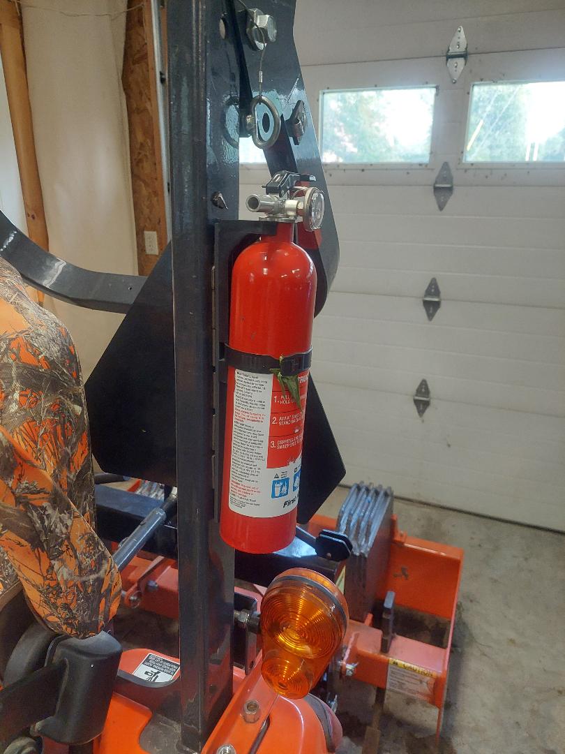

#5 Magnets. 1/8" x 1 1/4" plate bolted to plastic mount attached with Neo magnets.

I have the LandPride 3rd function hose on my tractor, and if it were routed properly, the hose wouldn't be sagging, not to mention that all the hoses from LandPride were the exact correct length. If the hose was too long, then the dealer should have had the hose cut to the correct length and a new end installed to complete the job in a good workmanship way. I would suggest that you send the picture of your tractor to the service manager at the dealership to show him the type of work that the tech that worked on your tractor is sending out.
That hose is supposed to go between the frame rail and the floor pan. Here is a link to the PDF color instructions for installing the LandPride 3rd function valve. https://messicks.com/uploads/assets/380-289A_color_copy.pdf

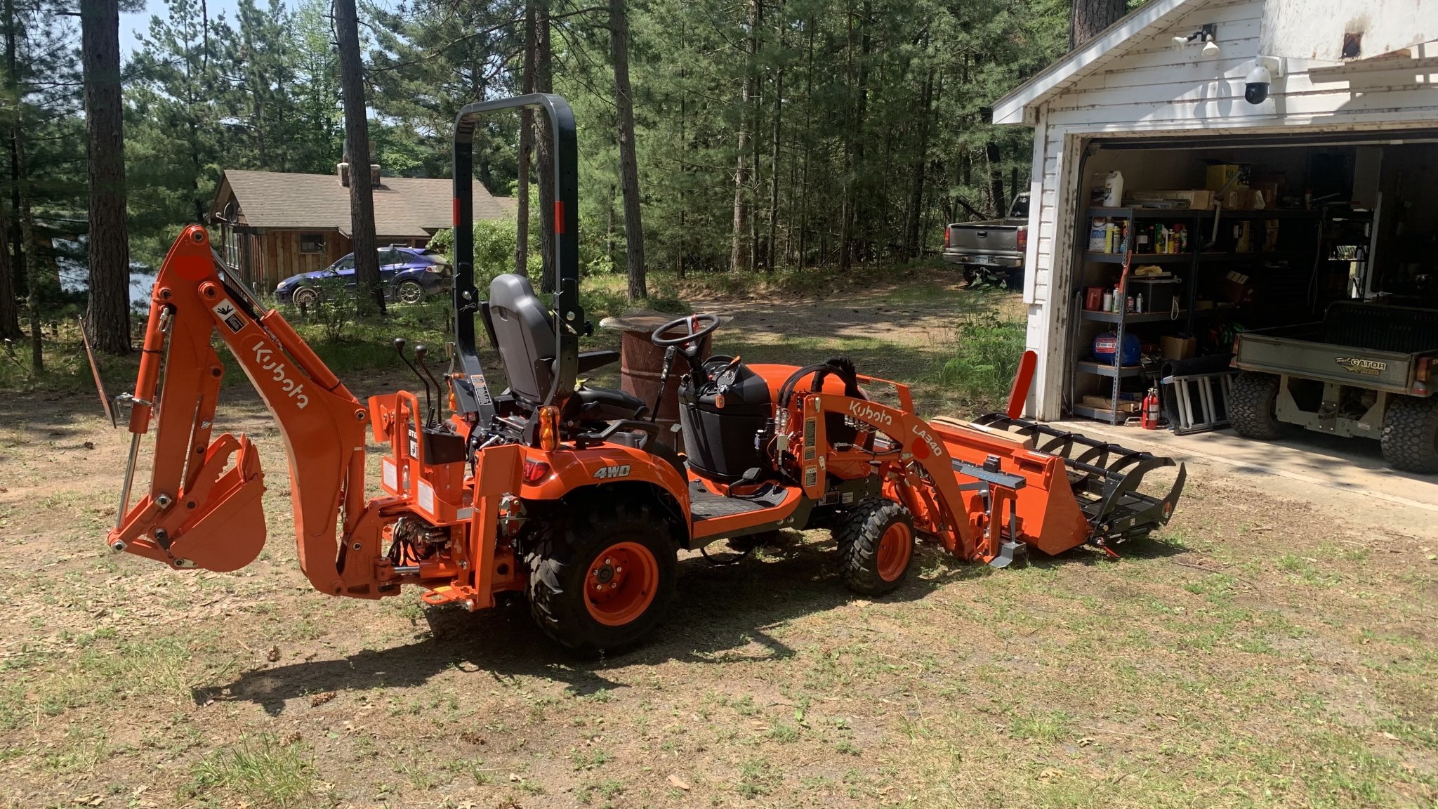

Here is a picture after my tractor was delivered. First problem crap install, second problem I specifically requested the Kubota 3rd function kit not Land Pride. Dealer took the tractor back, and installed the Kubota 3rd function, I was happy as a clam.
Few of my favorite upgrades, Bxpanded under armor, filled rear tires, 2” rear wheel spacers, Bxpanded backhoe dolly, and Bxpanded tool box.

I opted for the LandPride 3rd function rather than the Kubota since the Kubota kit is more a diverter valve and the Landpride is a true 3rd function. We all have our own reasons for what we prefer, and there is no right or wrong decision.
I will say that by the end of the "season," you might have already ripped that hanging hose off the tractor and it will cost you a lot more than just replacing a torn hose if it damages the valve that it is attached to. I would insist that the dealer take proper remediation of the poor quality installation, but that is just the way I am. When I am paying for something I never accept excuses for poor workmanship.

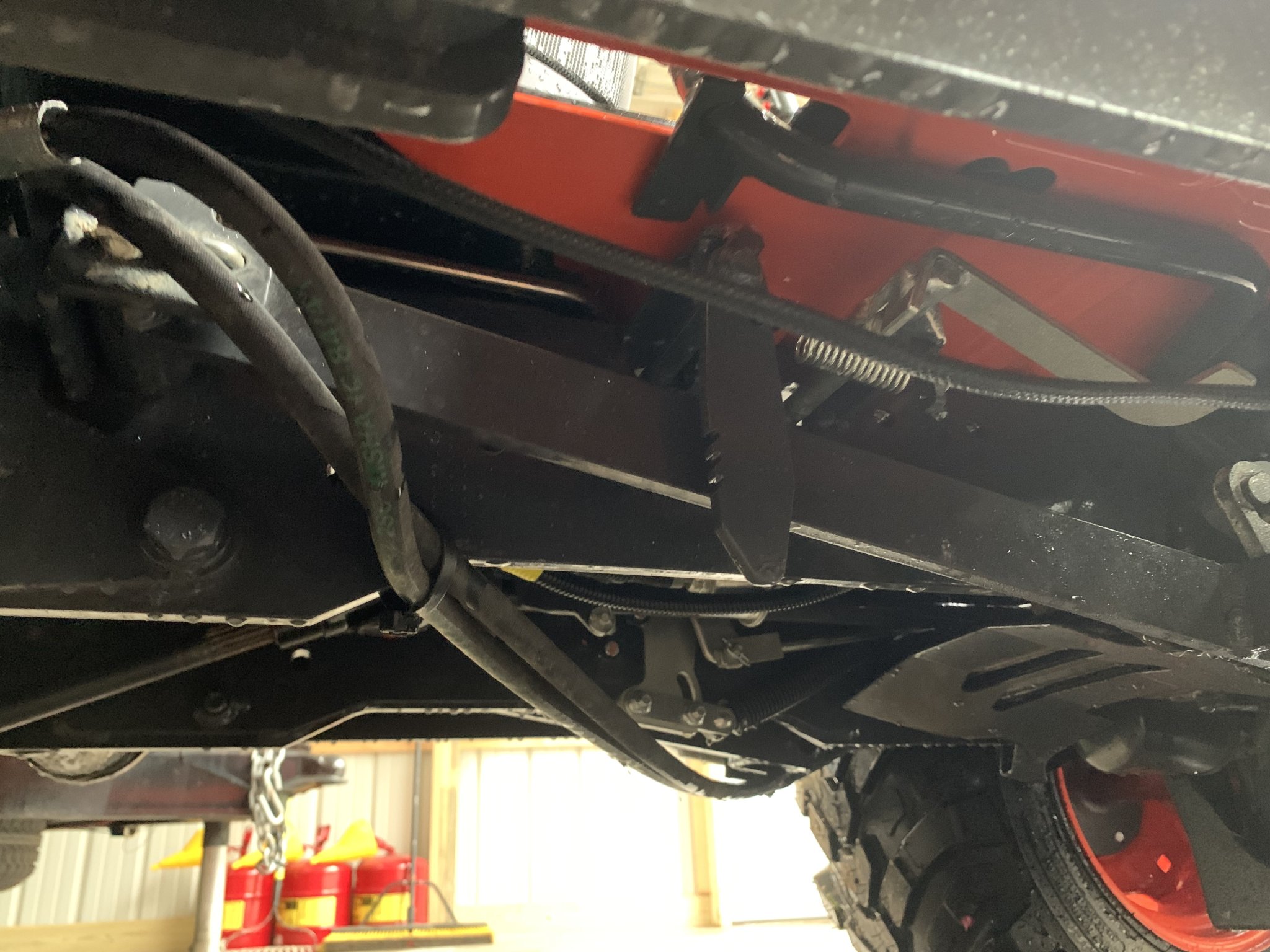

Here is where they zip tied my hose, this may have interfered with my Bxpanded skid plate. Lol.
Your dealer's service department needs to have a rude awakening that isn't the way it should be done. At this point, I would just fix it properly and only use that dealer for buying things that I have to have immediately and shop elsewhere for major purchases where service is a factor.
