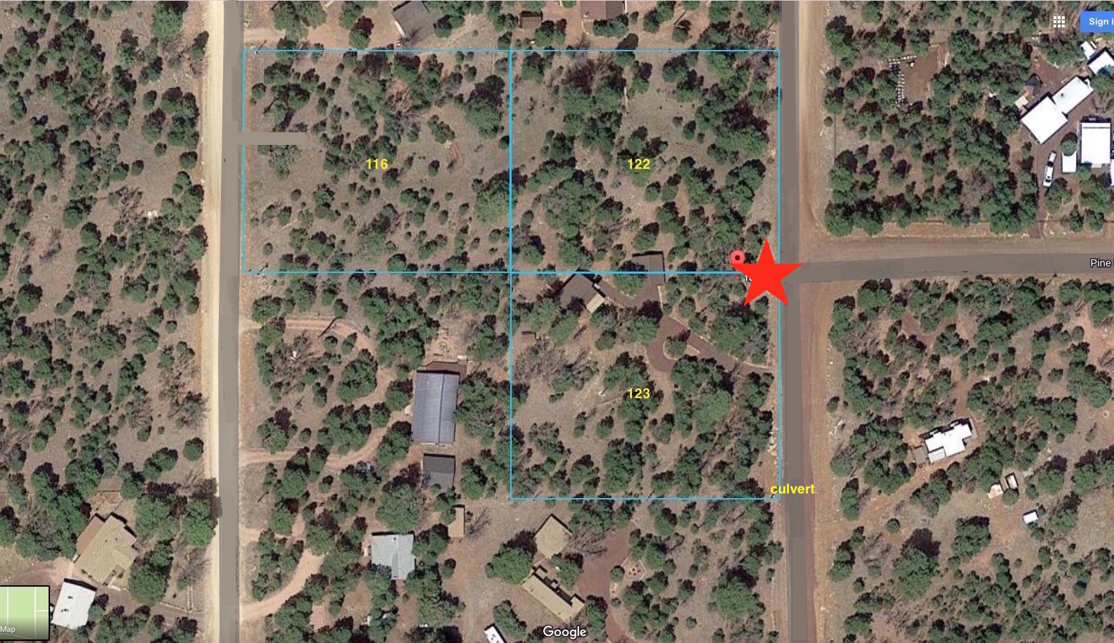

On my property in the high country, I knew where all 8 of the corner pins were- a rebar stake with a rock cairn around it.
I say knew, because the county culvert at the corner of the property plugged up, causing a huge monsoon rain runoff to backup & flood the area across the road from my driveway. When the water got high enough to reach the crown of the road, the road washed out to a depth of 5+ft, and 3-8ft wide, right at the point were my center pin was. (red star)
Afterward, there was a delta of approximately 2-4ft of roadbed material over the top if the pin, maybe 30ft wide & 50ft long.
I measured from the 3 adjacent pins, to where the pin should have been, and started digging. At about 30 inches, I got a signal from my metal detector, and found the pin about 6 inches further down, right where I had measured it to be. I slipped a short pipe over it, and inserted another piece of rebar, and filled it in.
When the property was surveyed, the surveyor said my pin was less than an inch off. :)
