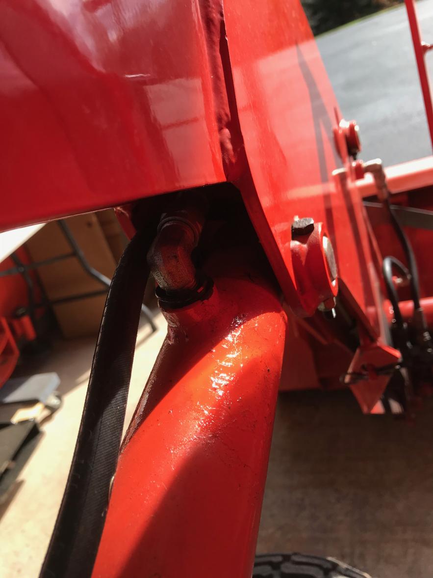

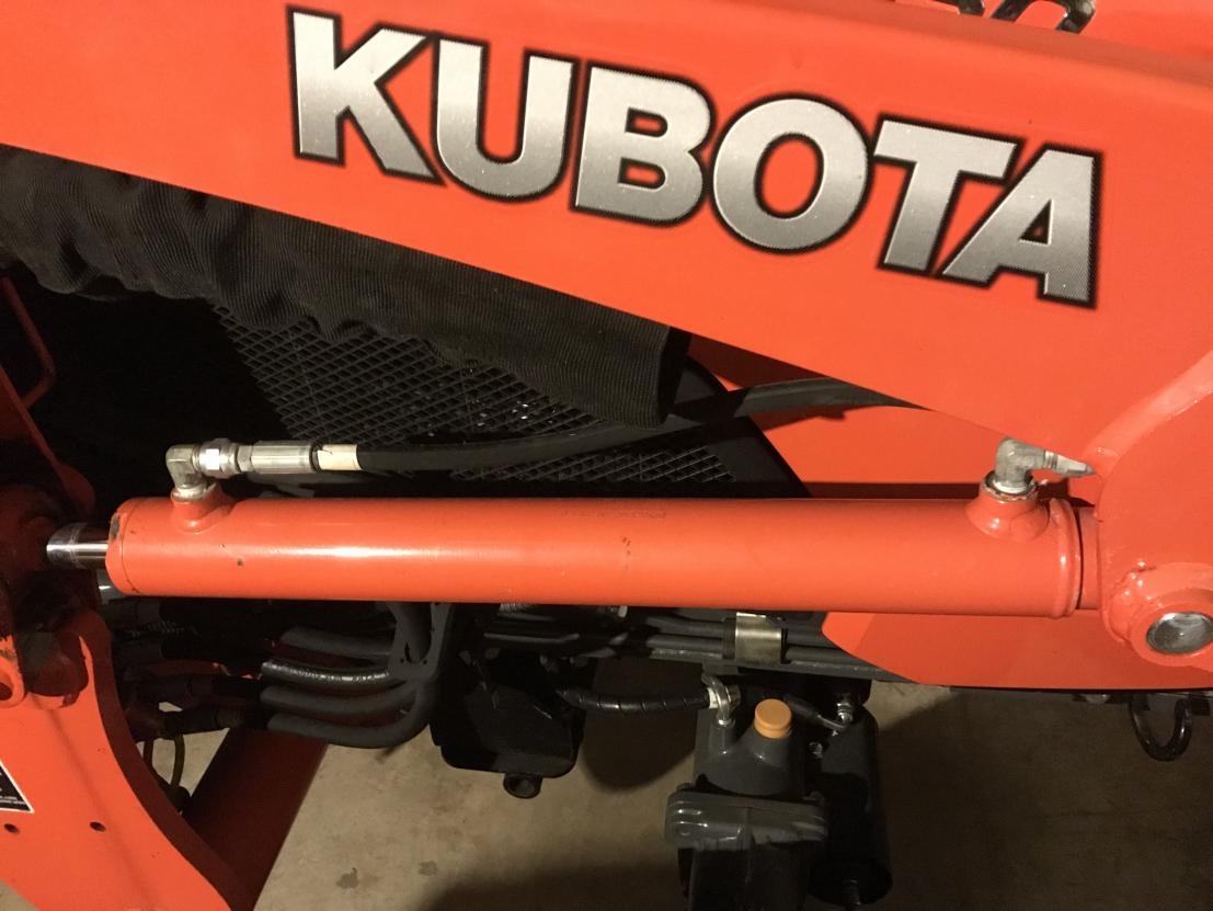

I was tearing out the scourge of the earth (Japanese bayberry) yesterday with my FEL. Work was seemingly lightweight, went in maybe a few inches with the PBar to take up the root systems and deposited the rubbish out to a distant field.
After a few hours I smelled hydro fluid and I noticed there is a leak in the front left. I'm not sure how to fix it as I see a rubber seal popping out. I'm not sure if its just a "paint seal" or if its part of the way its made. The difficulty lies in its position and seems hard to get to.
I cant tighten it because its an elbow and has no where to turn. Its hard to get any tools in the tight spot. I'll assume I need to disconnect the FEL to work on it so its not attached to the "live" system.
Any advice on how to get at and repair the leaking area? I see they used teflon to assemble the attachments, from what I understand thats not good. Best practices? I have the liquid hydro sealant .
Thanks

Hard to tell from the picture, it could be an o-ring style fitting which usually has a piece of metal for a back up. It could be pipe also?
Anyways drop the hose off the fitting and you could cheat and remove the pin on that end which is the base end of the cylinder and let it drop down on the tire to work on it.
Pipe thread should be sealed, nothing for o-ring or JIC
Drop loader down all the way and bleed off all pressure before removing any thing!
Also note the clock position or indexing of the fitting so you don't drop it down to line up the fitting with hose end.

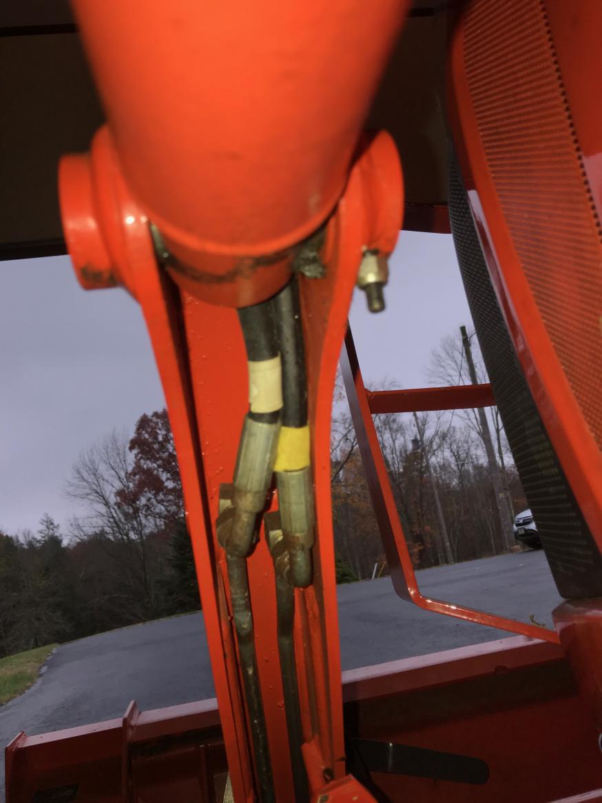

OK so I'll take off the hoses from the tractor. I'll try to take the pin off to give me some room to work. Thats seems the only solution. There doesn't seem to be a place where I can disconnect the hoses where the yellow and white tape is. (last picture) If I can get the pin out and get room enough to work I'l unscrew it slowly to relieve pressure, apply some new sealant and tighten it down more in hopes it'll hold.
What I don't get is why its leaking. It seems as solid as a connection as any of the other ones. Not tight enough? Teflon break down? Excessive pressure?

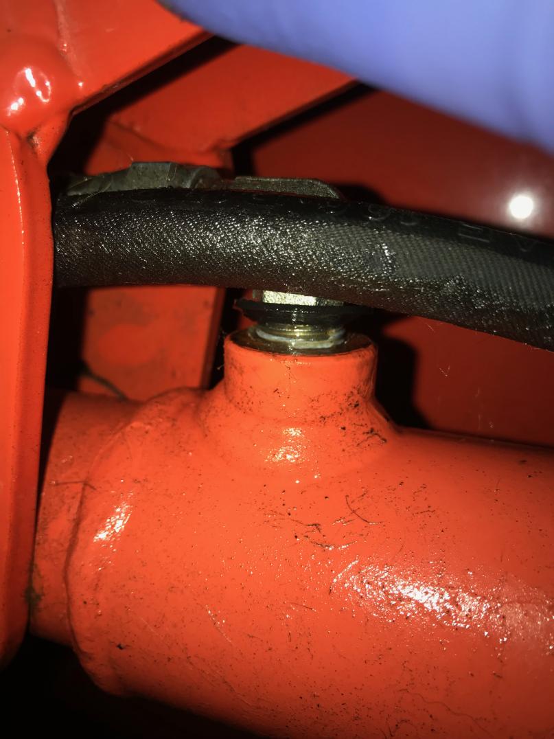

An ORB elbow fitting should have a lock nut backing up a washer to compress the o-ring properly when the elbow is facing the desired direction.
The fitting on the bottom of the lift cylinder definitely looks like a pipe thread -- no sign of a nut or o-ring. But the picture of the leaking fitting seems to show an o-ring, as if it was an ORB fitting. I very much doubt that a cylinder would have two different joint styles on either end, and have to wonder if a previous owner jammed an ORB fitting into a NPT outlet or vice-versa. What do the fittings look like on the other arm?

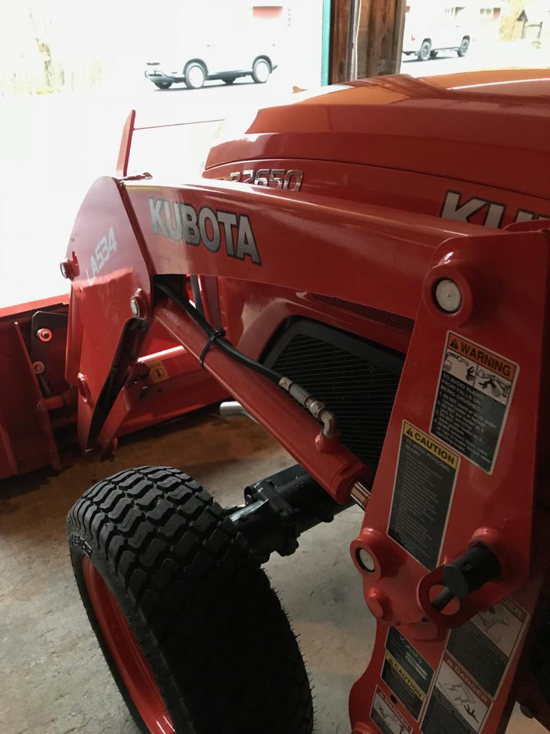

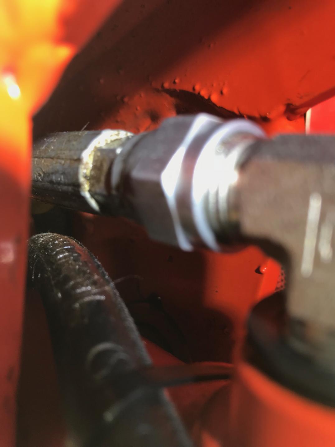

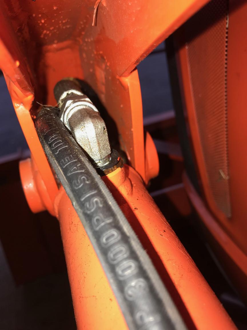

It look like a paint seal. I guess they threaded it after the fact and they put it back? Or do they thread it and then paint it? I thought the dealer put it together.
1 and 2 are of the left side, 3 is the leaking one, I was able to push the rubber washer up easily with my finger. They both appear to be threaded in the hole the same amount. Does the leak happen just because the teflon seal broke or are there other factors?
Once the rain lets up I'll work on it.

Looking at #3, is there any chance it's actually leaking at the hose end (appears to be JIS flare?) and spraying onto the fitting, making it look like it's leaking at the cylinder side?

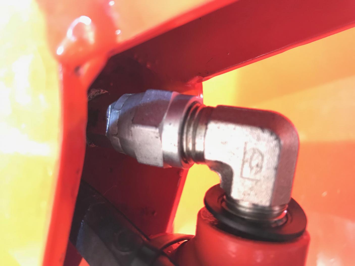

Without dropping the pin, I cleaned it up and wrapped a paper towel around the bottom and left side of the the elbow. I zip tied the hose out of the way and used the FEL for 20 minutes until I started to smell the hydro fluid again.
So its not the cylinder side, or the hose running over it. It looks like the left side of the elbow where the JIS flare is. So now it could be either the JIS flare screws into the elbow or where it looks like its crimped into the JIS?
There looks like two places I could put my wrench. Closest to the elbow where it appears to be leaking and closer to the hose where it appears to be crimped.
Should I just tighten it up closest to elbow? Should I drop the pin, remove the JIS flare, and reseal it?
If its not leaking at where it meets the elbow, I see another wrench spot, can that be tightened too, or is that crimped? If its leaking from the crimp size, how is that repaired?

The JIS flare is metal to metal. All you can really do is tighten it if that is the source of the leak. To do so, you tighten the flare nut right were it screws onto the elbow, not the flats on the hose. If you can get a wrench on it (perhaps a crow's foot wrench or basin wrench) then you don't need to remove the pin.
If it's leaking at the hose end of the JIS connection, all you can do is have a new fitting crimped on (if there is enough slack in the hose to cut the old fitting off), otherwise you must replace the hose.

I was able to get a wrench in there and tighten it but the entire hose started to rotate as well. Is there a way to stop the hose from rotating and just tighten it on? If I'm able to get the get a tool on on the flats where the hose is to hold it will that stop it from the hose spinning? I didn't want to force it and make it worse.

Use two wrenches, one to hold the flats on the compression end of the hose fitting to stop the hose from twisting and the other on the flats of the JIC swivel. You do not want to put a twist in the hose, it creates undue stress on the hose wire braid and will lead to premature hose failure.
