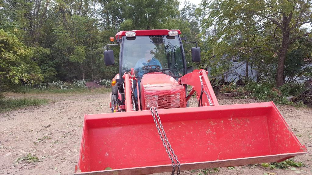

I like a slip hook in the middle, as it is easier to use a strap on a slip hook.
When using a chain I simply pass it through the slip hook over to a side grab hook. I only lift with the side hooks, or pull with them, if both are used at the same time to keep loading equal on both sides.
For me this layout is ideal. The grab hooks are 3/8 inch.

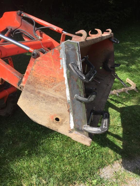

Picture was taken when I was adding reinforcement to my bucket sides after bending one side somehow.
