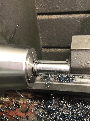

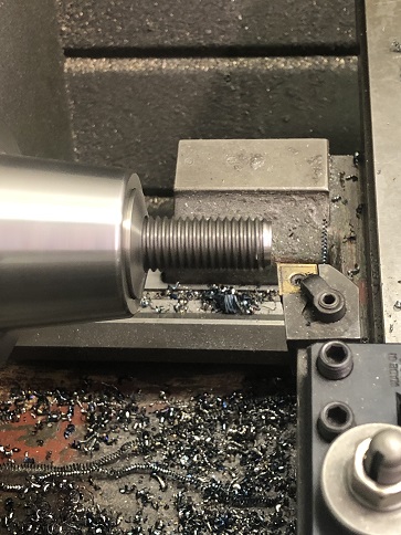

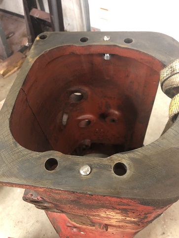

Going back together. I made up some replica removable dowel pins for the clutch housing. In theory, you put a nut on the threads and they will back out of the blind holes. That is if they don't rotate. This will be the next guys' problem. Anyway, installed them and then attached the clutch housing without drama.
