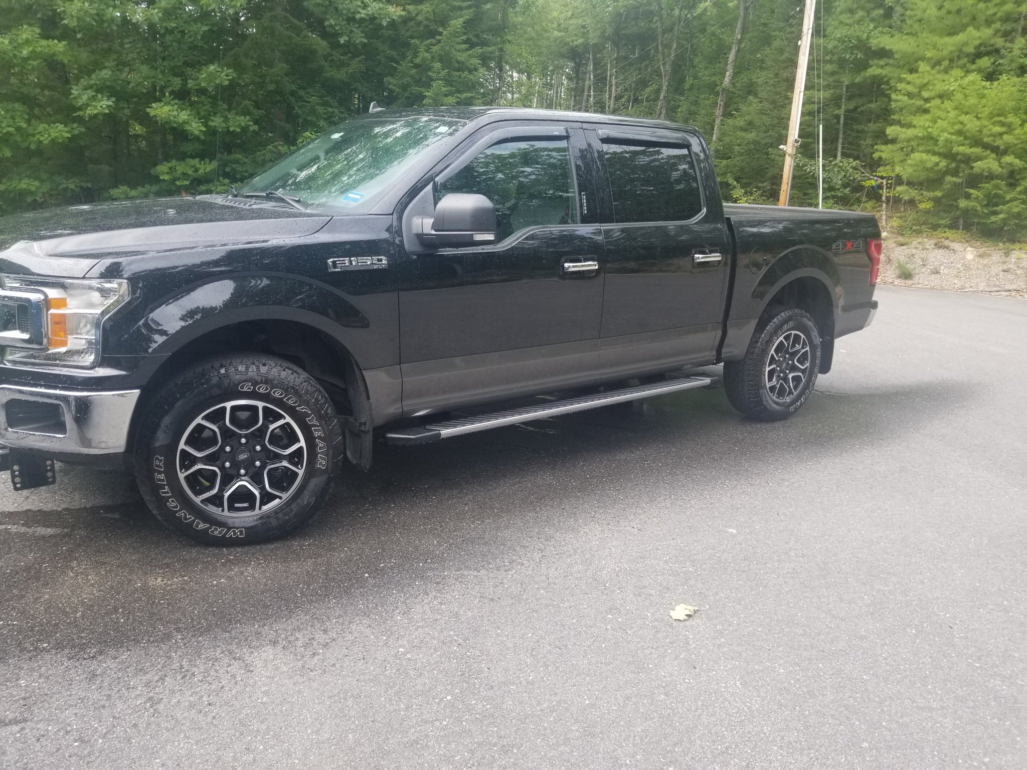

Here's my latest F150, 5.0L, 400hp V8.
(note: even my girlfriend is a Ford, and she refuses to drive one, lol)
I just love Fords. View attachment 76558

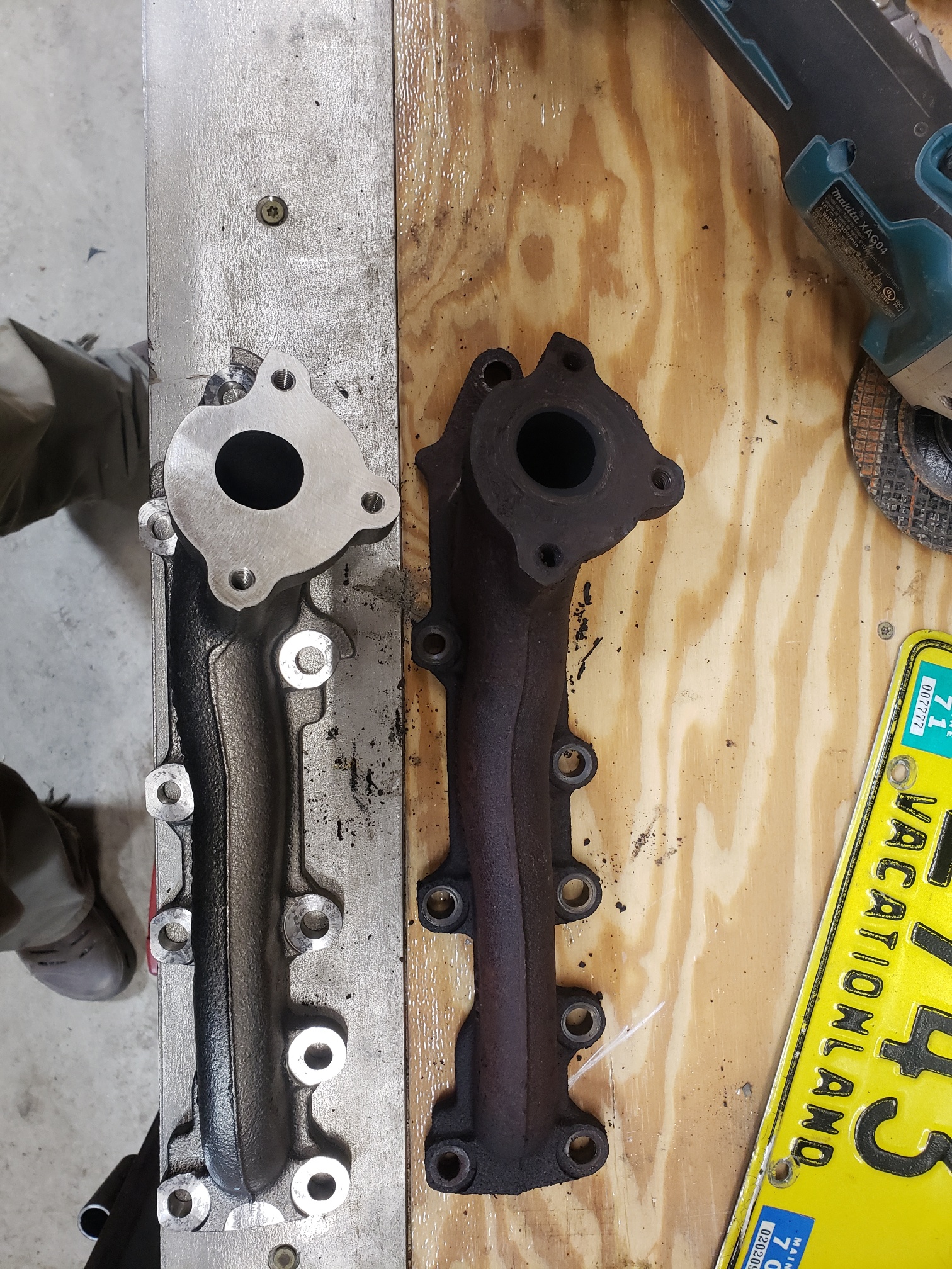

Ford changed the mounting scheme for the manifolds. Heres a new oem manifold next to the old one. The old manifolds didnt use several available stud holes in the block, new manifolds do but why didnt they just do that in the first place? Save the cost and weight of a couple studs?
old manifolds have 1/8" inch of warp.

new one seems 'meatier' around the mtg holes.
cost would have been the deciding factor. Some 'bean counter' ran the numbers and the extra material and time, down the assembly line didn't outweigh the cost for those operations. Saving $1 off every vehicle adds up real fast when you make 100k 500k or 1 million units !
The wife’s explorer manifolds are like that. Holes are in the head but not on the manifold. I noticed it while removing the rear manifold to replace her power transfer unit (transfer case) after it ate itself at 70k miles. I get a new motor craft part (reman are not even available) less than 100 miles on that and the output shaft seal starts leaking. It’s a big job to take out the case for warranty so I bit the bullet, ordered a seal $30 later and now it’s leak free. Ford, quality is job one!
because the heads are used in multiple applications and all the holes arent necessary to get it to seal properly
