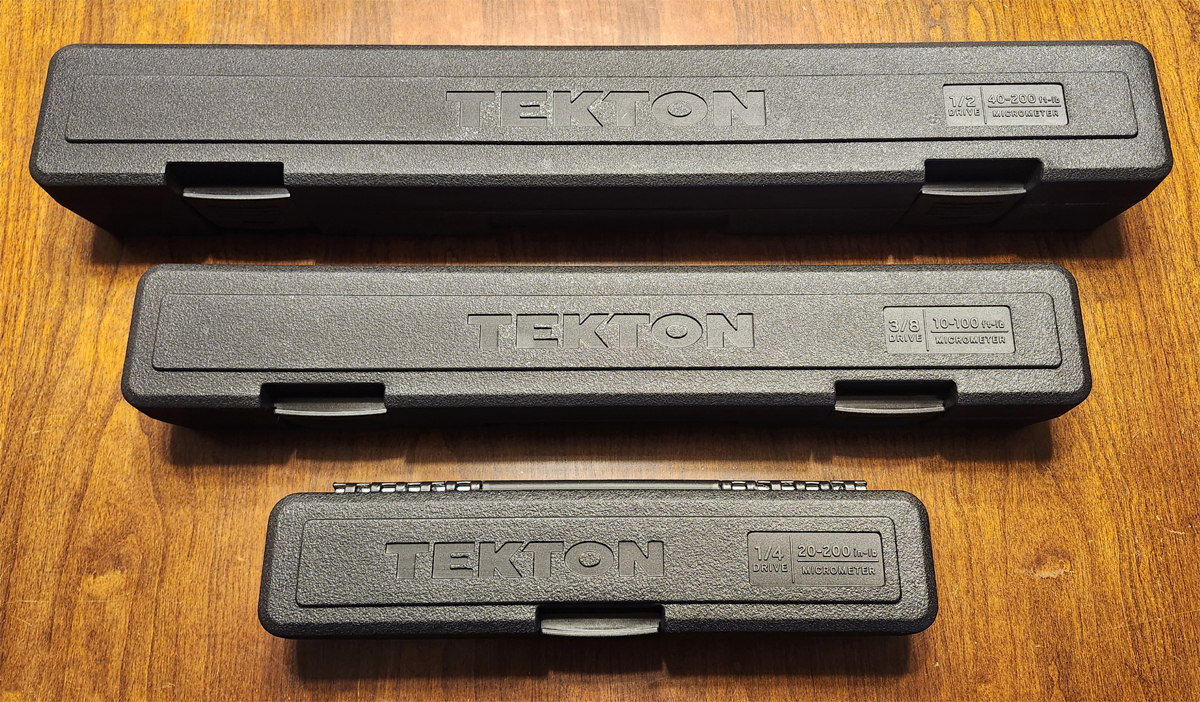

This morning I was watching a YouTube channel that I subscribe to, and a Caterpillar bulldozer head was being reinstalled. He was using an electronic Snap-on flex head torque wrench to tighten the head bolts. It occurred to me that being an electronic wrench, it could account for the change in angle of the head and therefore adjust for the actual torque being applied based on that angle. That's definitely a big plus for electronic torque wrenches.
The TEKTON micrometer torque wrenches I ordered don't have a flex head, which makes sense since there would be no way for the wrench to adjust for angle.

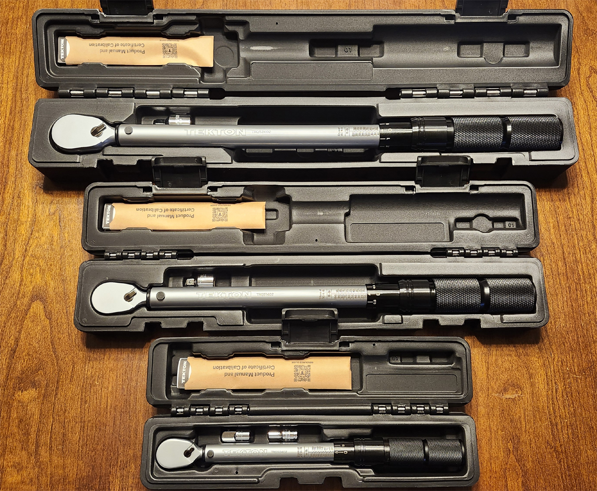

The TEKTON torque wrenches showed up yesterday along with a cryptic message from USPS and Amazon. The wrenches are typical TEKTON quality and it's no wonder that the brand has become my tool brand of choice over the past few years. They're mostly made in Taiwan and not China which works for me, they're not crazy expensive, and the quality so far has been nothing short of excellent.
I used to buy Proto and the high end NAPA stuff, but it's just so easy to order TEKTON now. I'll be using the largest wrench today to check the lug nuts on my F-250.
