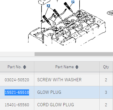

Assuming the glow plugs aren't good, I assume I need 3pcs part number 15521-65510. Do I need to go OEM here too?

Current part number is 15521-65512 which crosses to NGK Y106V - roughly $10 each and available from a gadzillion sources. Messicks wants $15 each.

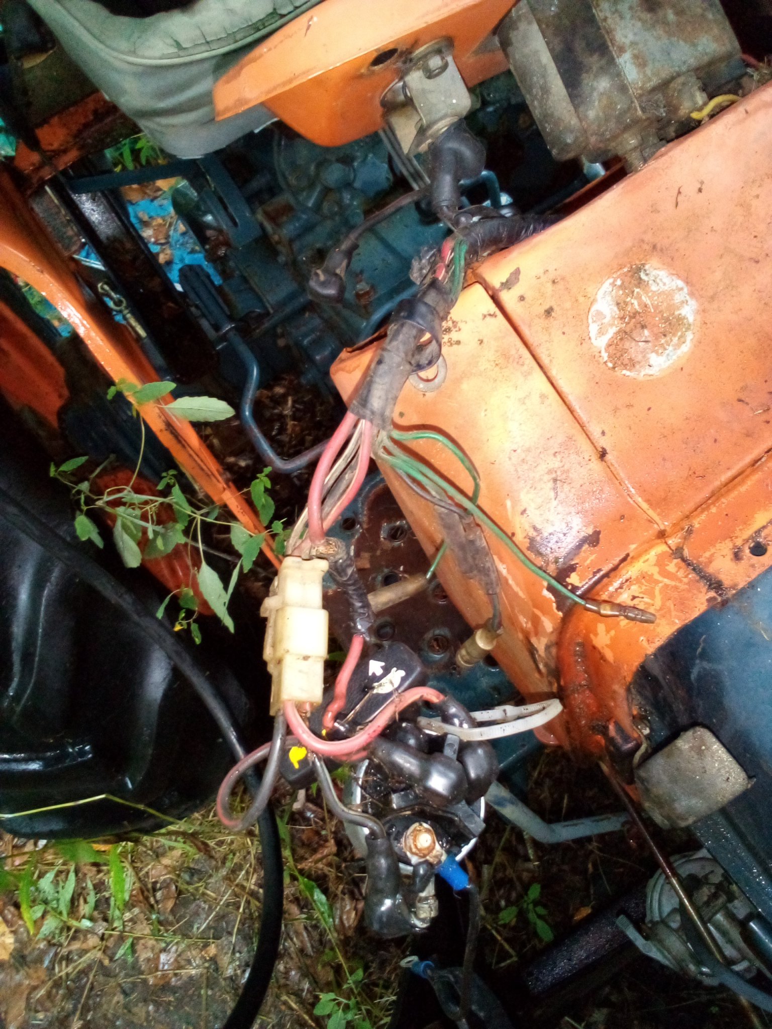

As for the ignition, here's a better, but still bad, picture. As you can see, the lower terminal of the glow plug indicator leads to nothing, where is that supposed to go? Is it worth troubleshooting this or should I get a new wiring harness?

Am I missing something simple? Even though it appears the wiring is faulty, do I need the key in a certain position? Does the clutch need to be in? Does the throttle need to be engaged?

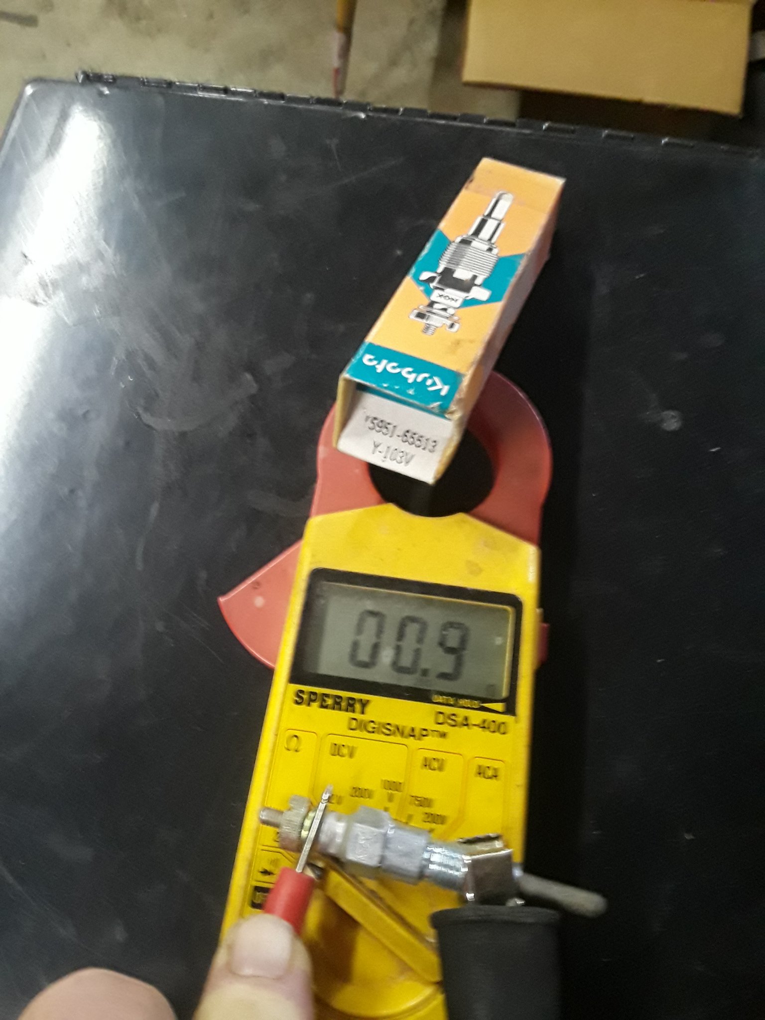

You are pretty damn close. A brand new NGK Y103V straight out of the Kubota box measures .9 ohms. I will leave the power calculation to you :rolleyes:

Assuming the 0.9Ohm is all GP (and not including meter leads) and you have (let's say) 10v at the GP due to the voltage drop at the dash mounted GP indicator wire made of (nichrome?) or whatever, you'll get:
I=E/R...I=10/0.9=11.111A
P=I(squared)R.....11.111(squared) * 0.9......111.1watts.
Ouchie, hot hot, don't touch. ;-)
Perfect for glow plugs !

Meter reads .2 ohms with leads shorted so if we believe all of that the plug is .7 ohm. I believe the 103 in the NGK part number indicates 10.3V. Using those numbers my arithmetic gets me very close to 150 watts. Nice round number ;)
