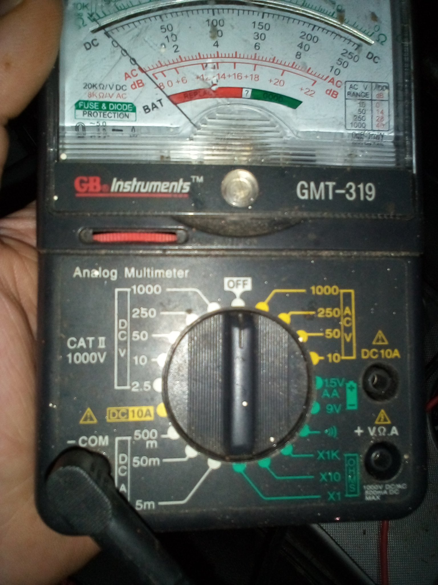

First, I don't think you're talking down to me at all, you're helping and I appreciate it. Thank you for the patience.
Second, I agree it's weird, that's why I said my meter was all over the place. Although I did touch the leads together to verify there was 0 resistance before doing anything. One issue is that I think I was grounding on a scuffed up section of the loader, not the engine, so maybe the proximity caused a problem?
This is my multimeter, looks like the pic cut off the top but you know what it looks like anyway. I had it set to X1. The tone I was referring to is the continuity buzzer. According to the manual, "Buzzer sounds at less than 100 ohms"
Oooooh- Analog -OK then. The directions change slightly.
OK, so next time you're using it, just put your meter on the very bottom setting (the green X1) and don't use the ))) setting a few above it. (that's for beeper and presumably the needle moves too....don't use it for fine measurements like you're doing.
When you touch your meter leads together, you'll be able to use the red "volume control"(upper left in your pic) to "zero" the meter, so then you can ignore everything I said about adding/subtracting the resistance of the leads. SOmetimes analog is just better at certain stuff.
I had no idea we were dealing with analog. If you can't get it to zero, you've either:
-blown a fuse
-toasted your meter
-low battery
-high resistance in your leads.
(It's usually the battery in these guys if you can't quite get the needle to go all the way over to the right (zero Ohms)
You'll want your black lead where you have it and your red in the V/Ohm/A banana plug socket. (lower right in your pic)
If your GP is good, you'll see the needle BARELY move left to the first or maybe second tick mark on your green scale. Looks like the first major mark is 10 (on the X1 scale, that would be 10 Ohms)

OK the meter is definitely good, I have the leads in the right spot and it goes straight to 0 (even further right, actually) when I touch the leads together. The needle was going somewhere in the middle of the range (50Ohms) when I tested the plugs, but I don't doubt there was some level of user error, either in where I had the setting or where I was putting the leads.
