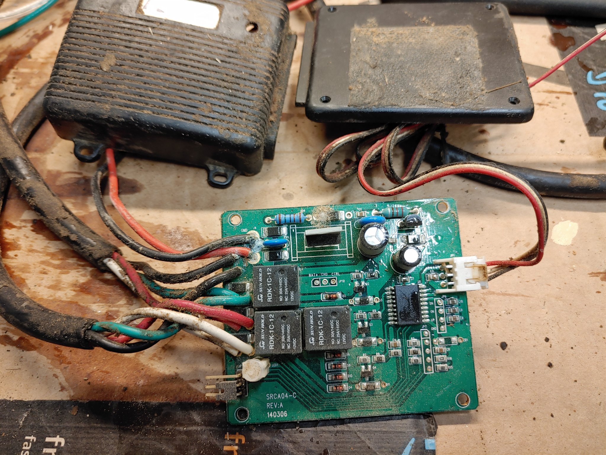

My suspicion would be burned contacts on the relay in the receiver for the down output. If they are higher resistance the reduced voltage they are passing may be enough to activate the pump motor contactor but not the down solenoid.
A simple test would be to swap the up and down wires from the receiver and test if you then have the problem going up (with the down button). The relay in the receiver could be replaced if you are handy with a soldering iron, otherwise you probably need a new receiver.

The KTI wireless remote receiver I have which is likely the same as the OP has definitely contains three relays. I haven't confirmed the wiring, probably one is enable and the other two up and down, or perhaps one is not used in this application.

One for motor power
One for up solenoid
One for down solenoid
wow , that's mighty dirty and corroded !
Checked and that is correct. Yes, the battery/pump/storage box at the front of the trailer isn't the most pristine environment.
When the battery gets low and the pump and stuff starts to chatter, stop, that is when most of the relay contact damage will be done.

Had a look at that PCB again and reverse engineered it. Two possible ways the relays are configured, one way requires a 'form c' relay, other way you could use a 'form a' relay , cheaper, or just a FET,even cheaper.
While you're making a new an improved version be sure to properly automotive harden it with an appropriate IP rating and surge suppression. Longer RF range would help also, at the back of a crew cab long bed the RF range of the KTI unit is sometimes marginal.
