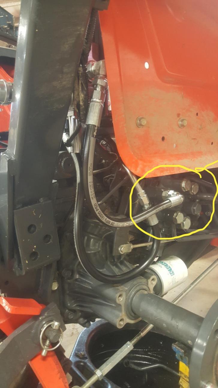

In the picture inside the yellow circle is the fitting I'm referring to... In stock configuration, there is a steel line coming out of this port up to the supply side of the 3 point. The guys at my Kubota dealership could not find any configuration, backhoe, aux hydraulics etc, that had an adapter that screws into this port.
I did get the line that will connect to the PB side of the valve to supply the 3pt with fluid....

I think I found it....
ASSY ADAPTER ASSY ADAPTOR 1 75580-61800
Both the fittings are part of the Aux Hydraulics option.

Yes, I beleive you are correct that both pieces came in the kit. In the yellow circle is the adapter to the loader valve, and when I had hose made up, I had a 90 put on that end to screw on to the adapter. Good luck on your project.

Ive discovered that the "assembly adapter" part number 75580-61800 is a SAE 8 to JIC fitting. I don't know the size of the JIC end of the fitting, but what it does mean is that a SAE 8 to pipe thread fitting can be used instead of the Kubota specific "assembly adapter" So Ive ordered a 90 that is SAE 8 on one and and 3/8 Female Pipe Swivel on the other. This will go into the valve body on the tractor and supply fluid to the new valve.
I haven't determined what size fitting will fit into the 3 point supply. I wont know until I start taking things apart, but if its a SAE 8 thread as well, then that would eliminate the $60 fitting needed to route fluid from the PB port on the valve to the 3 point supply. I have a SAE 8 x 3/8 female pipe thread 90 in the mix with the rest of my fittings in anticipation of it fitting. There isnt a lot of room to spin in a fitting there and this looks to be just unobtrusive enough to spin down in. Then thread in a 3/8 male thread x 3/8 female swivel for hose attachment.
