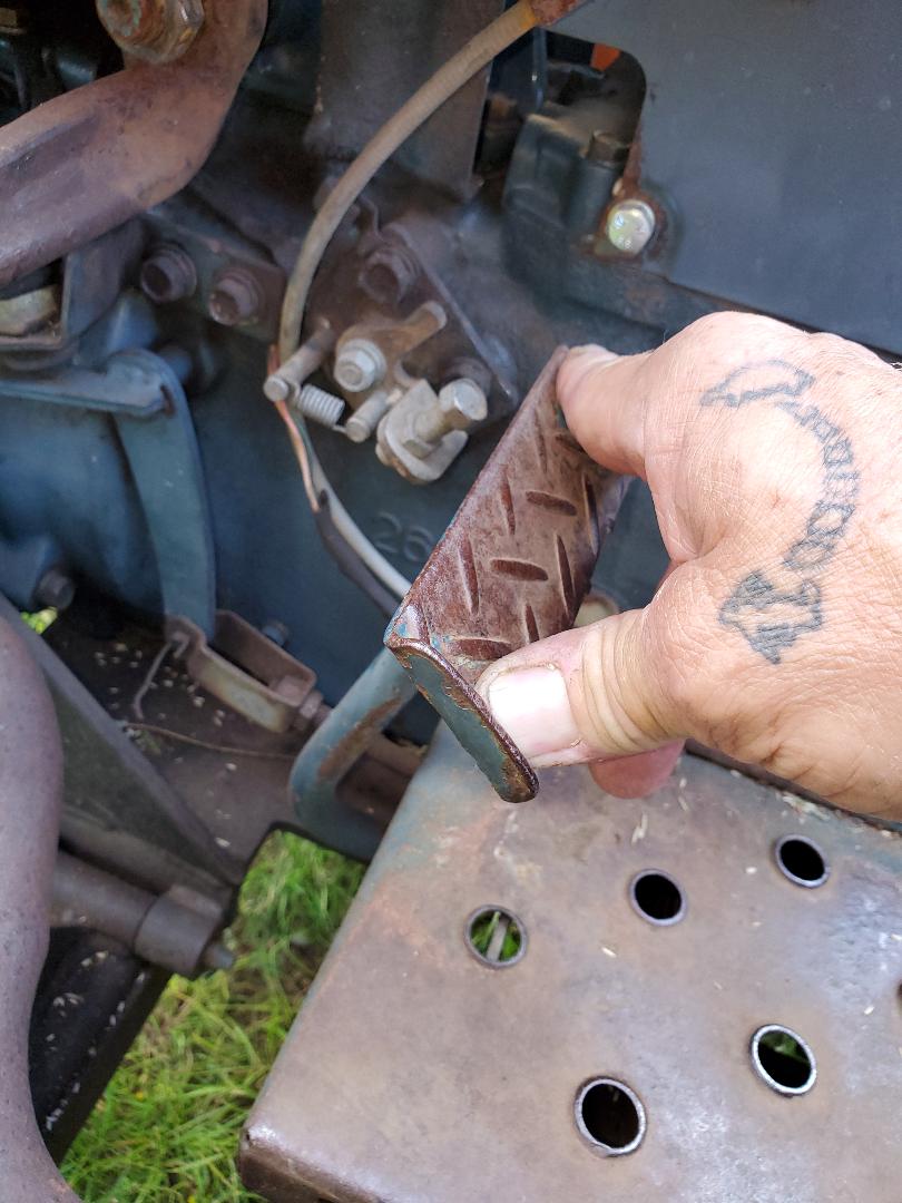

Yes, I see the lever and it has been in the flipped up position. When I depress the pedal I can feel a noticeable change in resistance once I get past the point of PTO disengagement...but it doesn't release.
