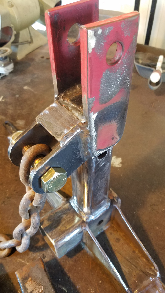

Fortunately, the last link on the old chain that I found will easily accept a 3/4" pin or bolt so that end is done already. Now I need to figure out a way to incorporate a bracket that attaches to the draw bar with a pin that includes a plate with a notch in the best location to allow for different lengths of the chain.
Here are some photos that give a better idea of what I'm working with along with the growing scrap pile.

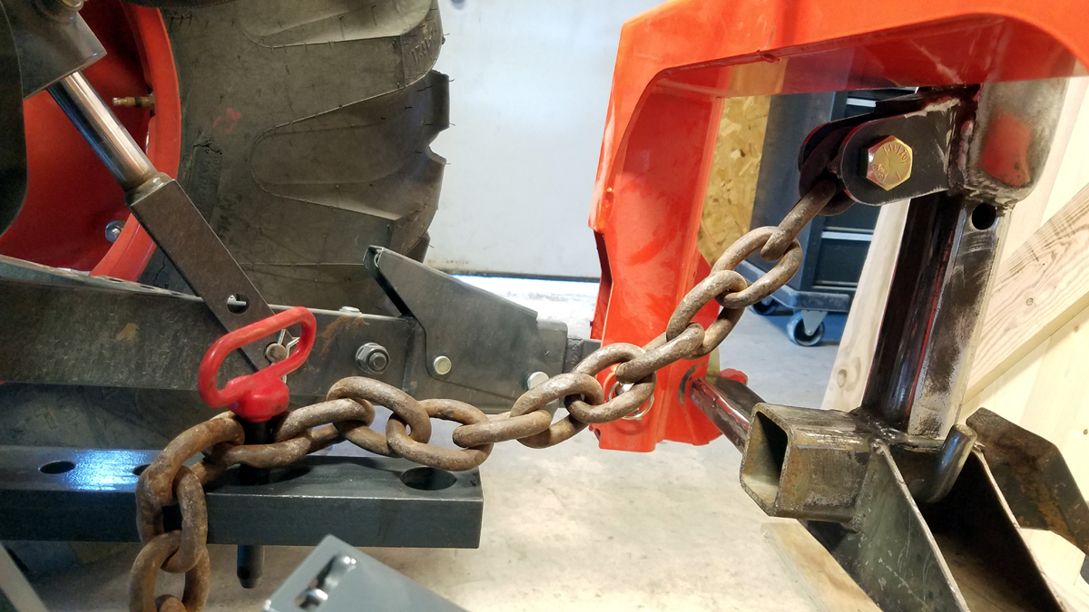

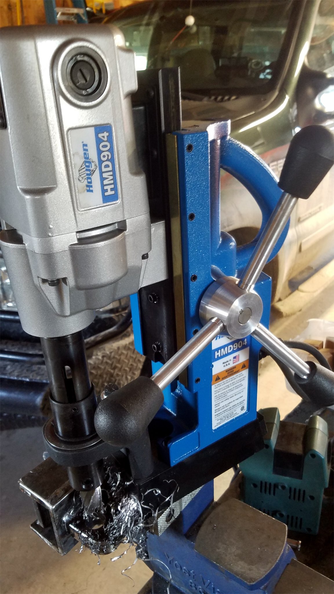

@bmblank, I have a bit of an update on this project based largely on your suggestion. I bought a Hougen magnetic drill a few months ago and used it this morning to open up the hole in the eye on the bracket that slides over the draw bar so that a 3/4" shackle pin would fit.
I used this set up this morning to move the flatbed trailer and it worked well. I'll probably cut the chain back a bit then weld it to a piece of plate with a hole that the pin on the receiver will slide through. That way the hook will pass through the shackle and then snag an appropriate link. Also, I might re-purpose the cut receiver below by cutting off unwanted material and welding it to the receiver on the quick hitch so that I can store either the 2" or 2-5/16" ball that's not being used.
Opening up the hole to 3/4"
Receiver lowered to get under the coupler and the chain relaxes
Lifting up the receiver and the chain limits the upward movement of the 3-point

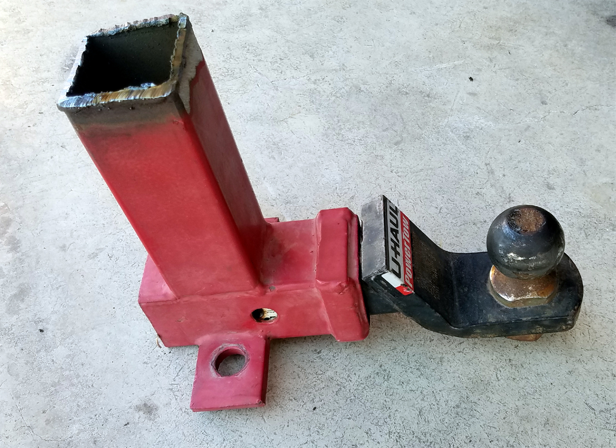

Part of original receiver from BX25D

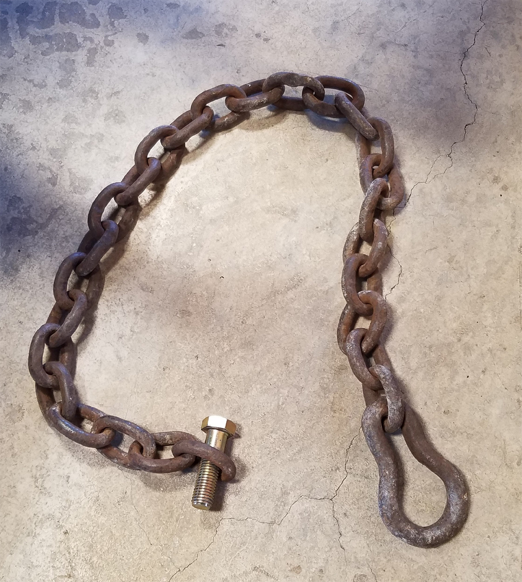

That odd shaped loop on the end of your chain (in post #41) is used to adjust the length.
Rotate it 180 degrees from the position in the photo, then it will grab a chain that goes through the loop
Bruce.
5,607
6,803
NW Montana
Bruce.
Thanks, but I've decided to make an "eye" in a piece of plate for the chain to pass through and weld it to the receiver to eliminate the pin I'm currently using. I'll have to weld the other end of the chain to the bracket that slides over the draw bar. This has been a poorly planned project from the get go but eventually I'll get it right. :(

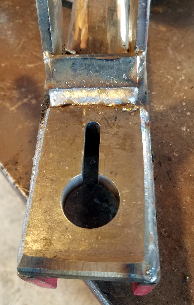

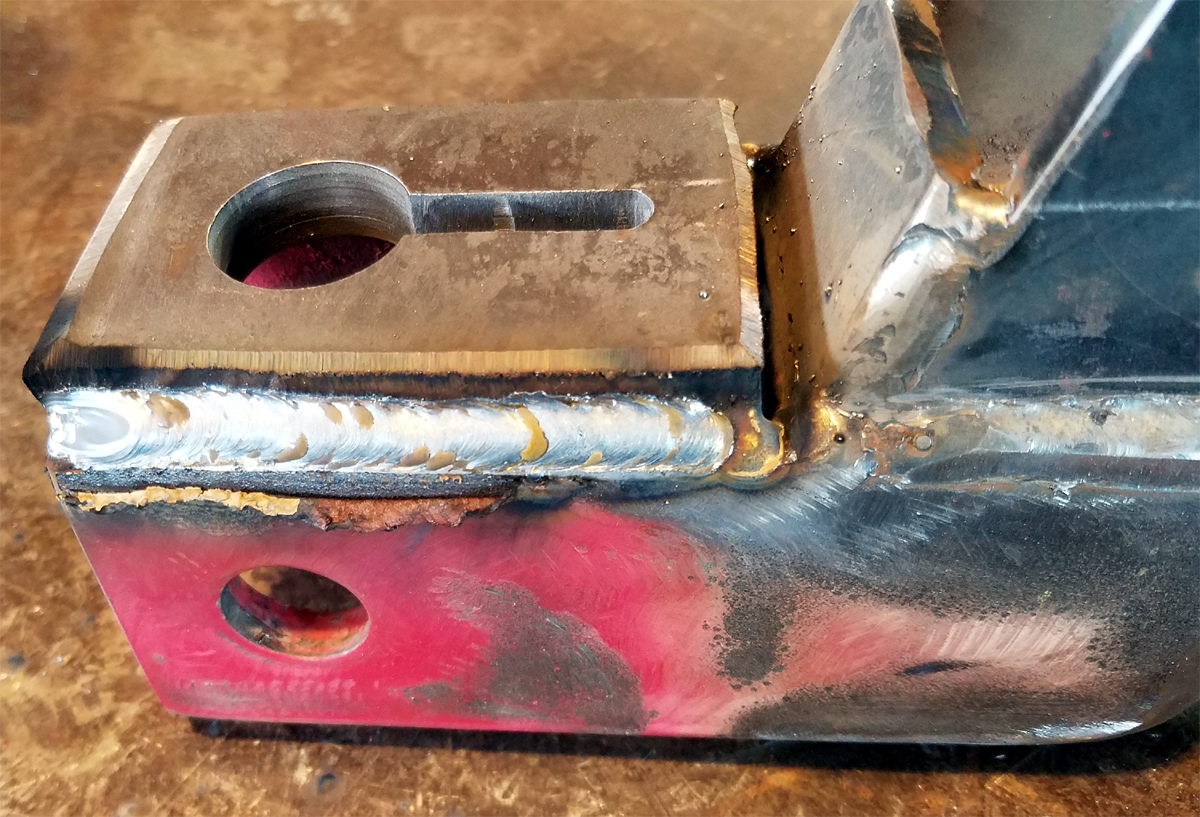

I've lost count of what revision I'm on but I made a nice chain link key slot today for want of a better description using some scrap 1/2" plate. I then welded it into position only to realize that I'd welded it in the wrong spot. :mad: Time to fire up the plasma cutter again!
