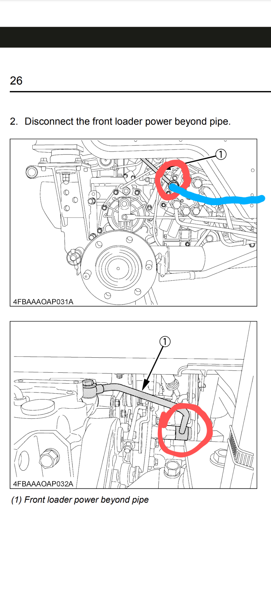

Here is my issue:
That hydraulic line is supposed to connect from the power beyond to what appears to be the rear axle/differential assembly. The area I've circled in red is where one of my BH77 hard lines are supposed to be installed along with the hose that "closes the loop". Unfortunately, the existing hard line on the tractor does not mount to the power beyond at all, it mounts to a hose that is leading towards the front of the tractor (I'm assuming for the loader or third function). If I do install the BH77 hydraulic lines, I am not sure where to connect the remaining hose to.
These are the two lines I need to install:
Nowhere in this diagram do they provide insight on how to install if you have a third function or rear remotes which appears to have changed my layout a bit. Any advice or guidance would be appreciated. I can take some better photos over the weekend after I pick up the BH77 and take the loaded tire off and put a jackstand under the right axle.

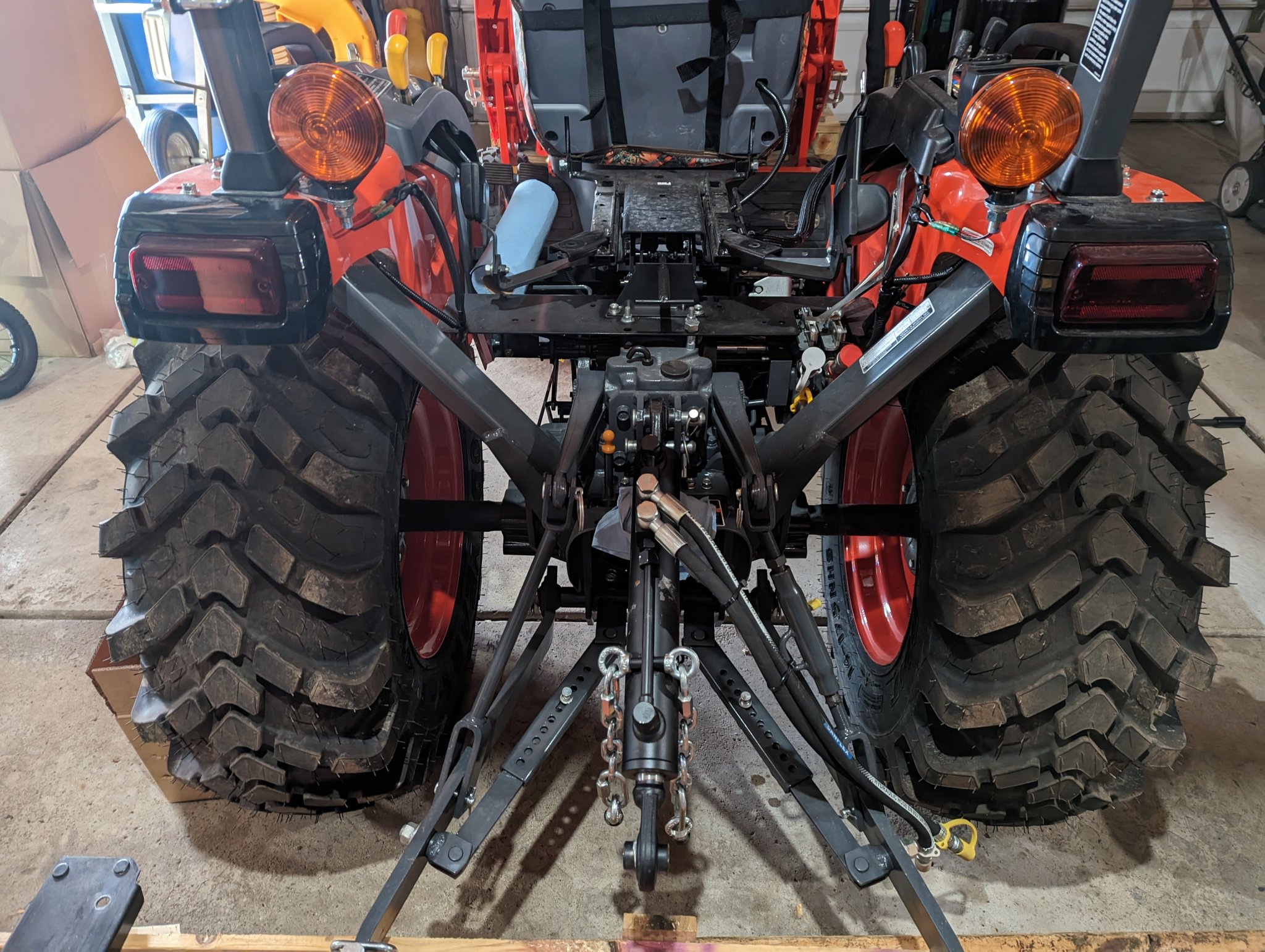

Here's where I am so far with the install/prep:

Here is my issue:

Appears to be that way, I've attached a picture of my set up below.

Here's my set up:
So my line from the 3pt or top of the rear axle housing where the backhoe outlet pipe is supposed to be appears to feed the 3rd function valve and where the backhoe inlet valve is supposed to be on the power beyond also appears to feed the 3rd function valve.
1. Can I relocate the 3rd Function/loader hose to power beyond line from the current power beyond port to a different port? The BH line appears to need to use the port where this one is to mount to the subframe bracket.
2. My backhoe outlet pipe goes straight to the back of the tractor, where would I install the 3rd function/loader hose that will be disconnected? On the power beyond as well?

I spent a little more time trying to parse that description.
It sounds like you have a hose/pipe connecting the losder PB to 3rd function. That makes sense and supplies pressure to the 3rd function valve.
You have another hose/pipe connecting the third function valve to the top of the transmission. That also makes sense and is the PB pressure supply FROM the third function TO the 3pt. This is the hose that should be disconnected and hooked to the BH inlet pipe.
The BH outlet pipe would then go to the top of the transmission as shown in the installation manual.
Pressure supply circuit looks like this:
Pump -> remotes -> loader -> 3rd function -> BH -> 3pt

I looked at the manual for the LA535 and the bastards listed the nuance for BH77/3rd function kit in there and not in the BH77 manual. Apparently I need a different inlet pipe assembly that doesn't connect to the power beyond but instead connects to the 3rd function to 3pt hose.
So long story short, the BH77 outlet pipe fits to the 3pt on the trans, the BH77 inlet pipe needs to be scrapped and a new BH77 to 3rd function pipe (they call it a "power beyond pipe" in the manual) needs to be ordered to allow the 3rd function to remain hooked up to the power beyond.
Am I thinking about this correctly? I'll post the part number here if anyone is interested.
View attachment 100781 View attachment 100783

So if anyone is interested, I found the parts needed to install the BH77 on the LX2610 IF you have a 3rd function (#10 on the diagram):
7J056-84240 - power beyond pipe (backhoe inlet to 3rd function hose)
75580-61800 - fitting NPT to JNC between the pipe and hose
Two nuts and bolts (I can add the p/n later)
Parts will arrive Tue... Sadly I will not have the BH installed this weekend but I'll try to get the subframes mounted at least and get the wheels off and put the back end on stands.
