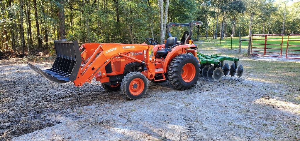

Finally got to play with it for a couple hours today and really test it out. I decided to go as aggressive as possible on the gangs just to see what the worst case scenario would be, and I started in 2wd. I made it about 5 feet and one of the rear tires began to spin. backed up and tried at a different angle, still rear tire spin down. I went to 4wd and had no issues again. I can feel the tractor actually working now however, with the gangs at their most aggressive angles. I tilled the area over and over until it was very loose and deep. The tractor continued to pull the harrow in these conditions at the most aggressive angles. As long as 4wd is engaged the tractor can handle it. If I take it to 2wd one of the tires will eventually spin, so its a complete no go in 2wd at these aggressive angles. I never spun down or had any issue in 4wd however. I dont think I will be using this harrow at this most aggressive angle very much, its just really aggressive. I backed off to about the mid point on the gangs, and I like how it performs there, and wont put as much strain on the tractor. I was glad to see that the tractor will put it at its most aggressive and in some well tilled dirt. Ive turned the area to near powder at this point having made so many runs over it while testing. Im really impressed. This harrow is going to work out perfectly. Build Quality is excellent as well. It will last me for many many years I think.
The only problem is that its GREEN! So an orange tractor with a big green harrow. What a contradiction. Im sure Ill be getting lots of comments.

Thought I would share 3 pics of the set up for anyone curious. If you look at picture 1 you can see how little clearance I have when the harrow is lifted to maximum.

Looks good ! It looks like you may be able to move the gangs toward the center which would improve the cut in the center of the disk. The back looks to be wide in the pictures.
