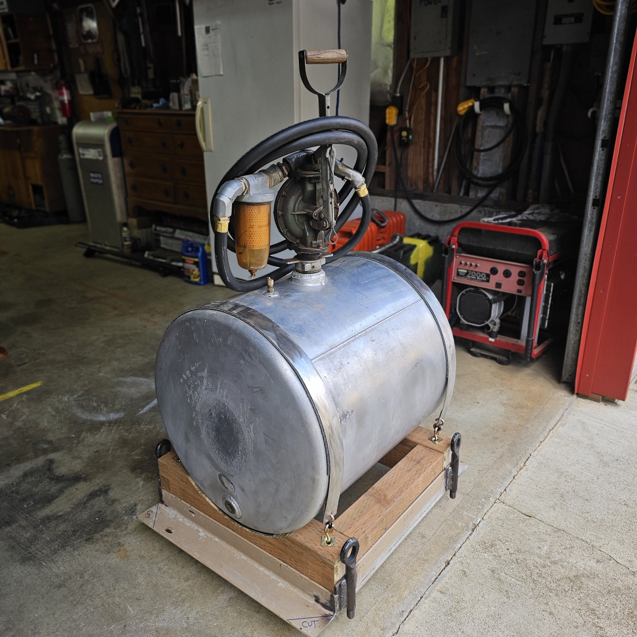

The inside got degreased and the straps are done. The next phase will be making the dollie/lifting base. (I cut corners due to costs)

It should work OK. The tank is finally on wheels and ready for fuel. The lifting frame is my hold up now.

Since I got a bunch of angle iron and the eyebolts, I decided to get more done on my transfer tank. I built a lifting cradle. The eye-bolts really pulled my project together. I'll lag bolt the cradle to the timbers, and 45° cut the metal corners so no ankles get zapped.
I need to have my filler bung added too.

I did consider GF. The problem is it would need to be stationary, and a solid stand. I don't have the space. I know my transfer tank is more elaborate than what's necessary. I like to keep my mental juices flowing. If my creation doesn't fit the bill, I'll rethink things and go at things another way.

Today I loaded the tank onto my trailer, and took it to the weld shop. I'm having a filler neck added. Once that's done, it's ready for use. (y)

Fresh Paint

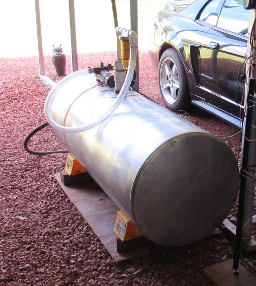

I have a 100 gallon aluminum tank from a Freightliner I bought from a salvage yard for $130. I use a 12V transfer pump powered off a deep cycle battery that remains charged by a solar panel on the roof of my barn. I added a mechanical gauge, shutoff nozzle, and water block filter. I'm all in around $300 not counting my solar setup. I have fuel delivered most of the time. I treat with Biobor JF for algae and lubricity. Haven't had any problems.

I like it. Are those wheel chocks?
Clearing land is what's making me jealous of your tank solutions. Not in the cards for me at the moment though.
Greg
Yes, those are wheel chocks screwed down on pieces of landscape timbers on a piece of pressure treated plywood. The barn floor is a 4" thick layer of crushed red brick.

A little paint for the cradle.
