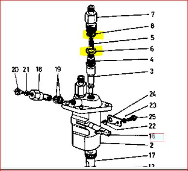

Hey there, I'm hoping you all can clear up a little confusion on my part.
I got the pieces in the mail today along with the diagram they were kind enough to send.
When I removed the fitting I could immediately tell that there were no O rings installed on the fitting. The diagram shows there are supposed to be some there. They are # 7 in the diagram.
I did not replace the washers (#8) as I didn't think they were sealing anything. Plus I could not exactly tell how to get to them.
I put the O rings in the location were they are shown in the diagram and started to tighten the fitting down some and could tell that it was not going to seal. The O ring isn't wide/thick enough to cover the gap left in between the fitting and the housing.
As expected, it still leaked when I started the tractor up.
Should I have installed the washers? Will they get anything sealed or is that just the O ring?
Anything somebody sees that maybe I missed?
Any help is greatly appreciated!!! Thank you !!!

That O ring has to get compressed under the nut against the wall of the cylinder.....it looks too big or the nut needs to be tightened more?

Hokie- It appears that the nut either needs to be tightened further or the o ring should be wider. The nut is torqued to spec and I don't think it could get any tighter. It may be the size of the o ring that isn't correct.

First you need to pull the pump plungers out and remove the old O-ring.
The chances of it not having any originally would be very odd.
Yes you need to replace the washers too as they part of the sealing.

I pulled the valve holders off and pulled the "plunger" out and still did not see any washer or o ring so I called Diesel Equipment. The Bob fella is out for the week so I spoke to somebody else.
We went over the diagram along with some pics that I sent to his phone. He told me that it appears that the diagram may not be correct to how mine is setup. I explained to him that I have not come across and o ring or a washer up to the point that I am at. He said he believes the washer is below where I am at now.
I explained that I have removed the "missile" shaped piece and he says that piece is the top part of #9 on the diagram. He said the part that I am looking at on the right valve assembly is the bottom part of #9. He says he believes that the washer is below #9 and that I need to get that part out to get to the washer. I told him that part seems stuck in there and he says it won't be fun but it's going to take some persuading to get it out.
I asked him why he believes I don't have any o rings on the setup and he said that his best guess is that they are "dust" o rings. To keep the dust out of the threads. He said that the washers will seal the fuel and that the o rings seal out the dirt.
He was very helpful and is supposed to have somebody call me tomorrow who works on these pumps more than him.
I've included some pics that I sent him. Up to the point you see in the pics I have not come across any o ring or any washer.
Not sure what's going on but I hope to find out more tomorrow.
Anybody have any thoughts on this situation? I'd appreciate your opinion/suggestion.

i'm thinkin' that were are looking at a drawing different than the parts you have. That missile looks as if an o ring could go there at the top before the chamfer however

I think the guy you are talking to is a little off, the bottom washer , and o-ring are what seals the fuel.
That O-ring you have on there is too big, it shouldn't go up to the top, it should be the same size as the bottom of the fitting.
You need to pull the pump plunger (#3) out to get to the washer and O-ring.
This is a Picture of the B5100's pump and I do believe that yours is the same style.
