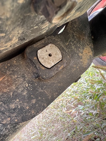

I have the same problem with my BX23s, I found that the inside end of the pivot axle has too much play, allowing it to move up and down inside the bracket. I verified this by placing a metal shim in the gap which stopped the bumping/popping noise. I don't know whether the axle or the bracket is worn.
