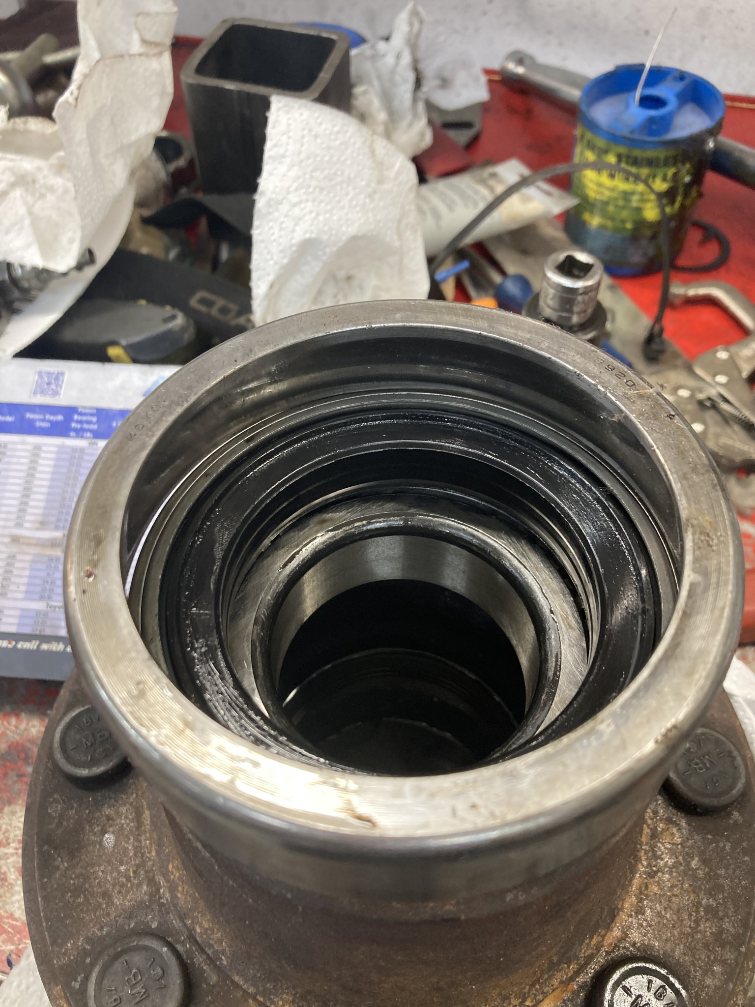

I press in the new races for the axle bearings.

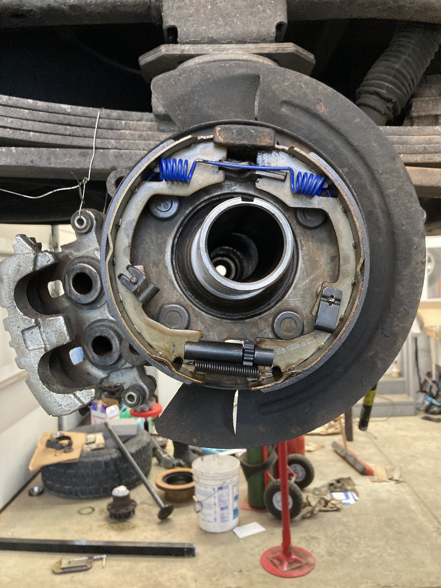

Assemble the parking brakes.....It sure will be nice to have a functioning one again

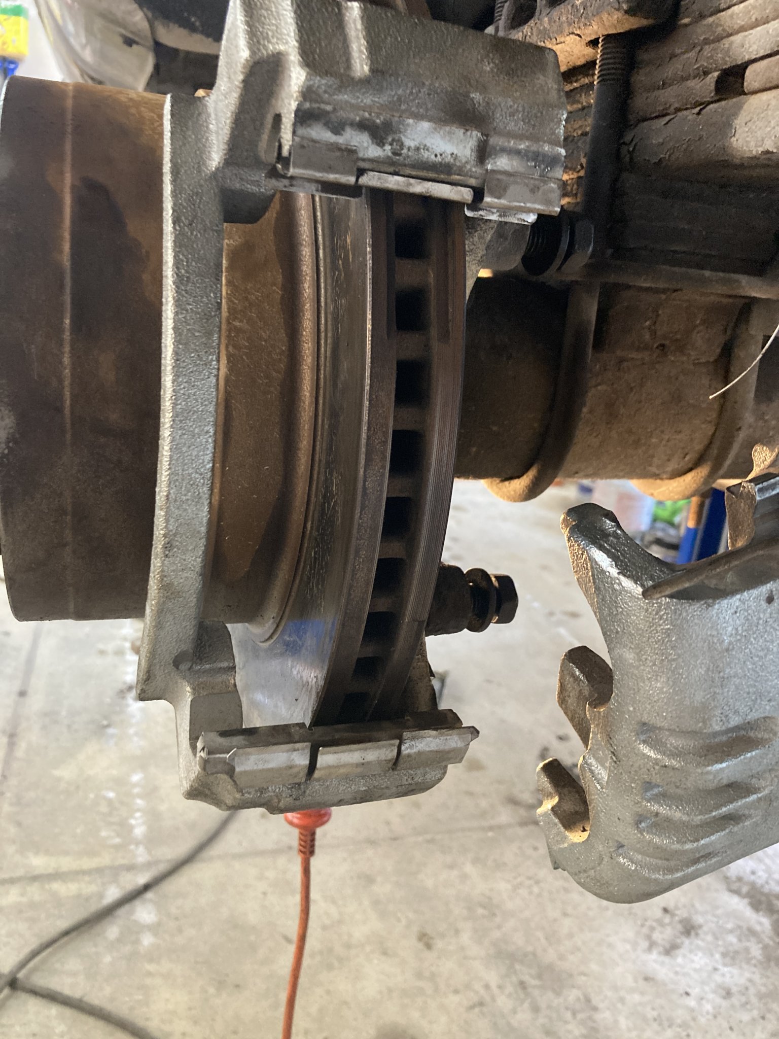

Install the rotors and pads
