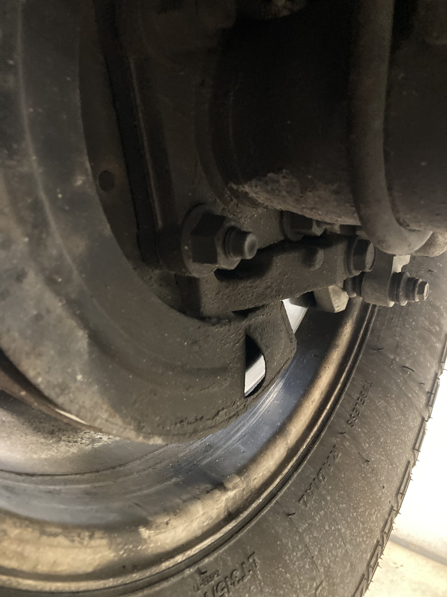

I decide that since it has nearly 300K on it, and 2 really bad rear axle seal leaks, AND a rear pinion seal leak,
Here are some "before pics"
3,292
4,154

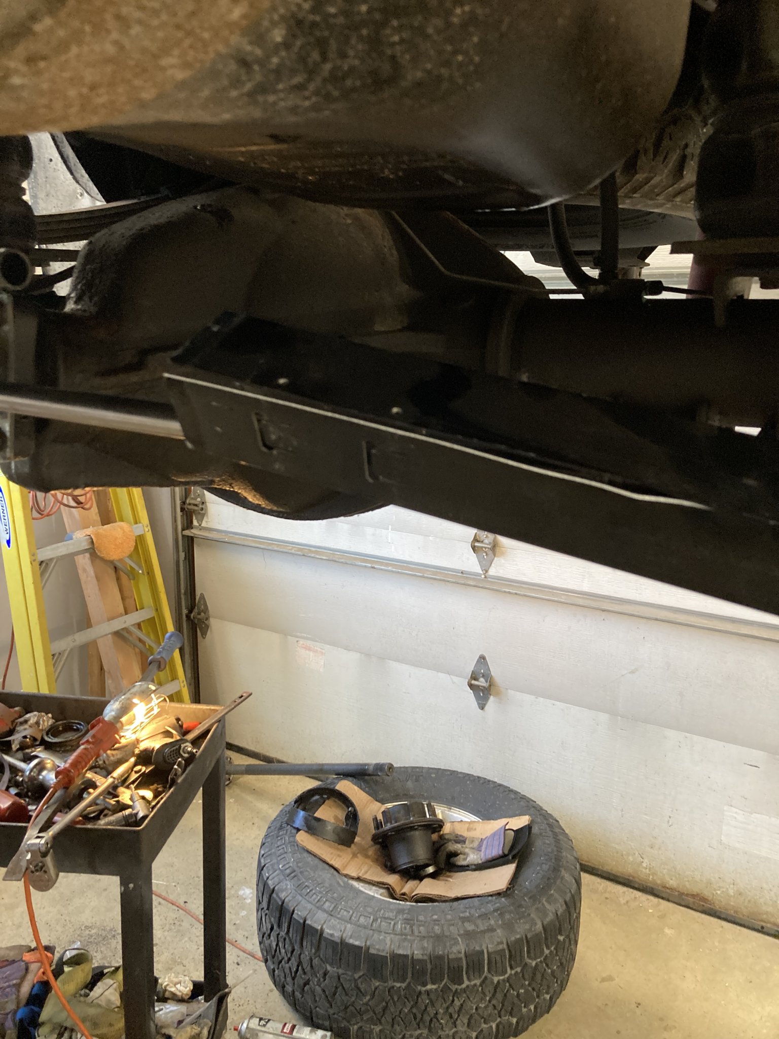

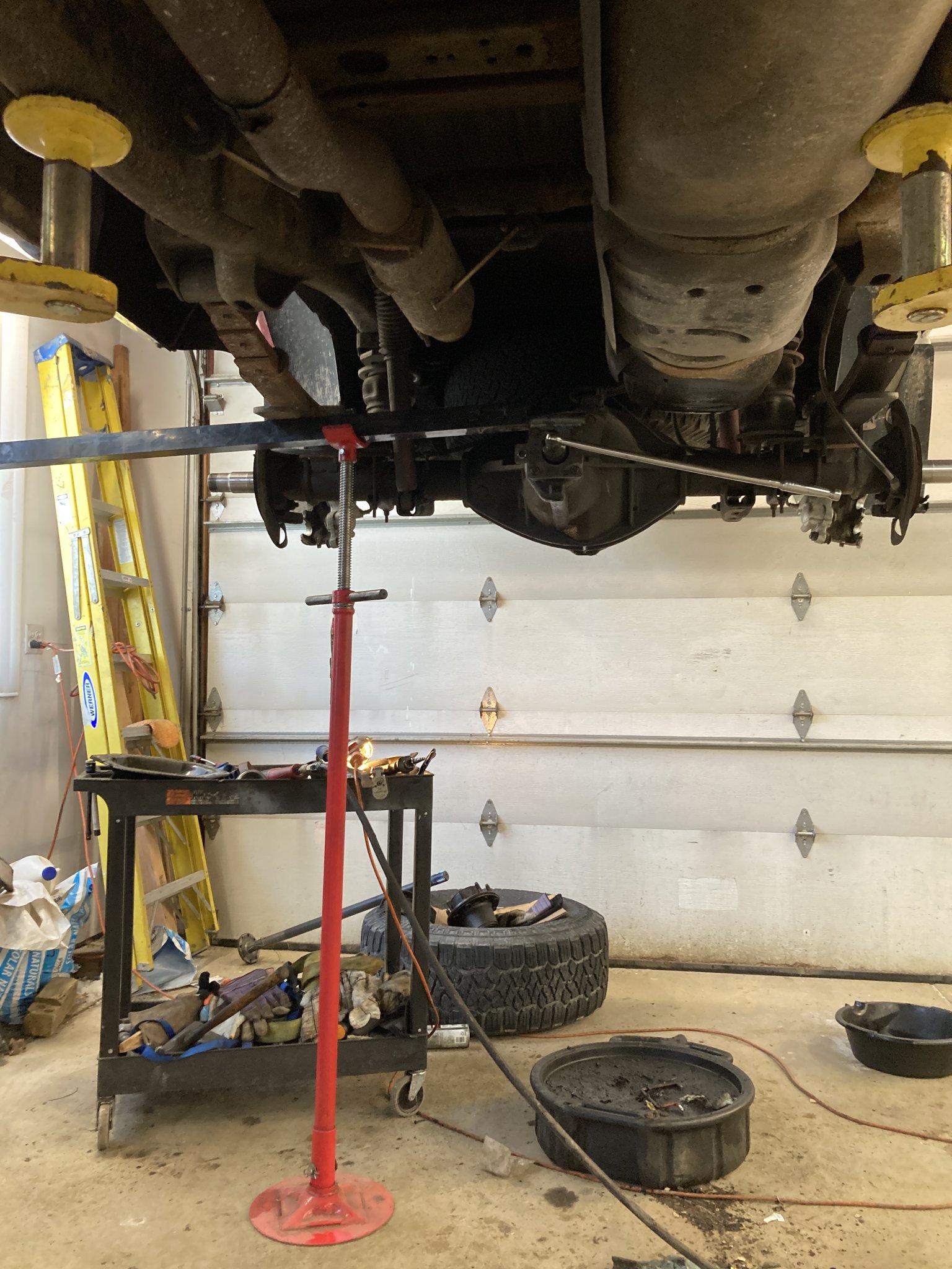

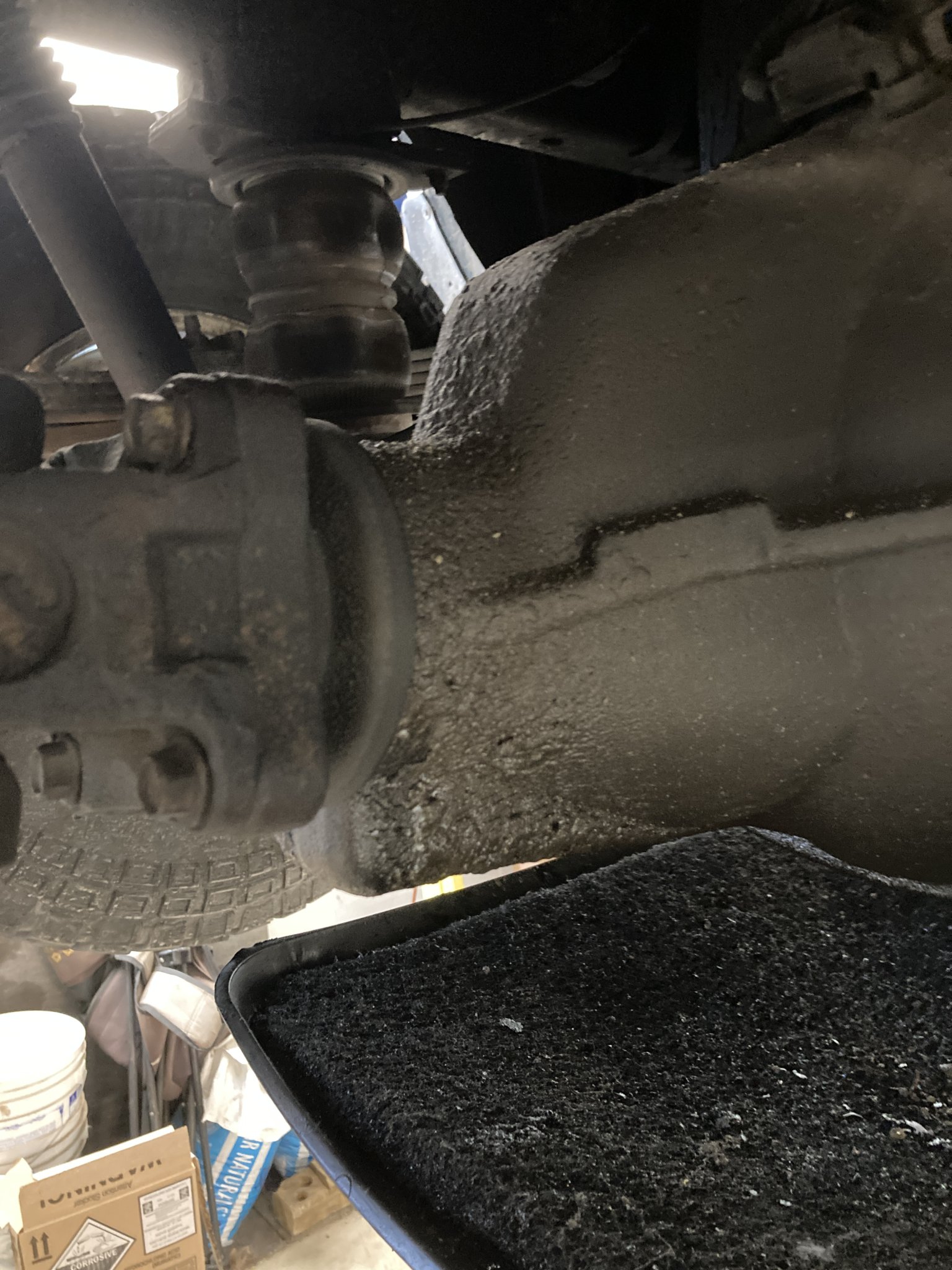

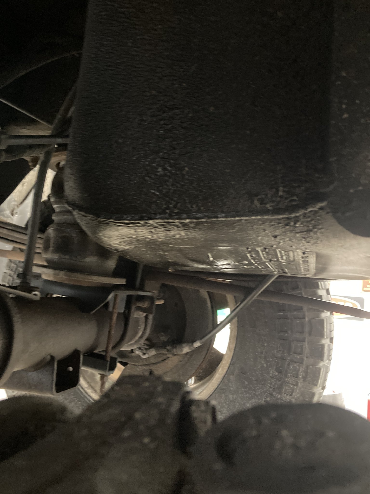

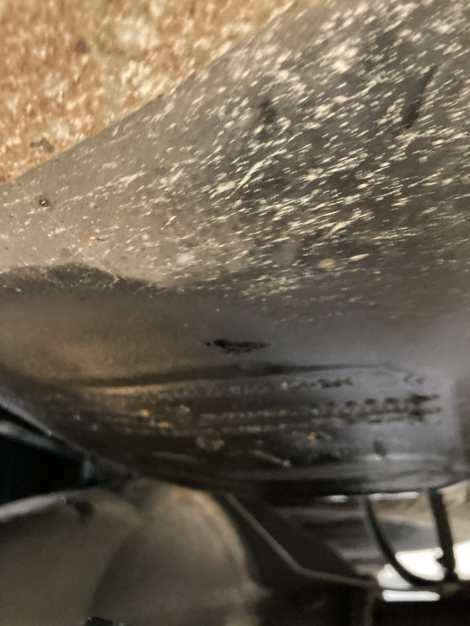

Basically, it’s a “mess” under there……The pics don’t tell the real story though….It’s pretty wet down there, and it finally need to be addressed.
It’s probably time to “Freshen her up” and replace all the bearings and seals at minimum.
I already know that the front has “something” going wrong so, I reason that before I tear into the front, I should do the rear.
Mostly cause I need/want a “victory” before tearing into a “known problem”.
It’s been at least 20 years since I last did an “axle job”, so I kinda want to “refresh my memory” on a “probably good axle”…At least that’s my thinking….
I also want to “spread out” the Visa bill for these repairs over 2 billing cycles……..

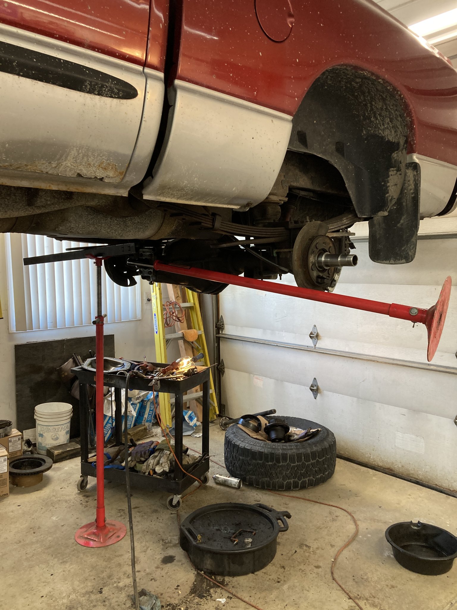

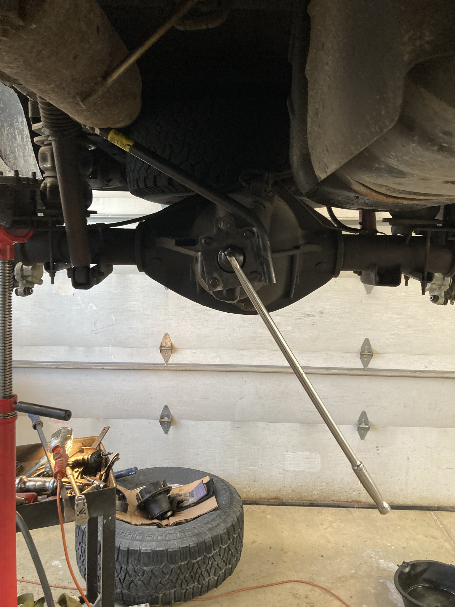

So I break out the impacts, and start tearing her apart.
I have not “thought about it” in a long while, However; it turns out that, back then, when you “checked the Diesel box' on the order form, it automagically came with the BIG 1 ton axle, the 11.5 AAM.....Even on the 2500's......
It may not look like it from the pics, but that's one heavy MF'r........At least it is now for my old broken down ass........(Man I must'a been a strong SOB back in the day, I don't remember them being nearly this heavy....)
One thing I did like about the AAM axles were the use of those "adjustable carrier bearing adjusters" Vs. using shims..........(But there are caveats to this, as we will find out soon.........)

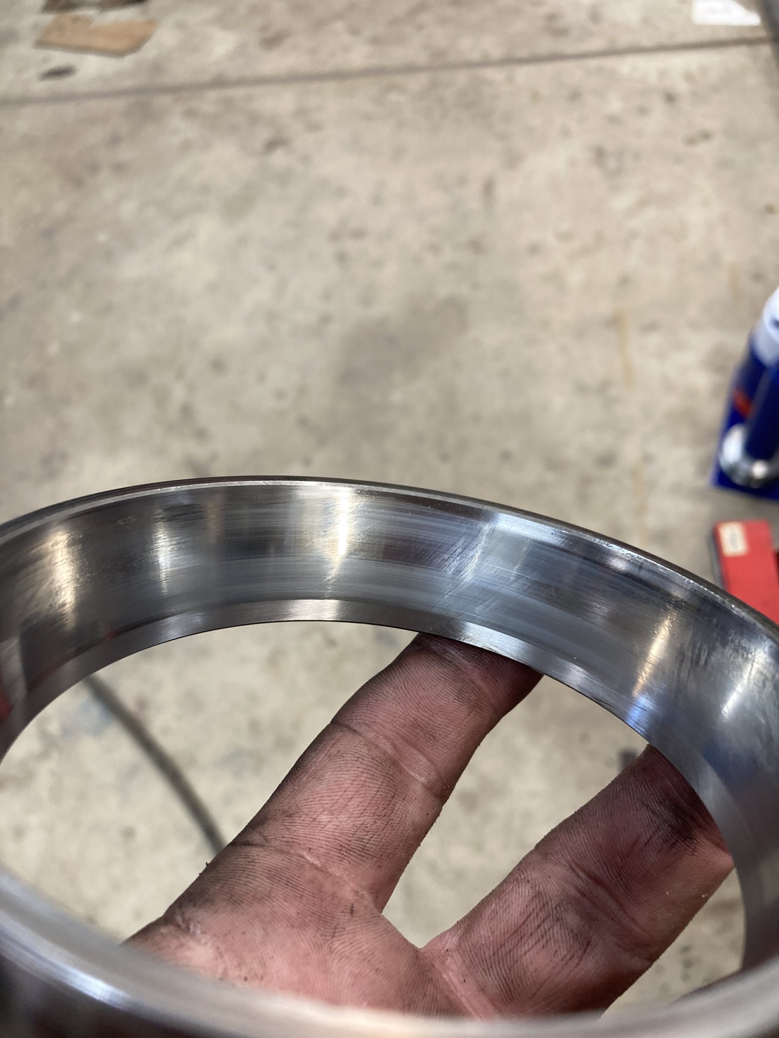

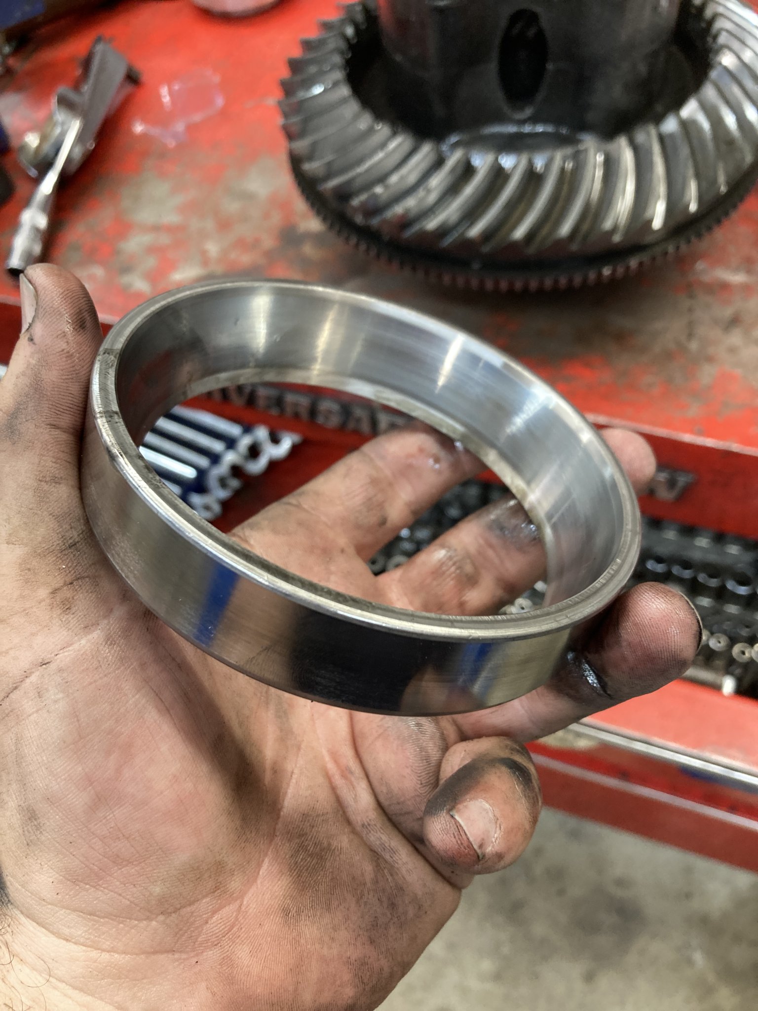

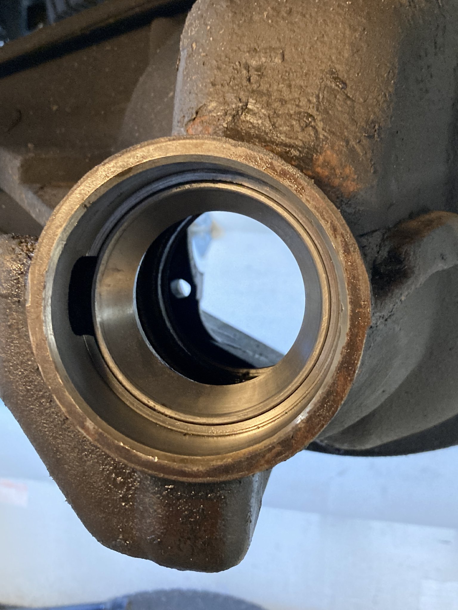

Ok, well now I inspect the races.
All in all,
Every thing looks good really…..I am pleasantly surprised.

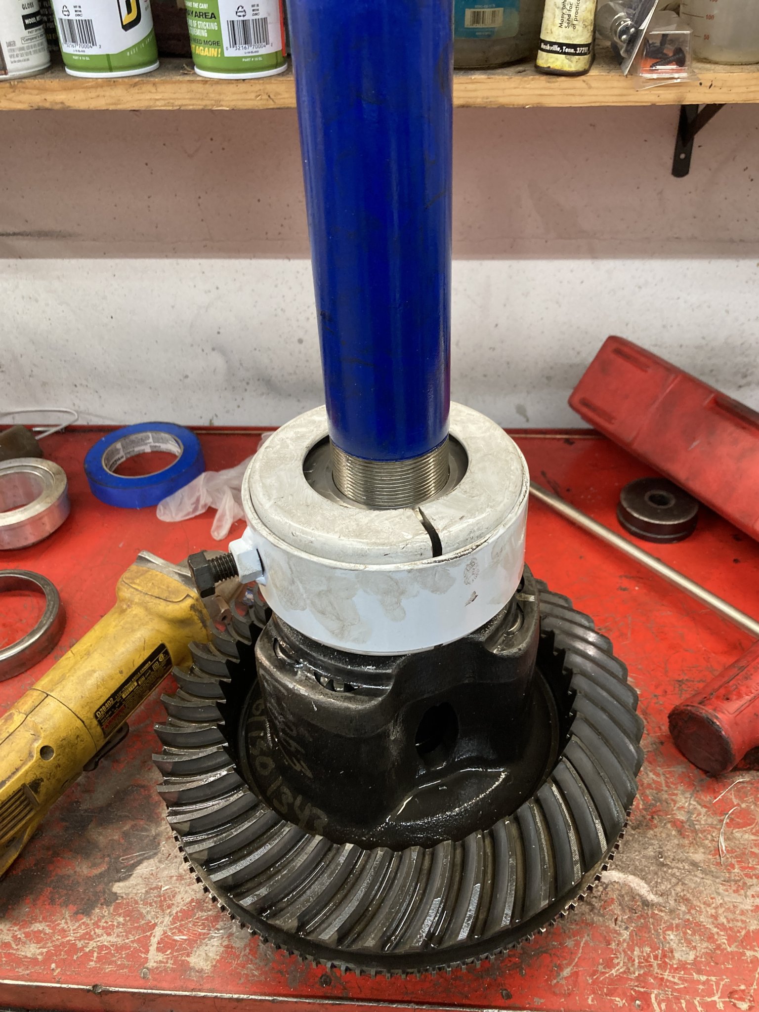

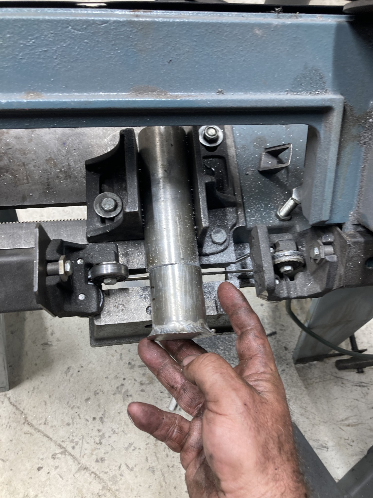

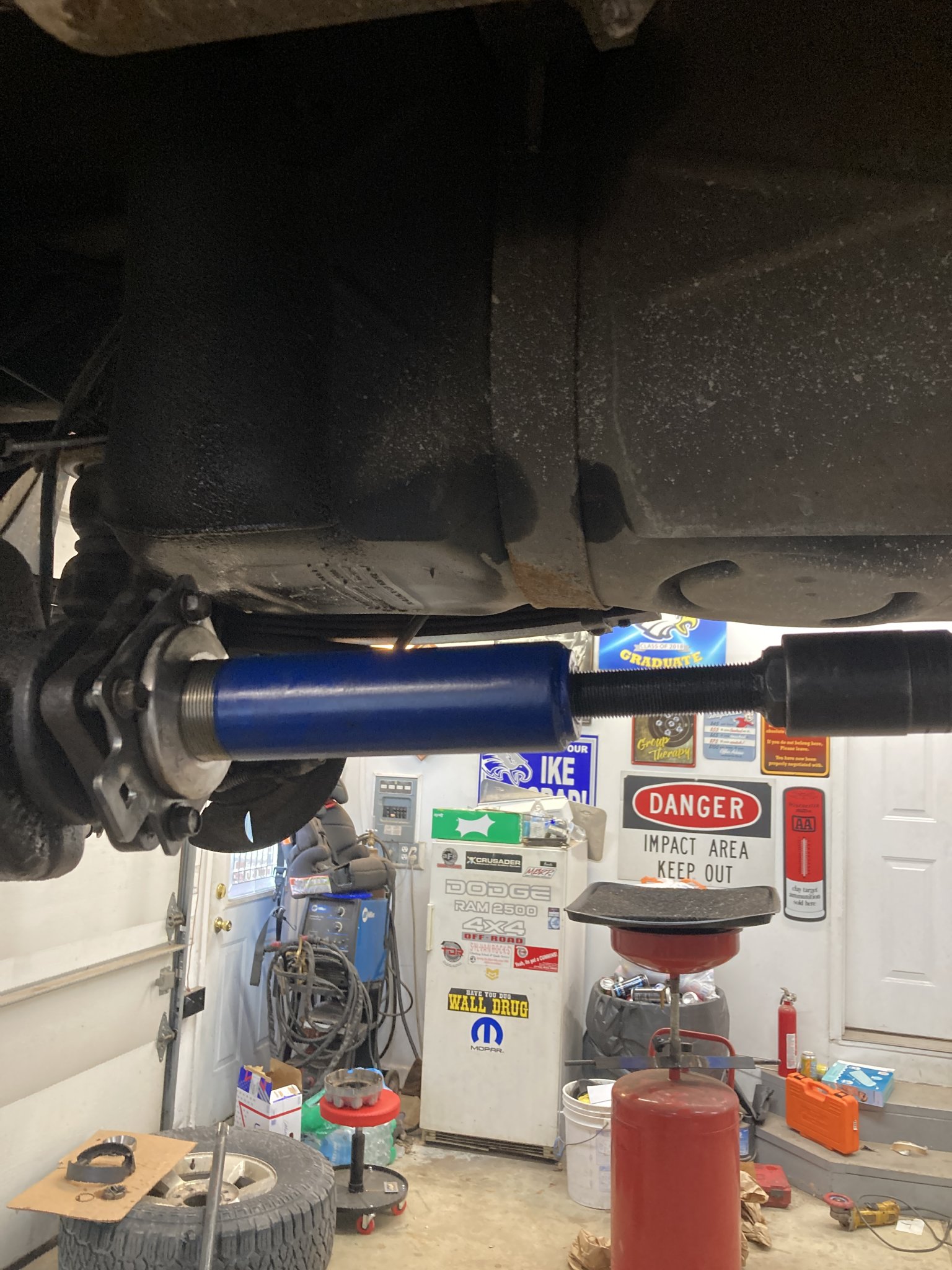

I grab the "bearing puller" that was supposed to fit an 11.5 AAM.....And while it does "technically" kinda fit. I need to do some mods to help it work.
So some "judicious usage" of the grinder and a few minutes later, BAM.....She fits nice and snug now

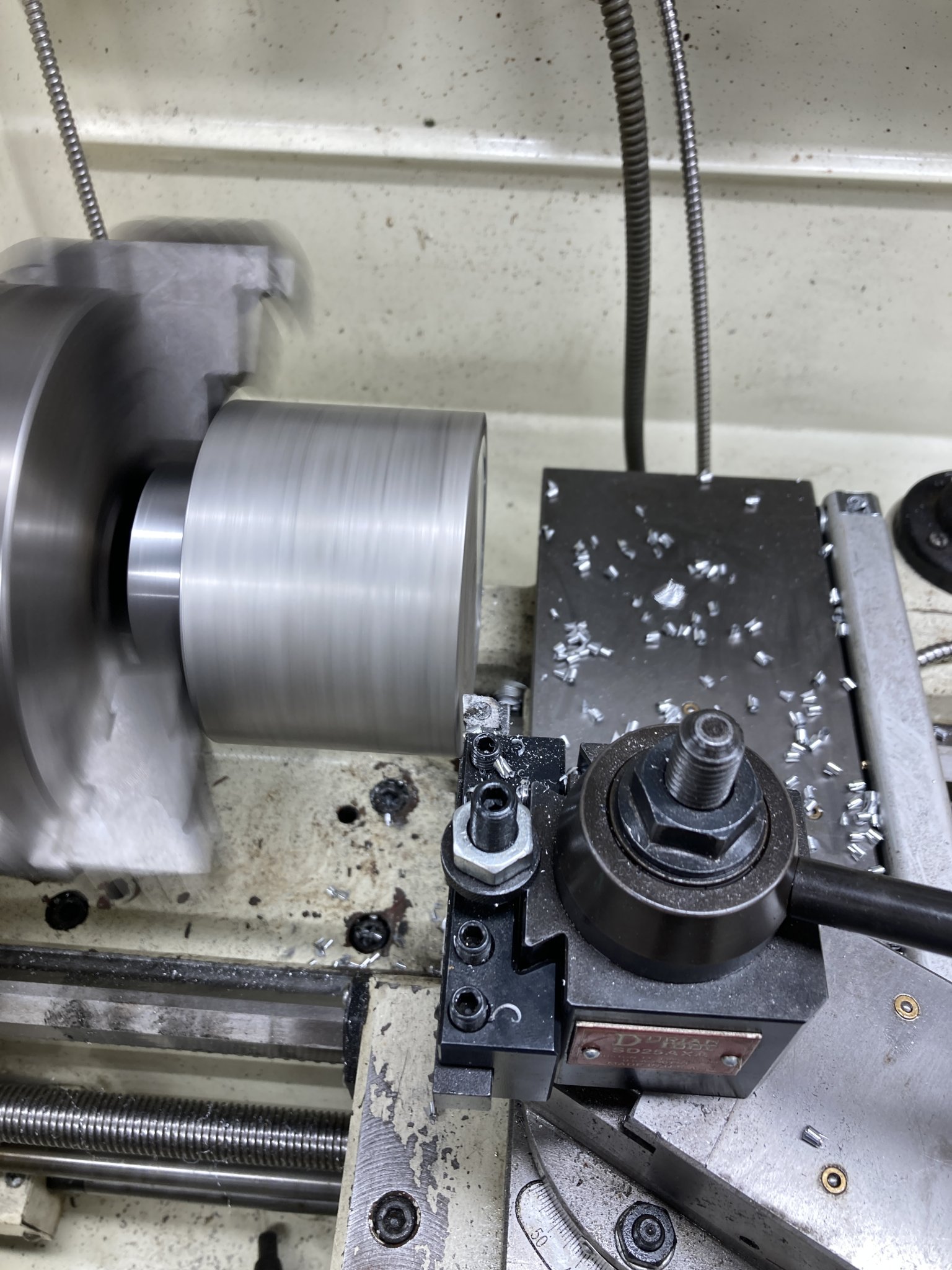

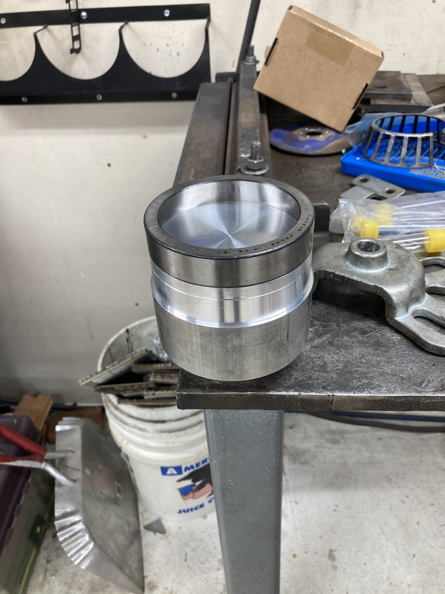

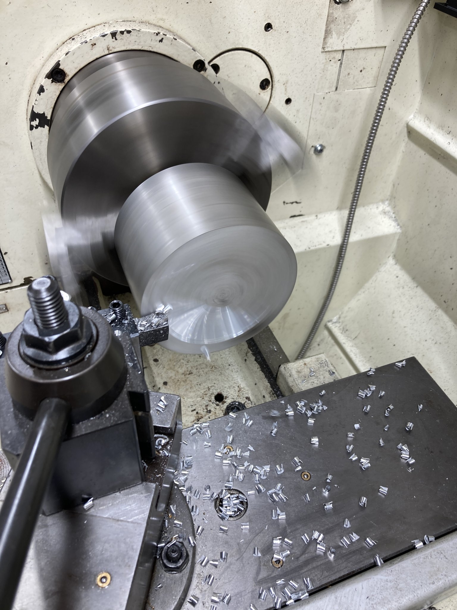

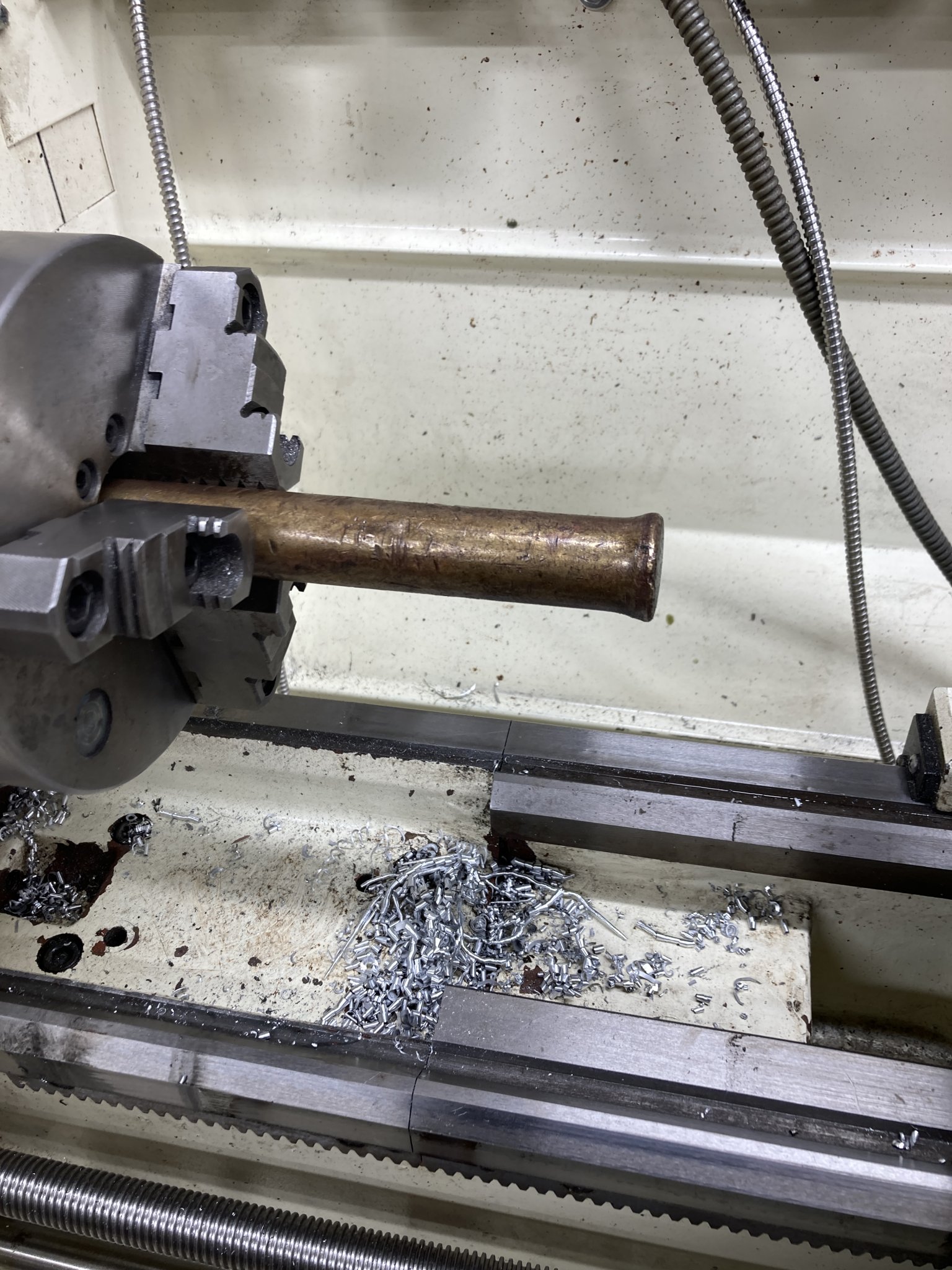

Well this is easily enough remedied........TO THE LATHE SIR!!!!!!!
all I need is a small spacer, so I did through the scrap pile and find this little orphan, and decide that it will be the perfect use for an otherwise useless piece of "welding practice"
Then a few seconds on the lathe

It works great, so in "no time flat' I have those bearing off.

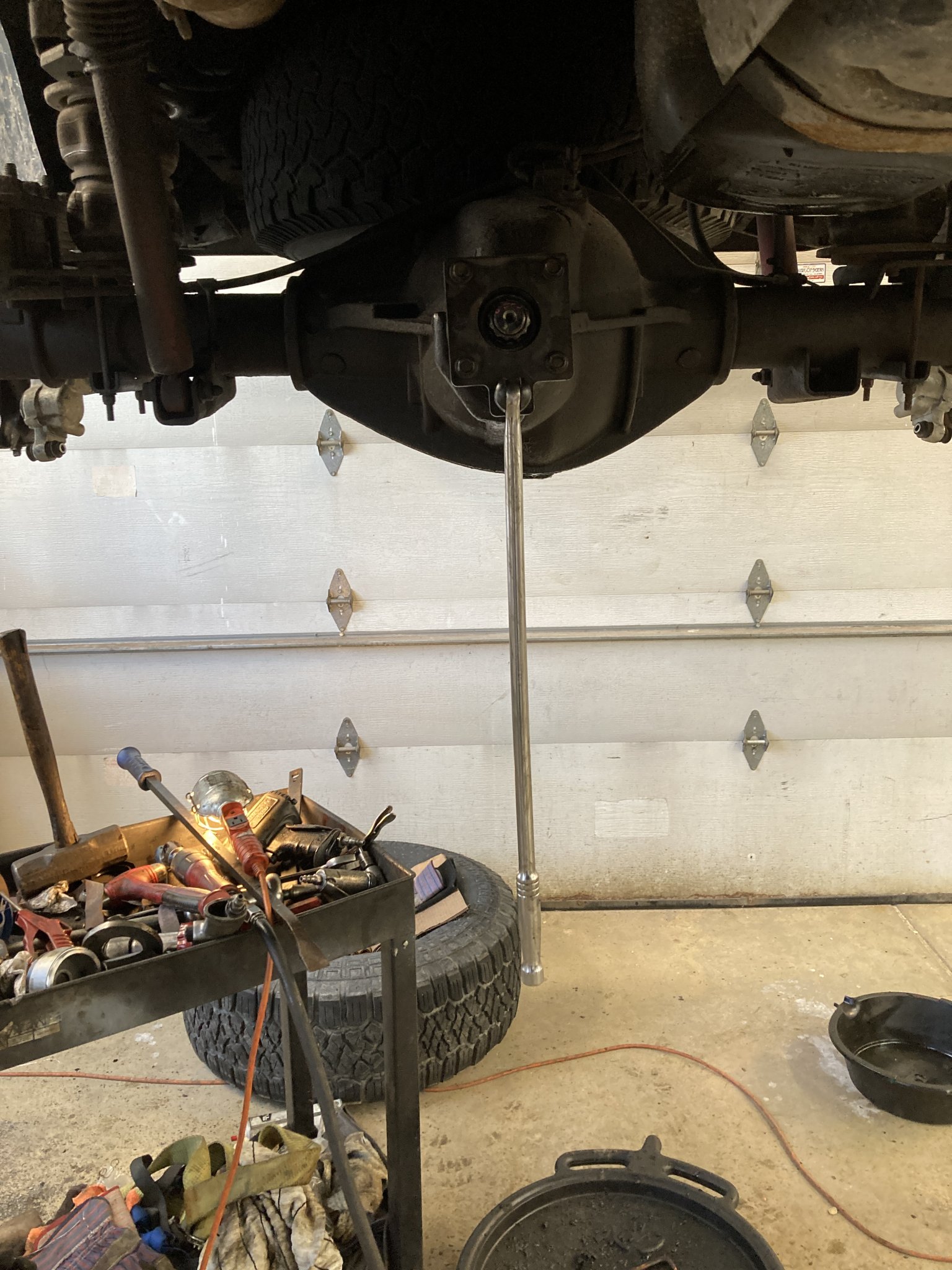

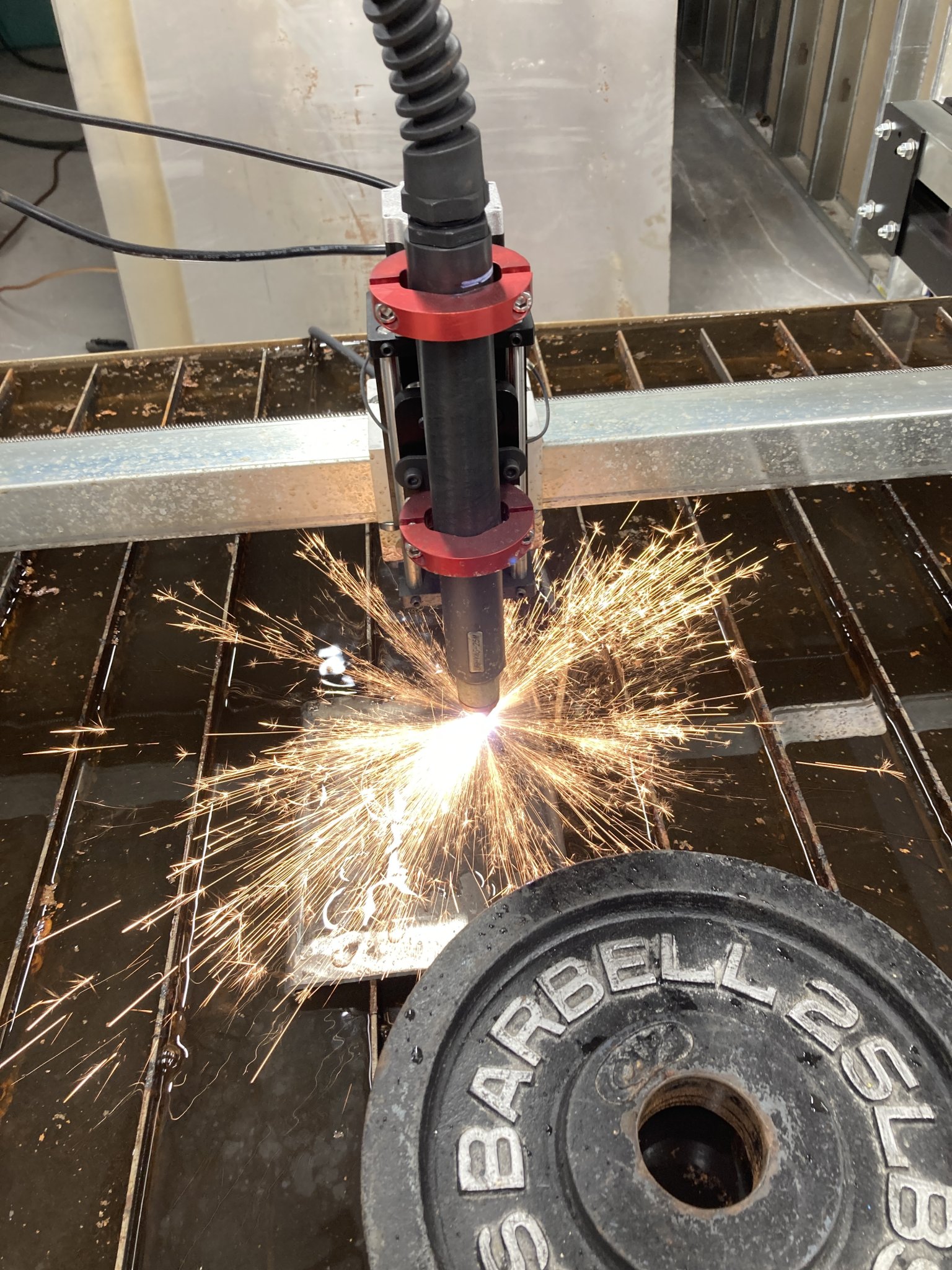

Now for the pinion.

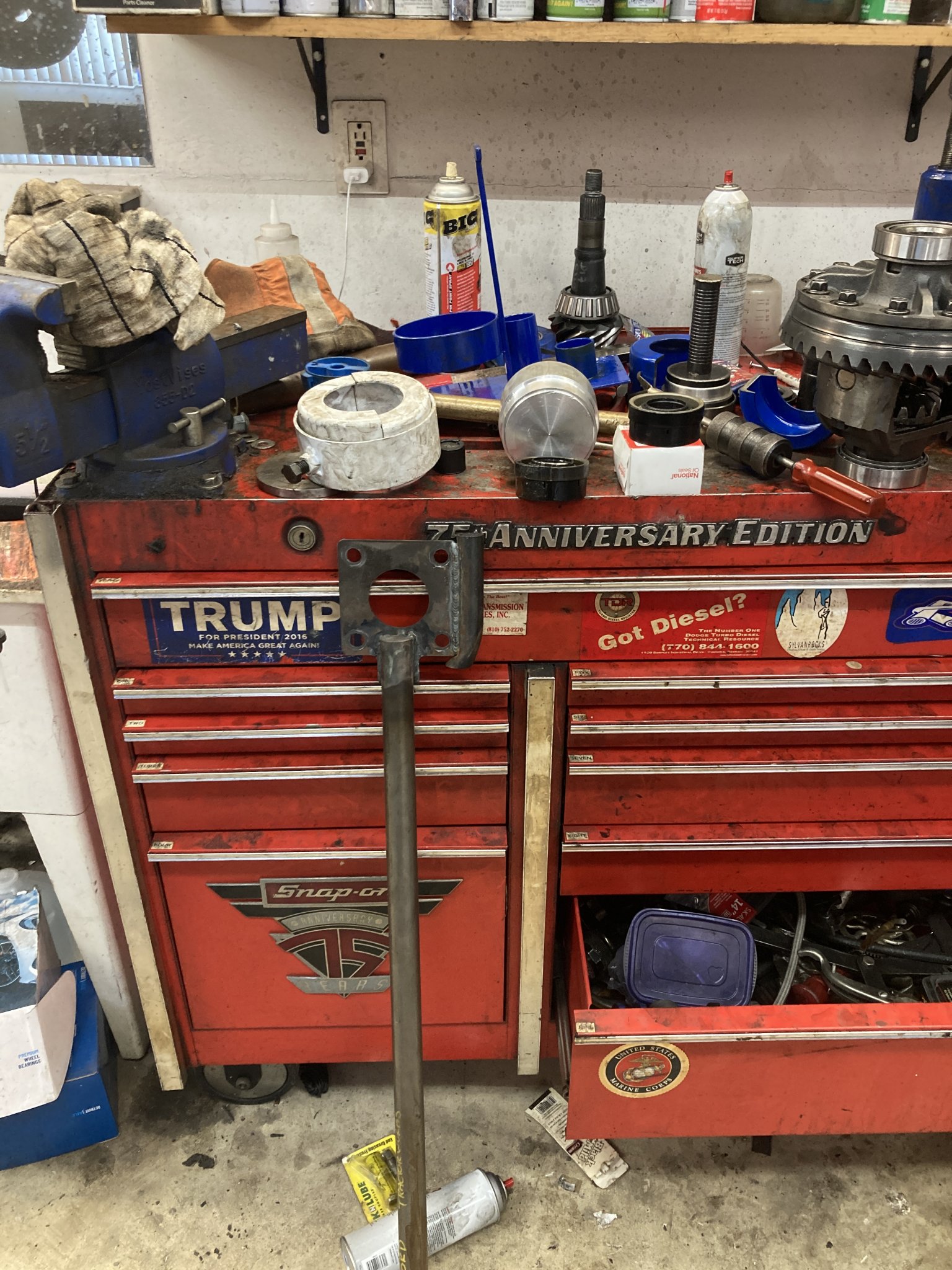

Hmmmmmm......Now where did I put that tool that I used to use to hold those big ass pinions on the 11.5's ?????
Damn......another tool that must have fallen into the Abyss of Time.........

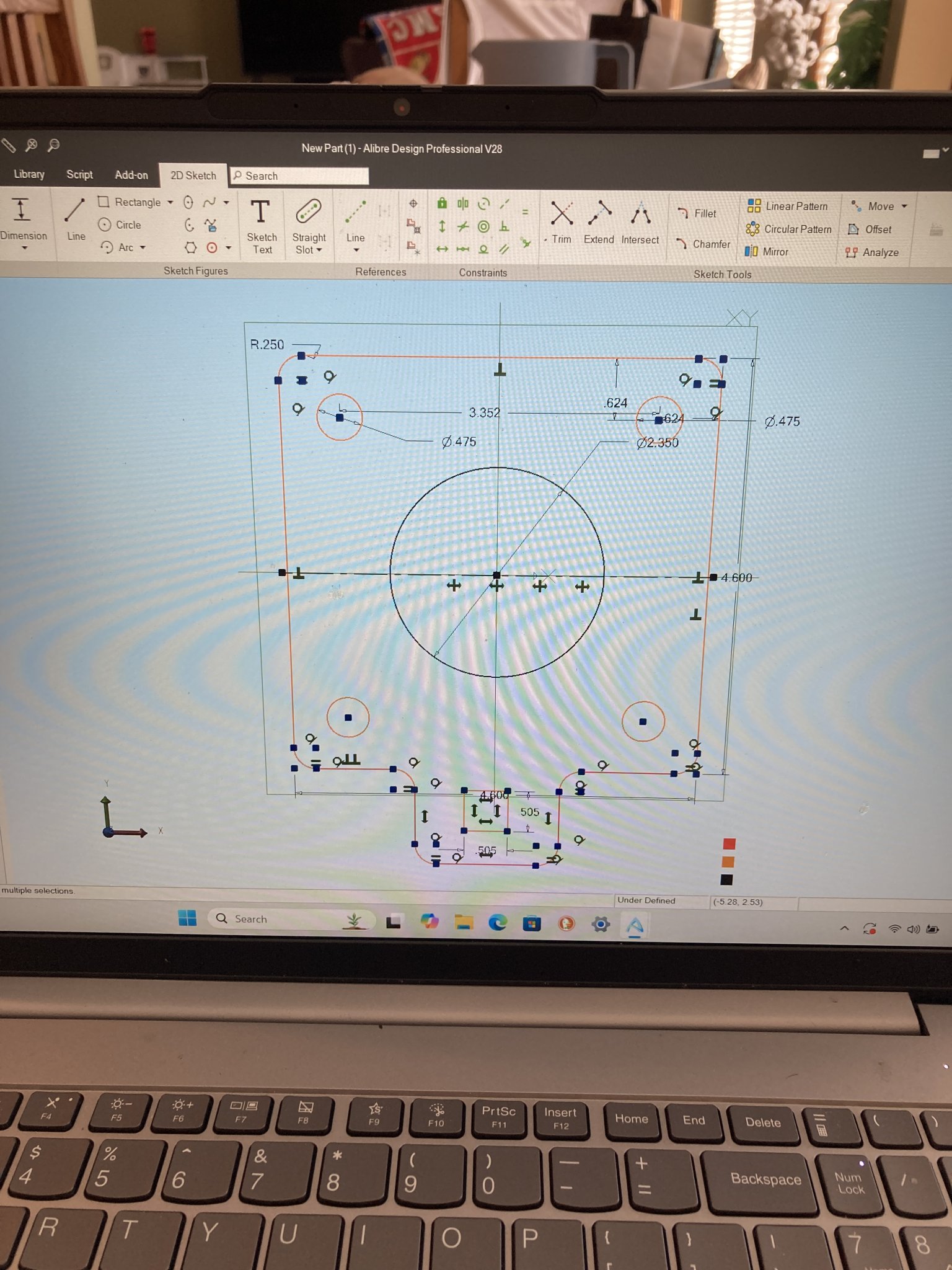

Do I have to shell out more money, and wait 2-3 days, for a tool that will be used once.....DAMN IT!!!

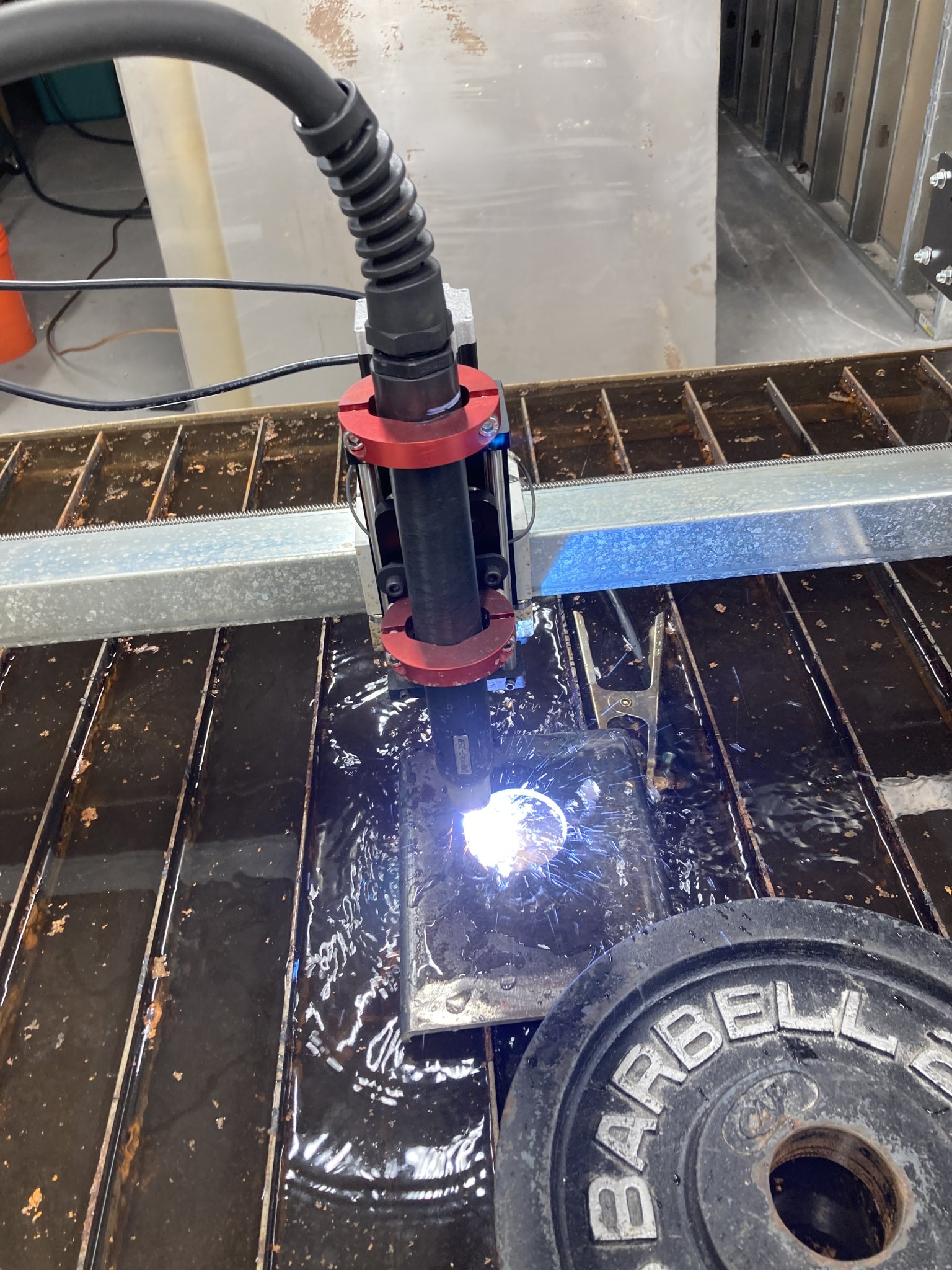

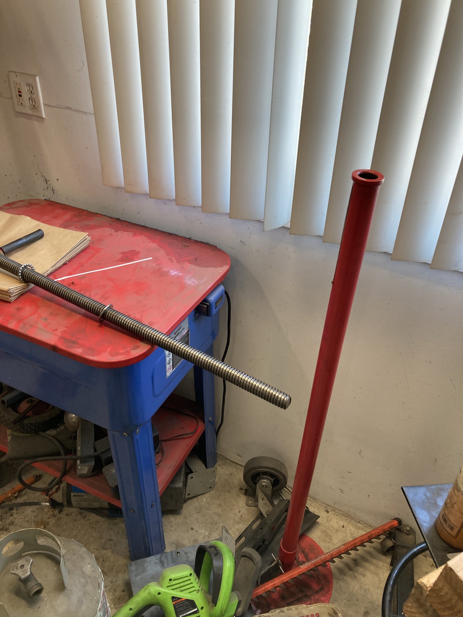

Wait....hold the phone.........An idea pops into my head.

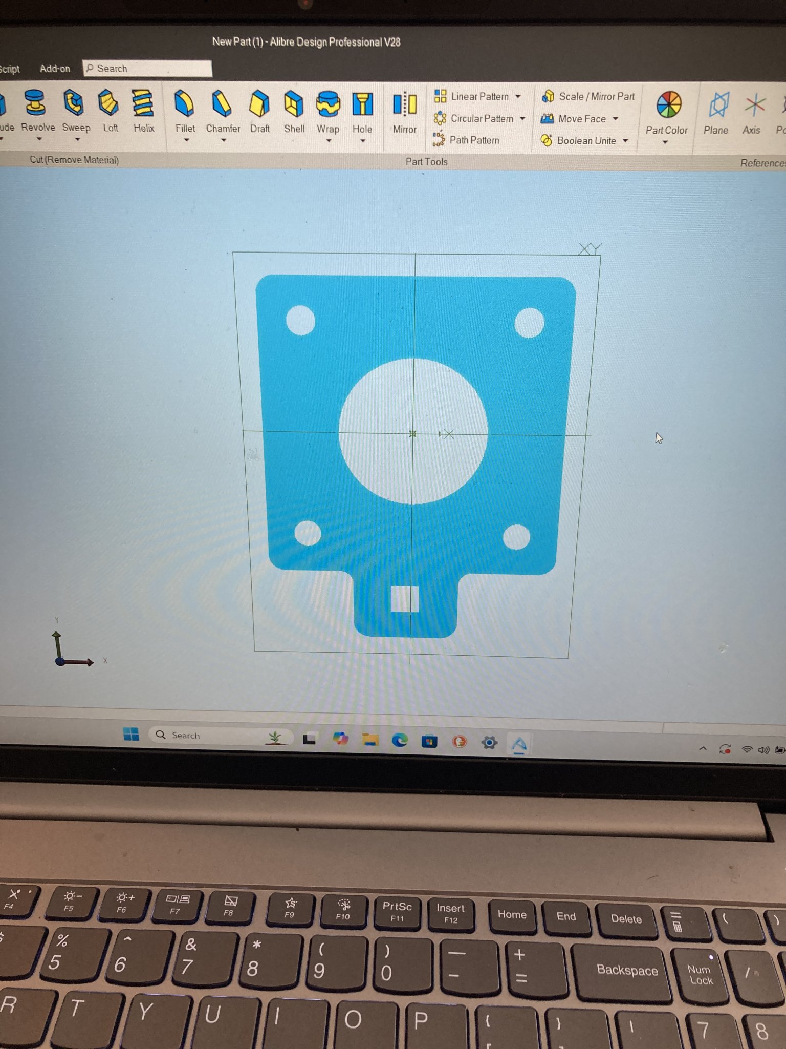

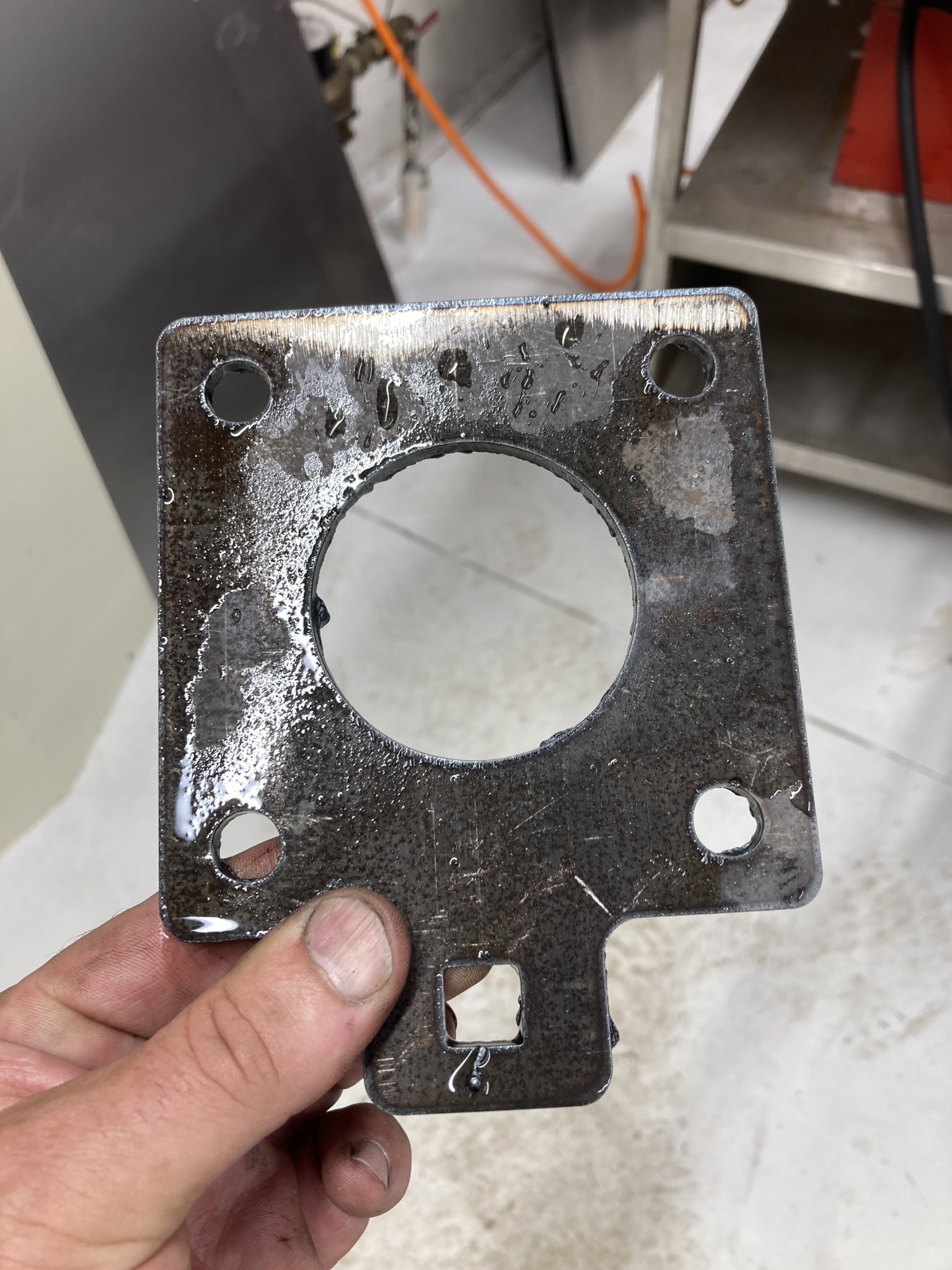

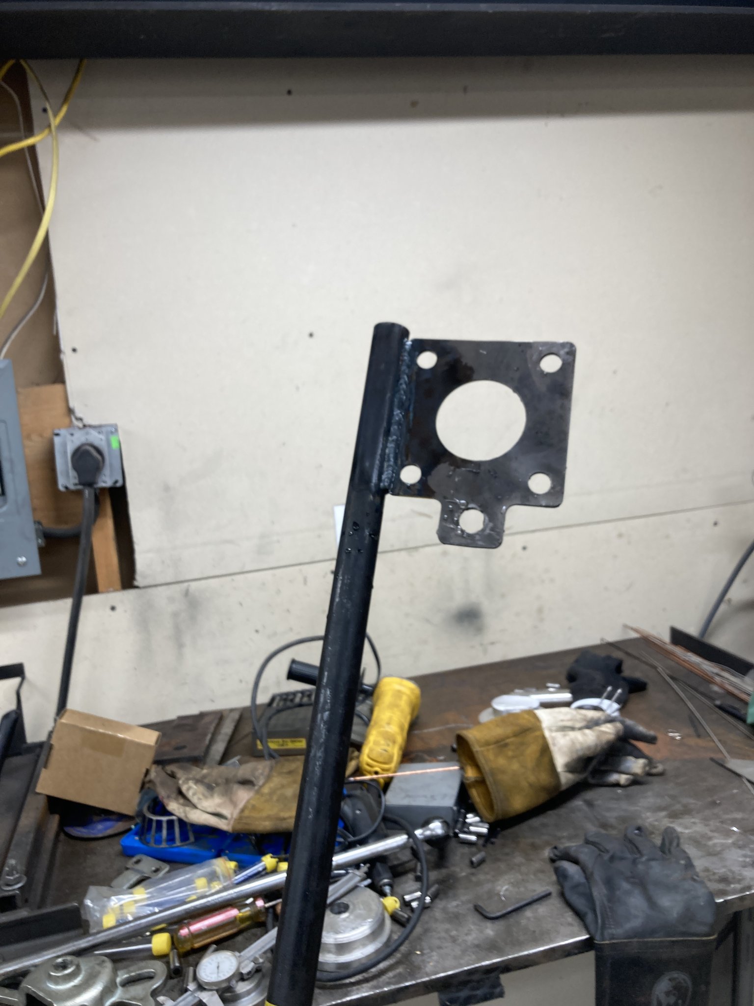

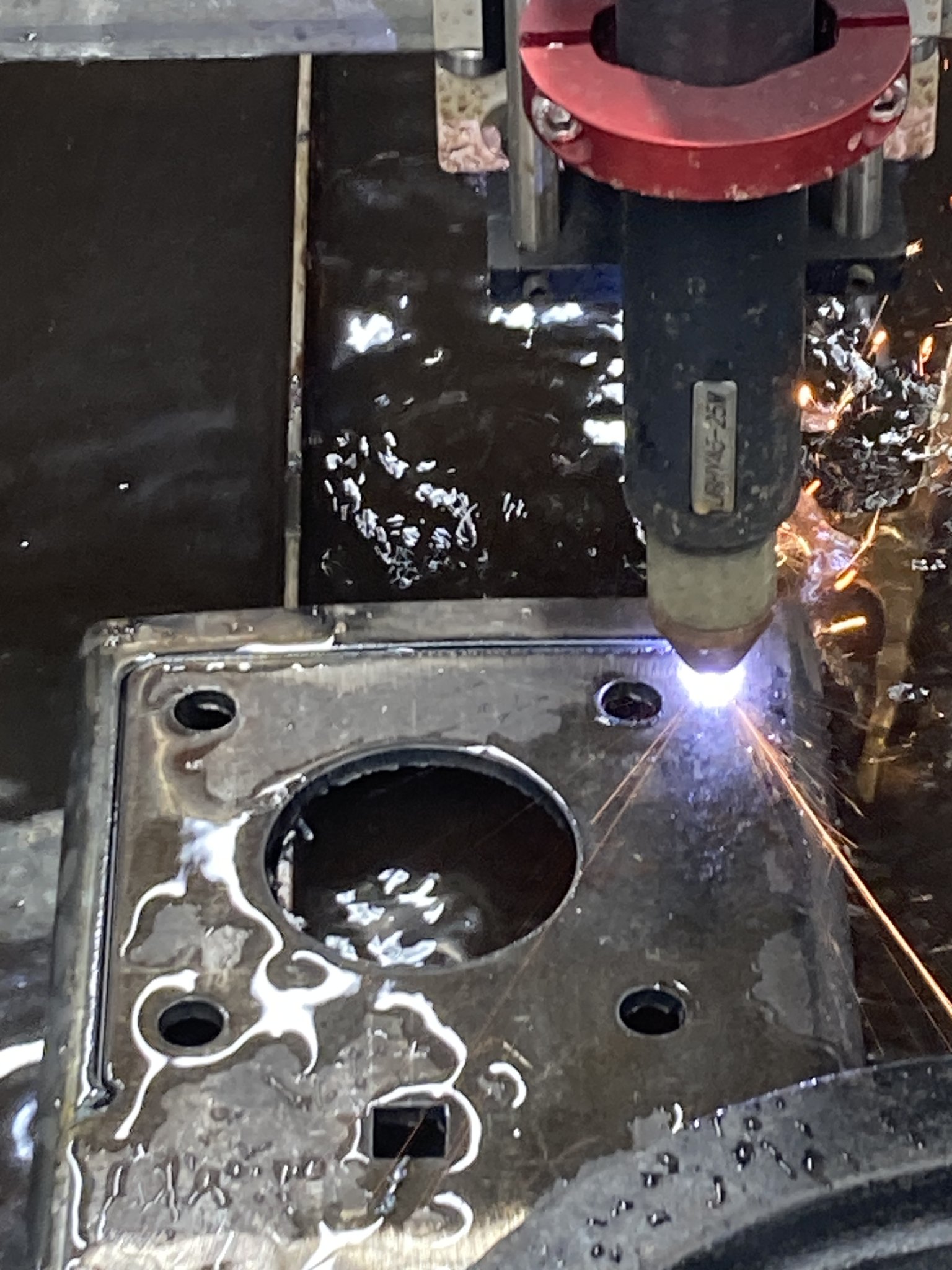

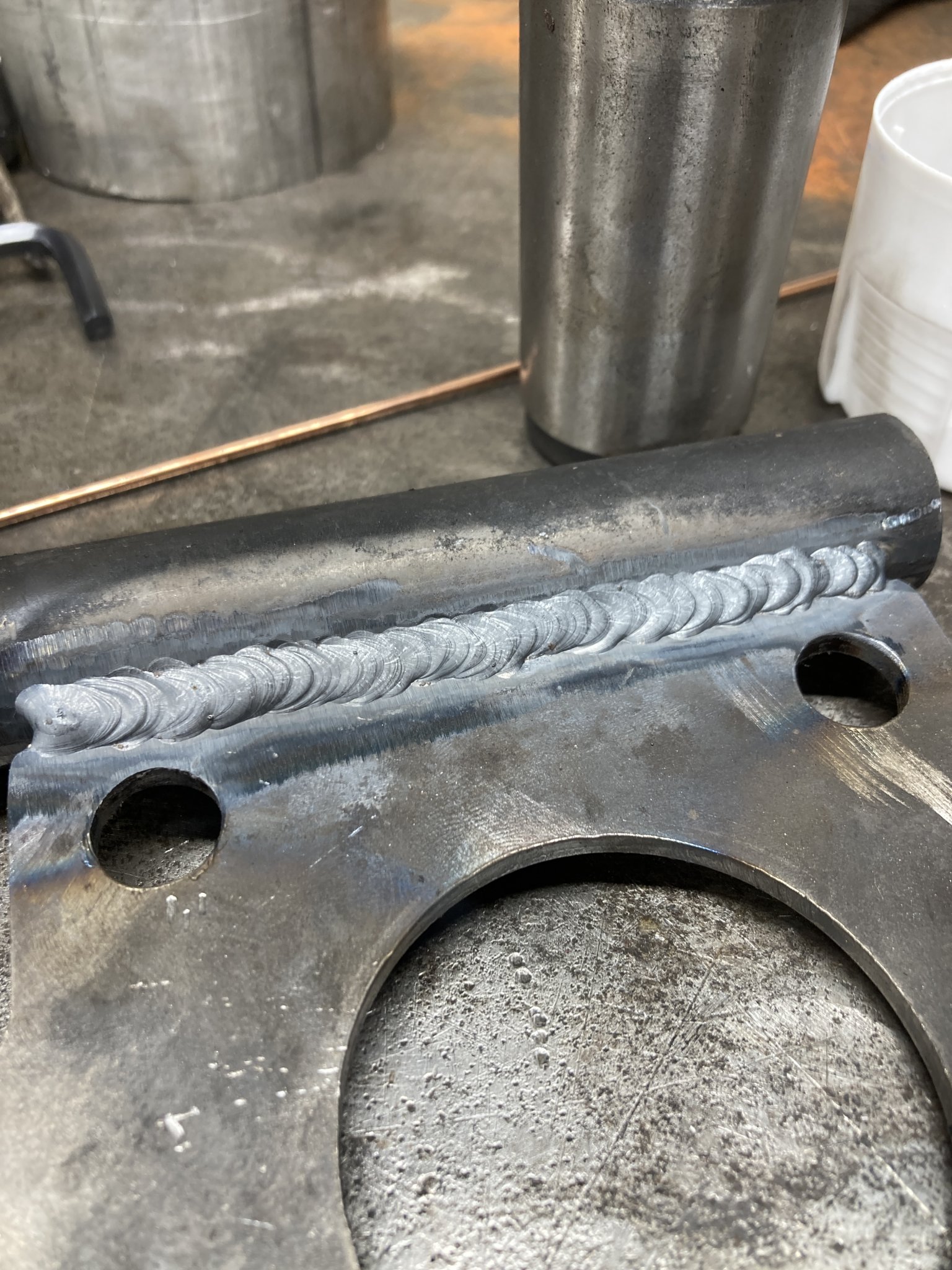

I can just cut one out on the CNC Plasma cutter........So I take a few measurements, then jump on the computer, and a few minutes later.......TaaDaa!!!!!
Now "TO THE BATCAVE!!!!!"
( it also appears that I have finally found a "good use" for those weights I bought to "get into shape" with :ROFLMAO: :ROFLMAO: )
and about 25 seconds later.

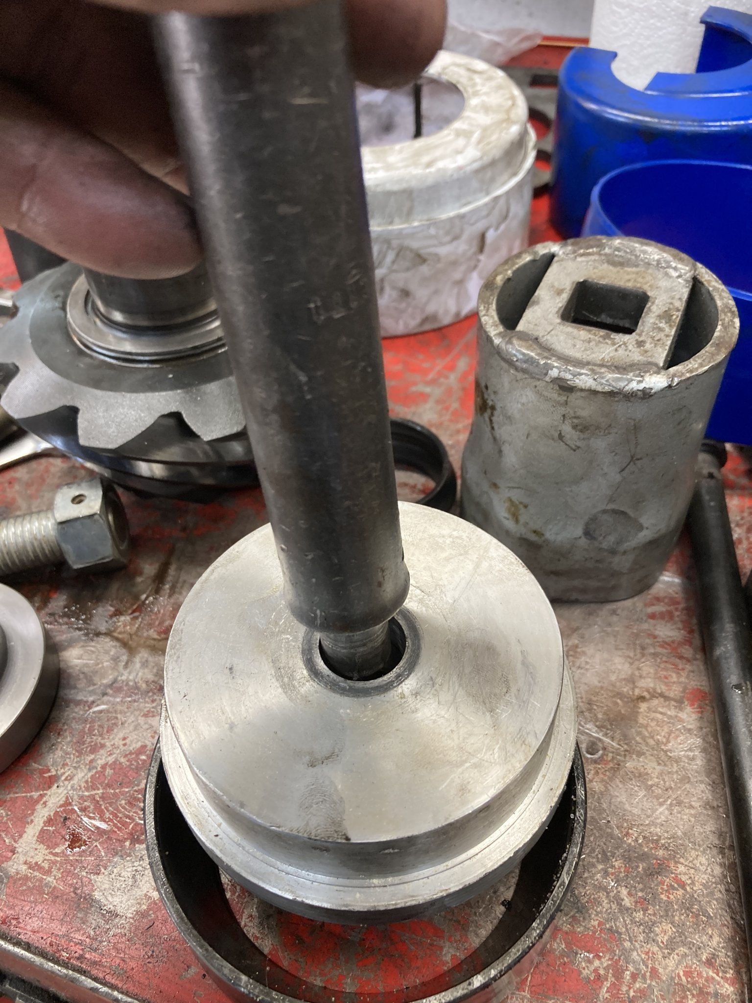

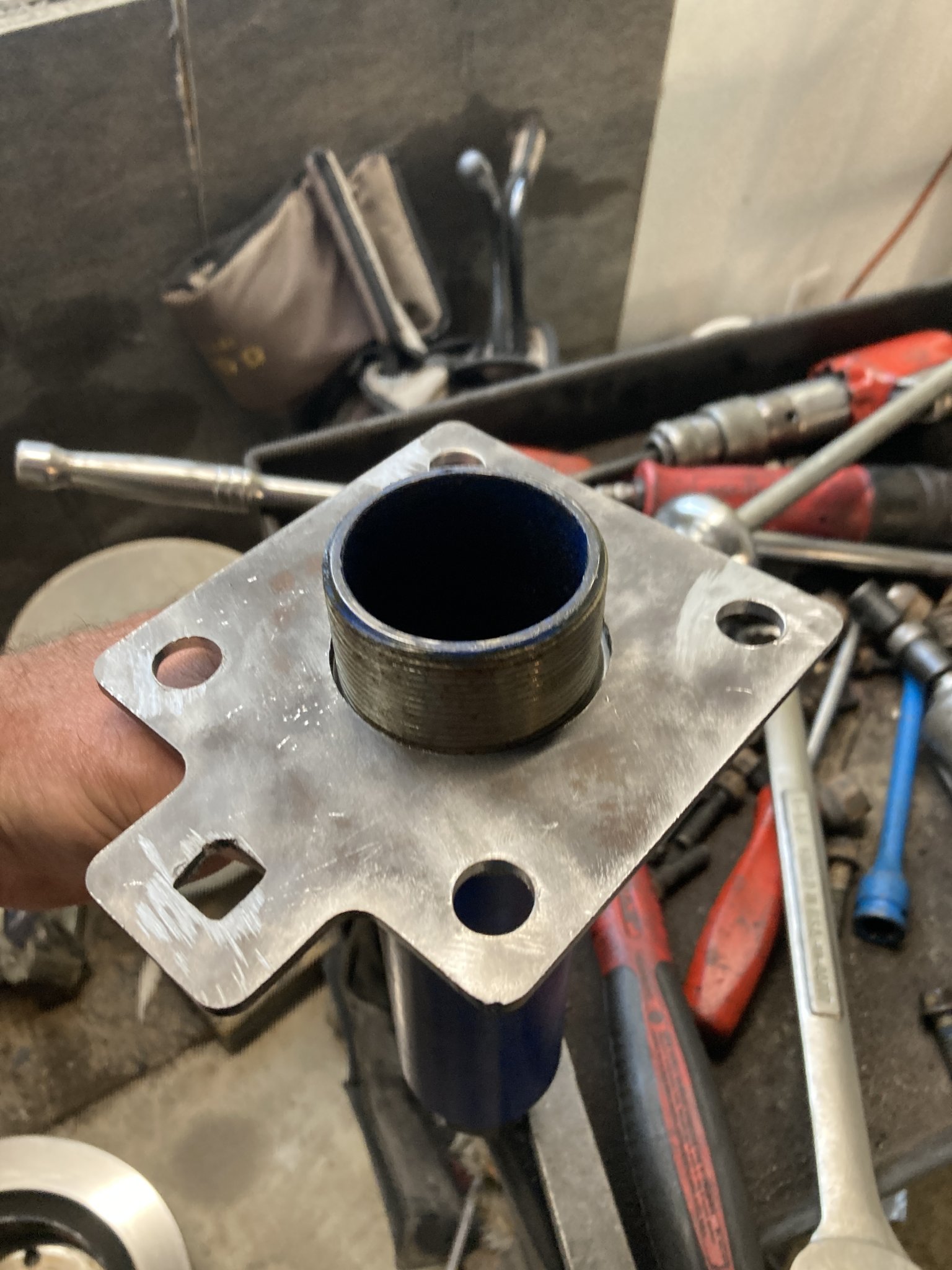

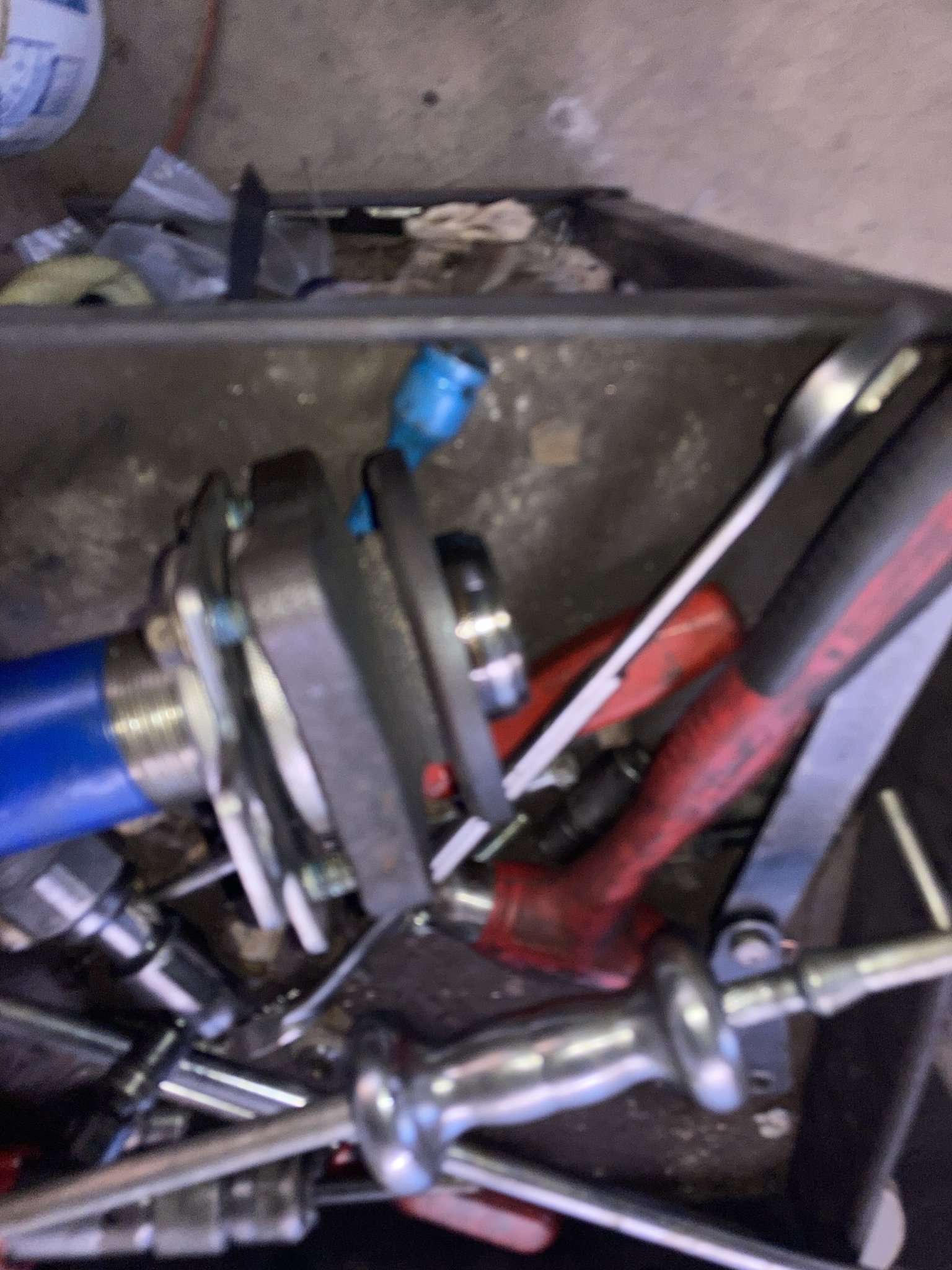

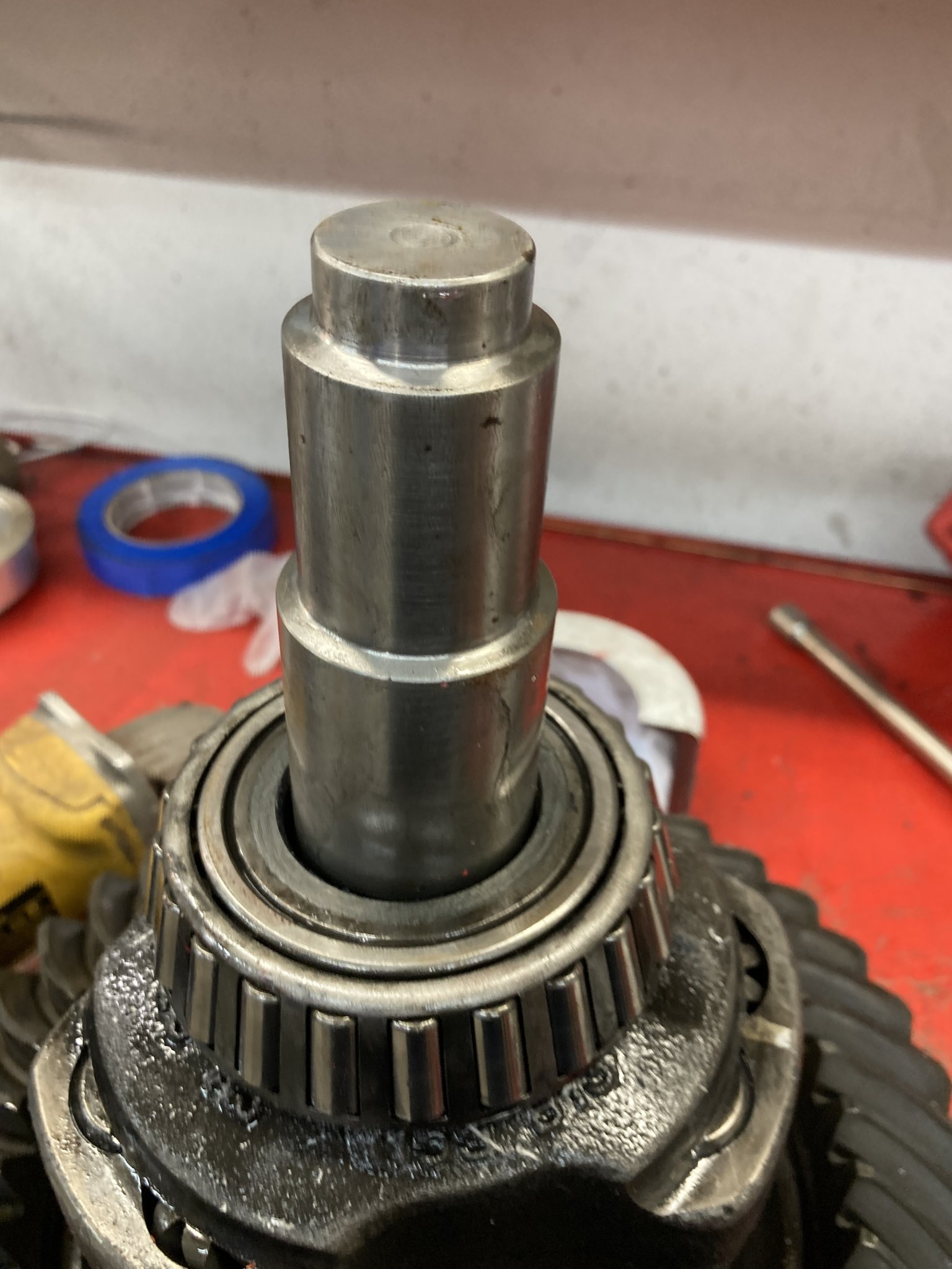

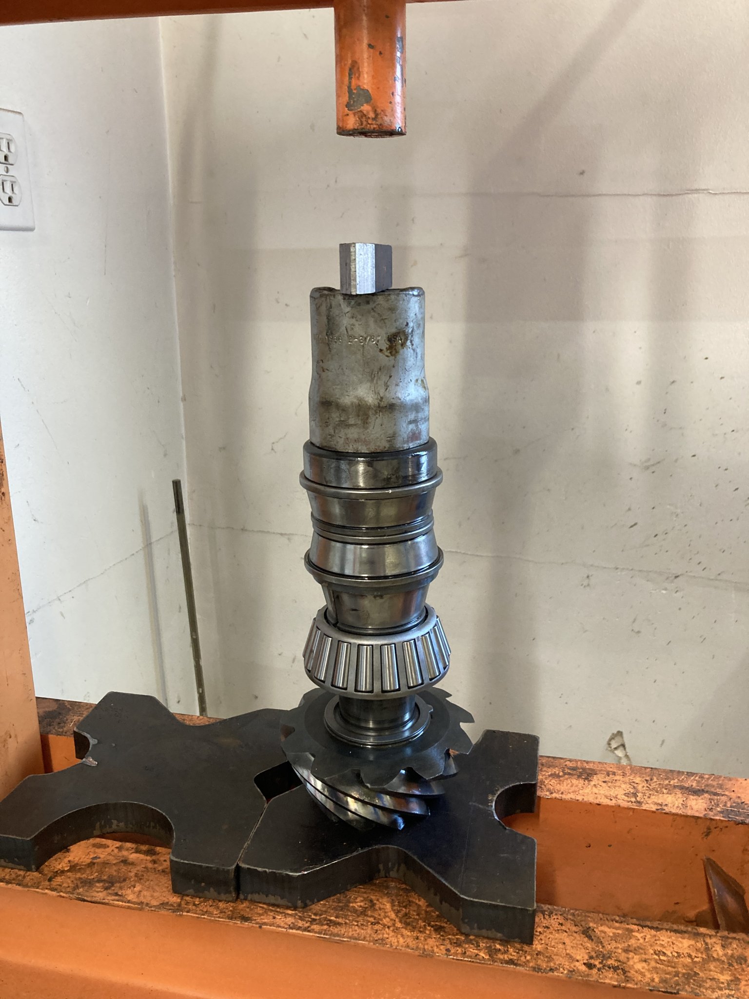

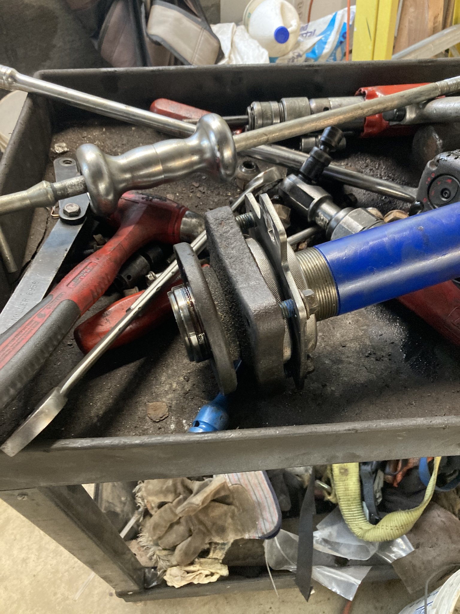

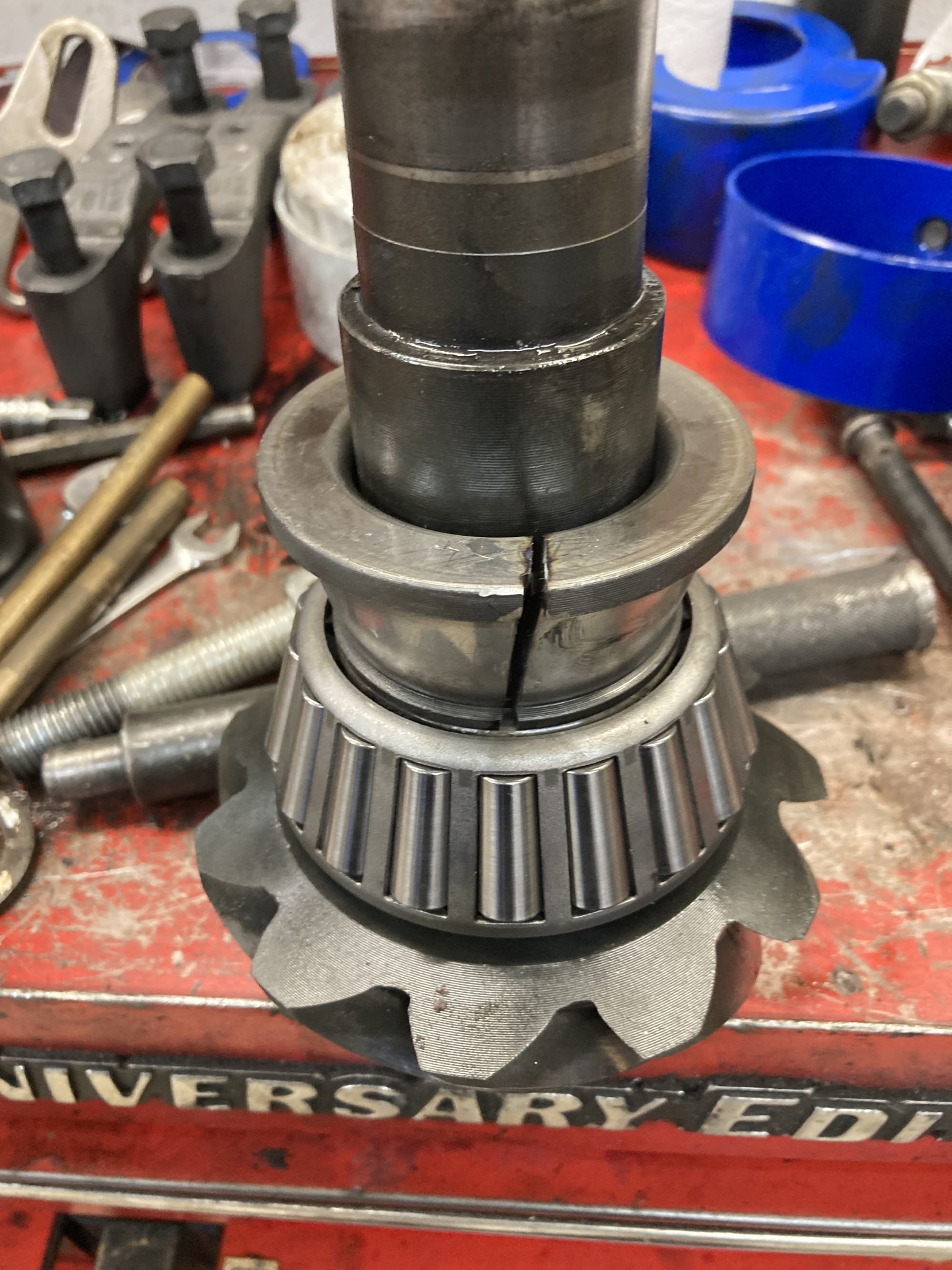

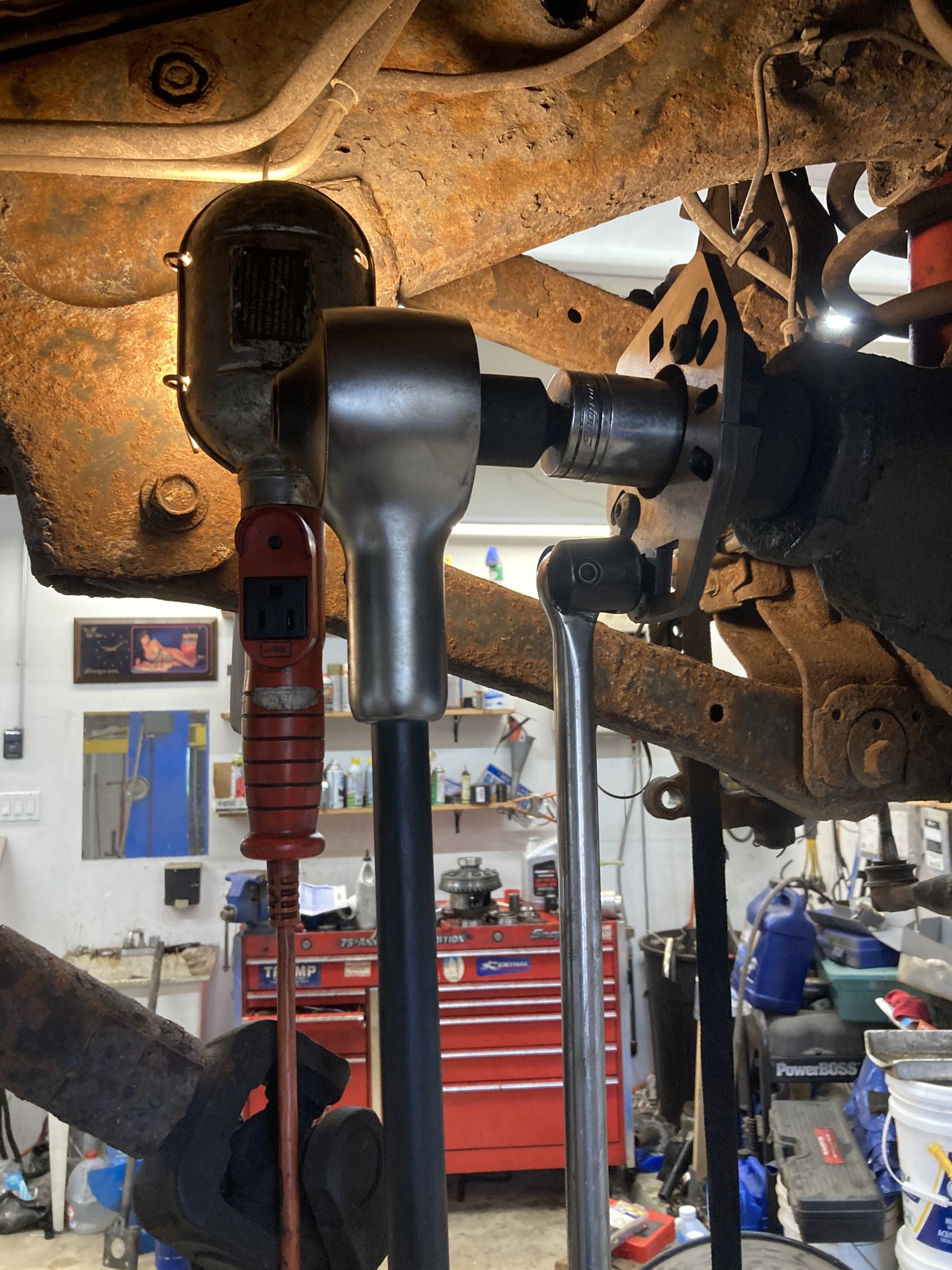

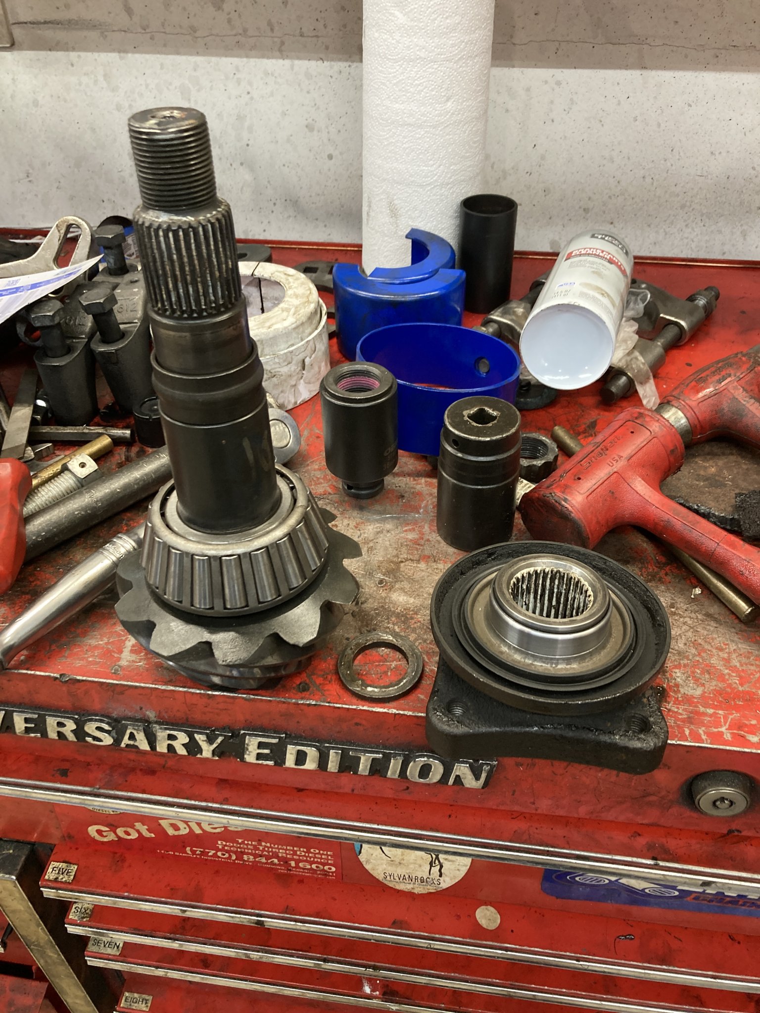

Now I use the bearing puller in a "rather un-conventional" way.
I used a variety of my pullers/slide hammers, then I was just trying to "beat it" with the nut on to protect the threads, using my "Flintstone hammer" but I was getting a bad feeling, so I stopped to think it through a little better.
Then I figured that I could incorporate the new "Pinion tool" and use the "socket hole" in the center with the bearing puller.
And by shear luck, it fits.
In the pic below there is also a "collar" underneath the "pinion tool".
I did end up "dinging" a 1 or 2 threads, but I am confident I will be able to "file them" to make them work.

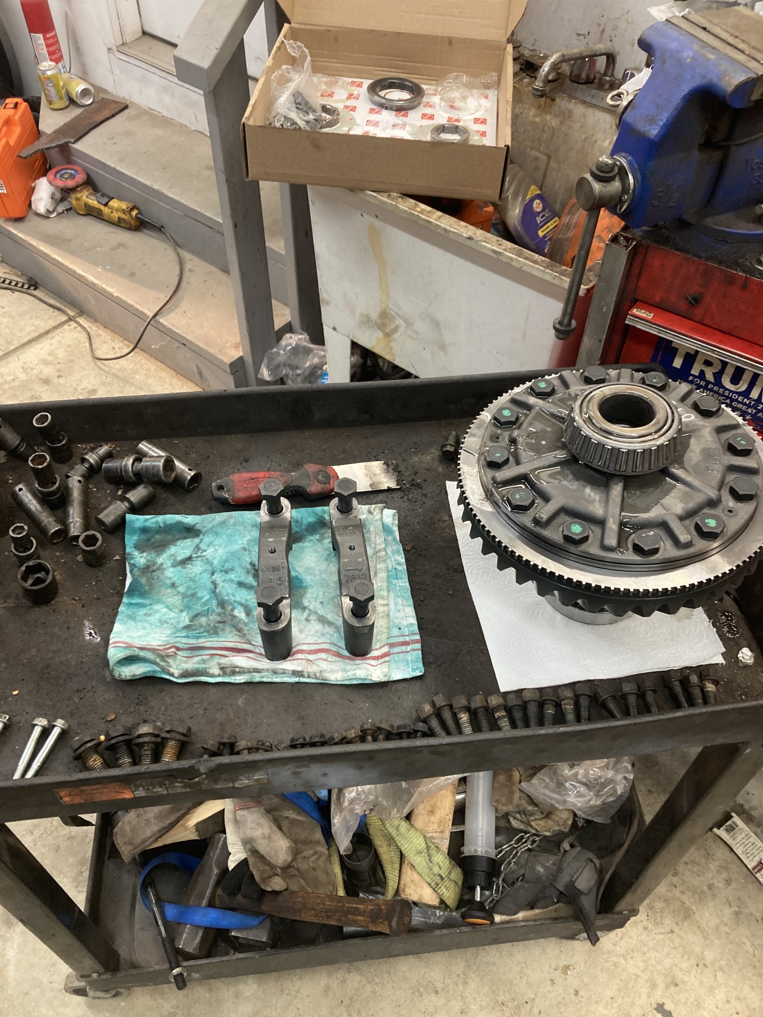

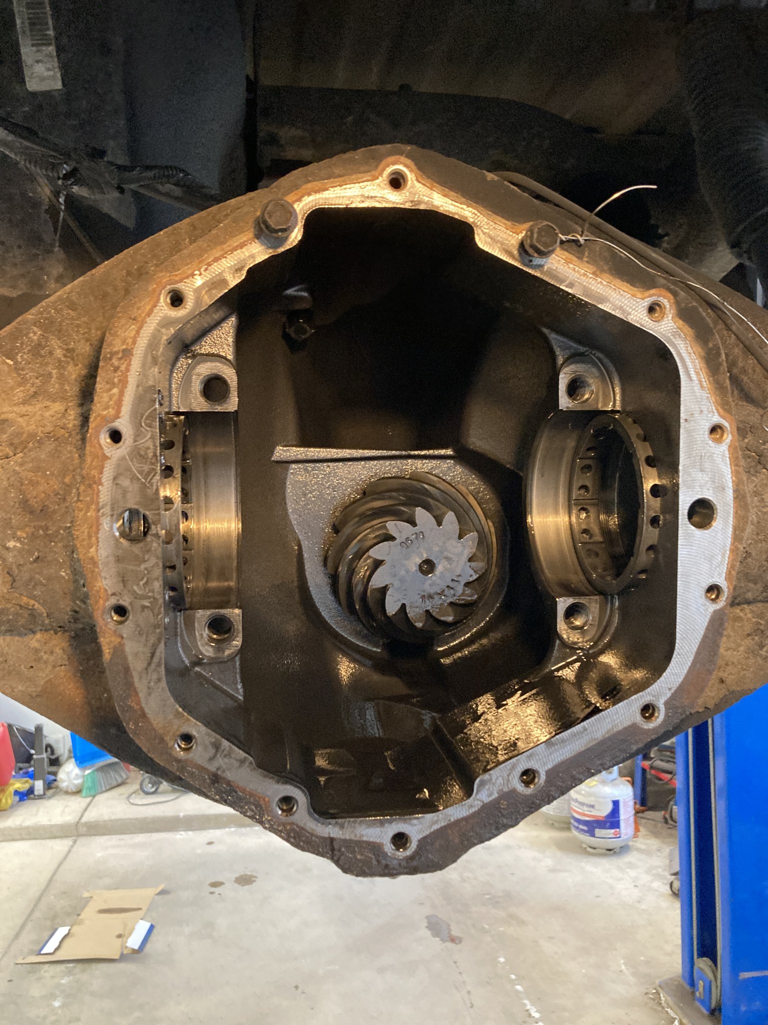

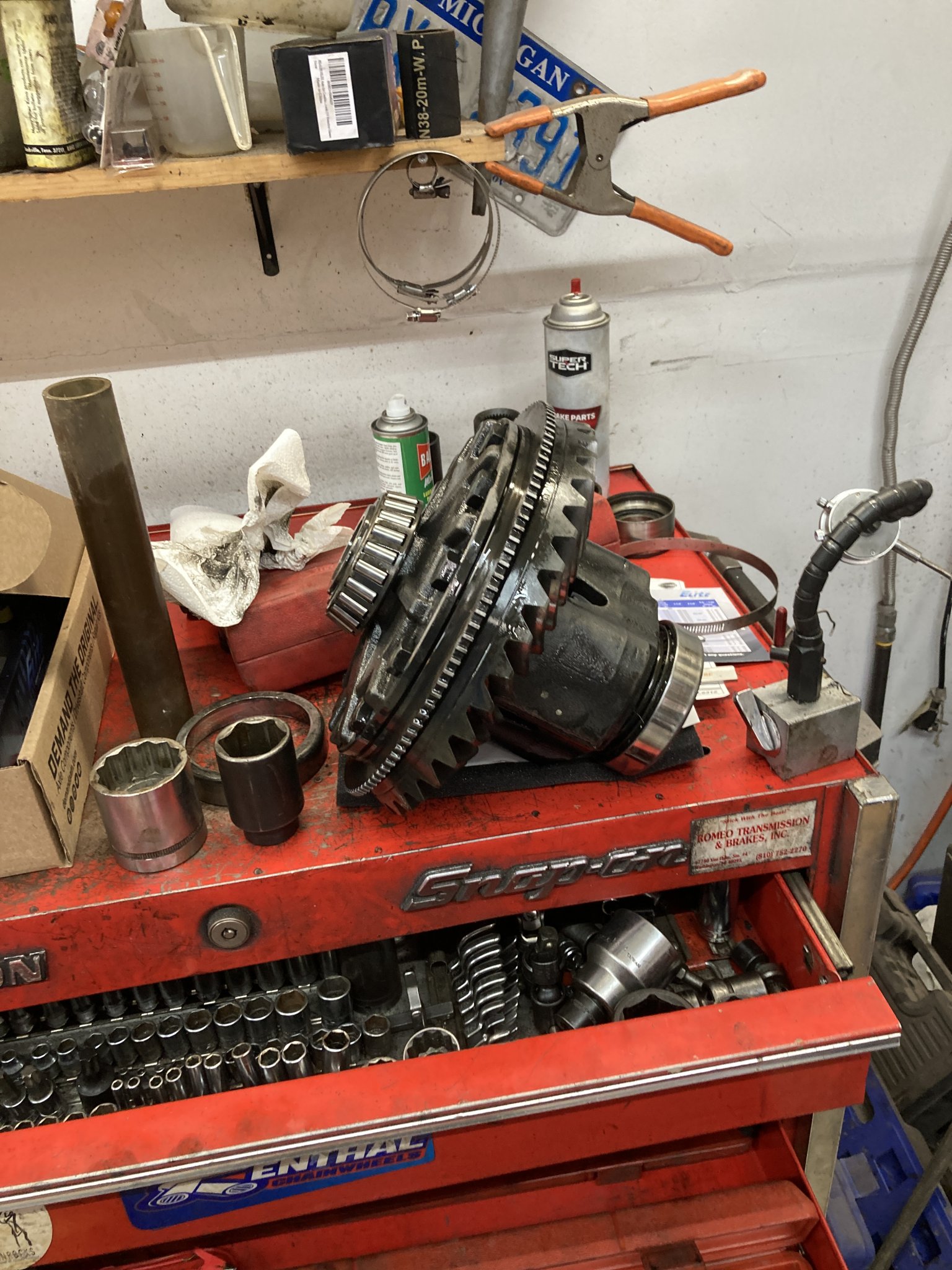

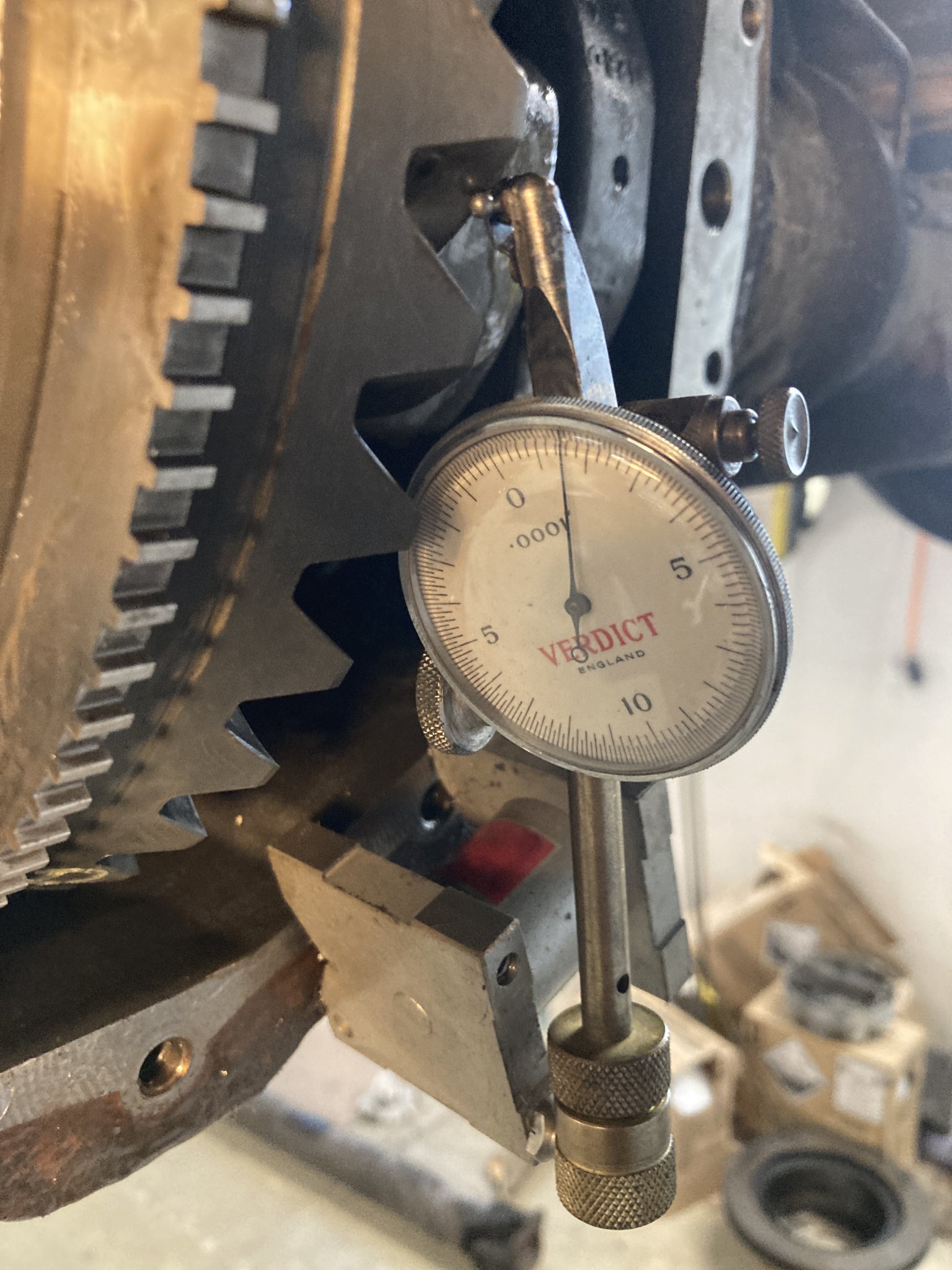

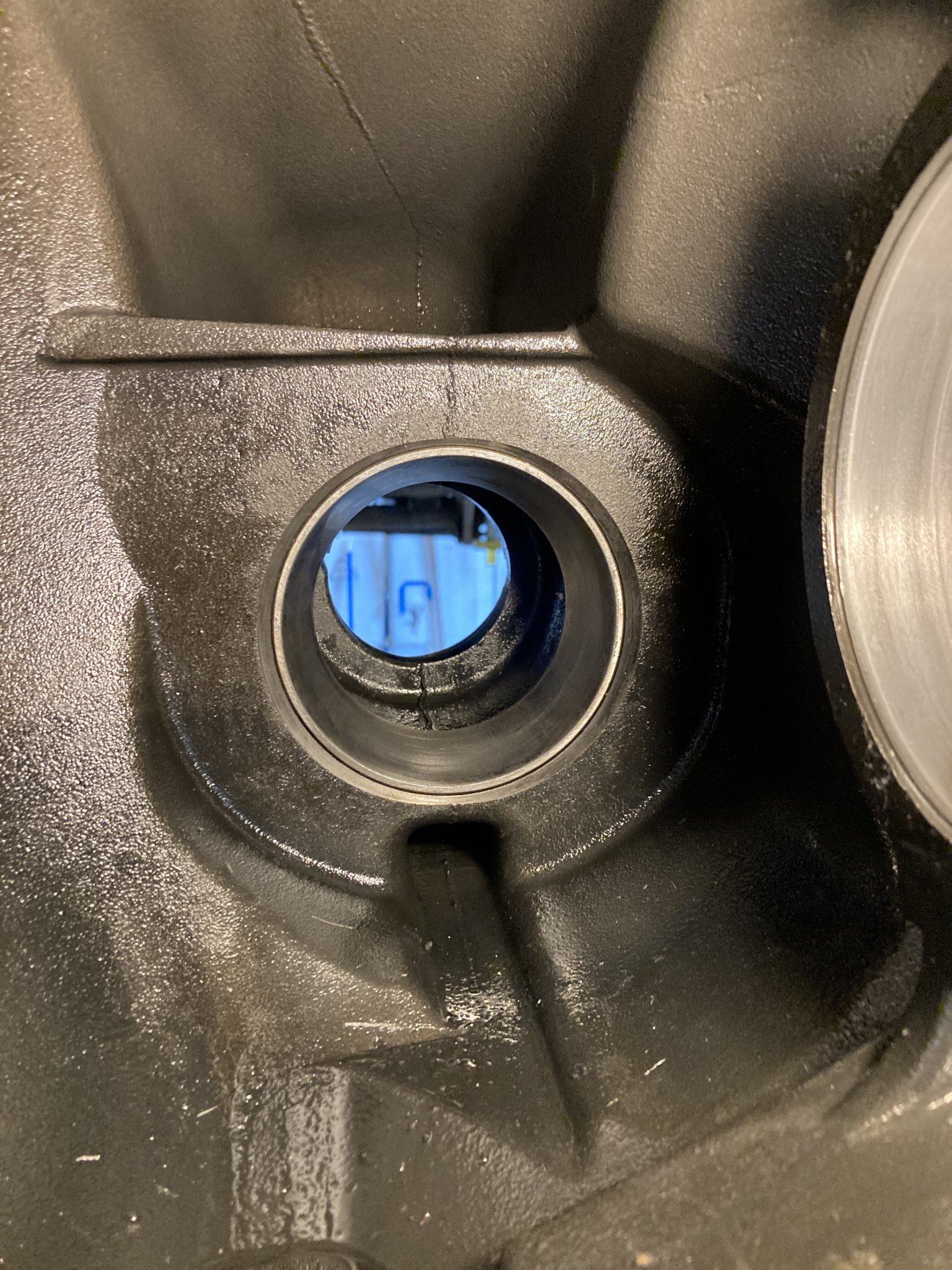

Somewhere along the line, I clean and inspected the ring and pinion, and I think it looks pretty darn good, so I decide not to replace them.

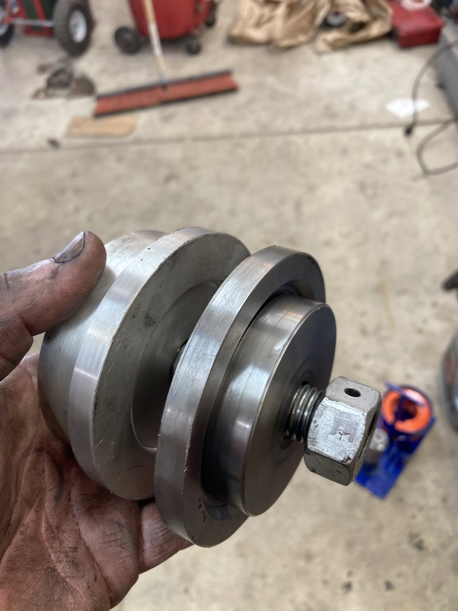

This of course has the advantage of not having to worry too much about pinion depth problems.
So I use the old pinion shim, and now I stack a variety of old races and other odds, and ends I find laying around.....
It looks sort of like something in a Dr. Suess book.....but hey, it works.
I also put an "expansion slice" in that bottom race, just so it did not 'get stuck" and have to beat it off.....(Hahah he said "beat it off")
In Like Flynn.......(whatever that means)

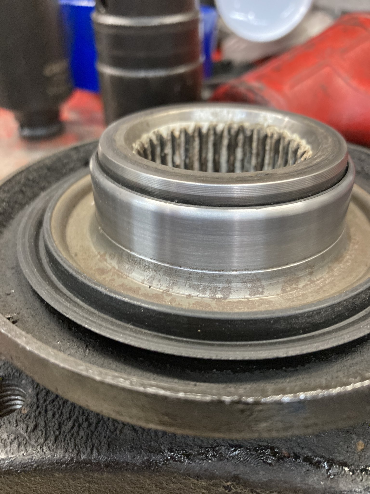

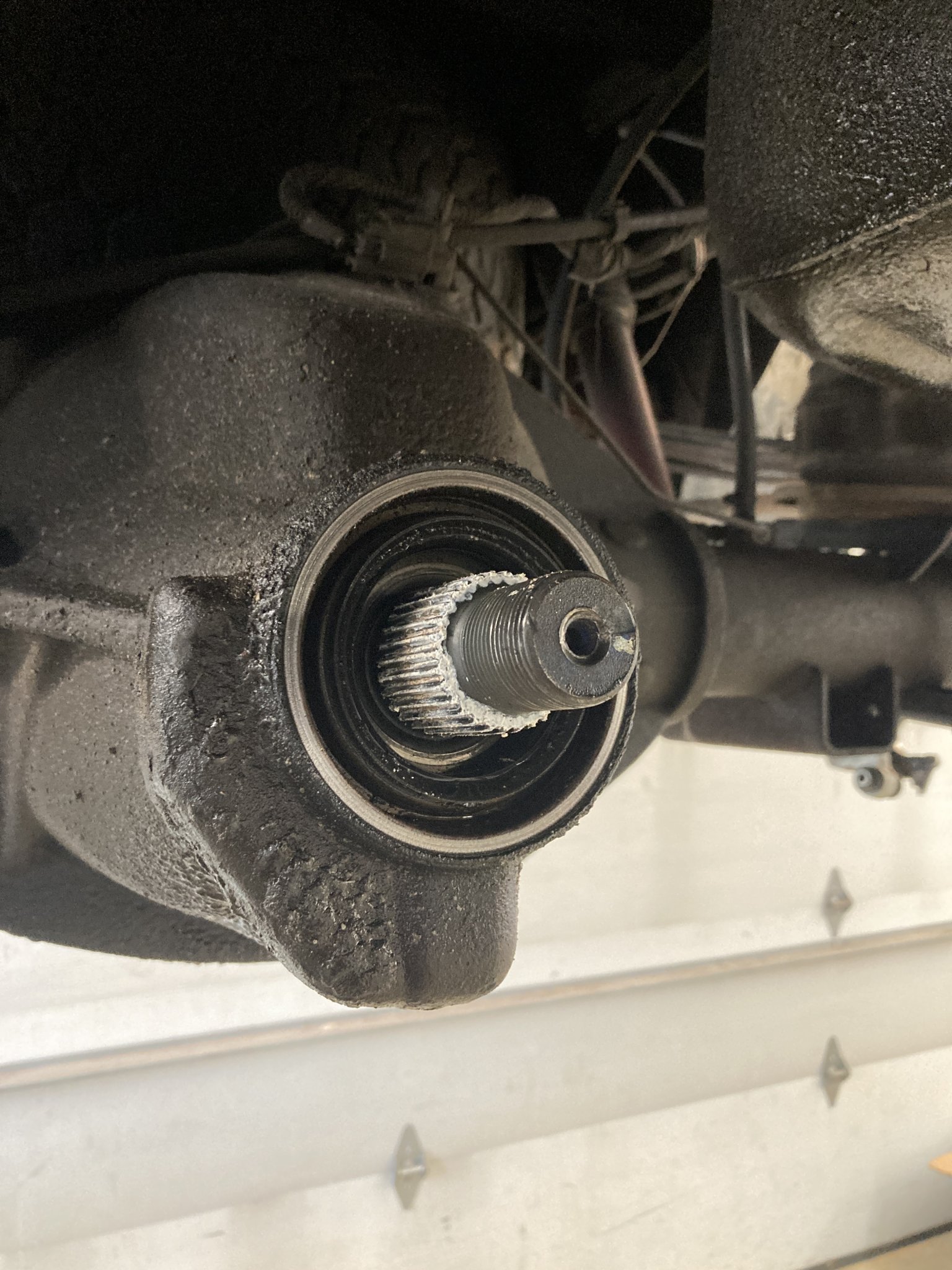

I also used solvent and some scotch brite to clean up the pinion sealing surface and inspect it for a "wear groove"
Looks good to me.

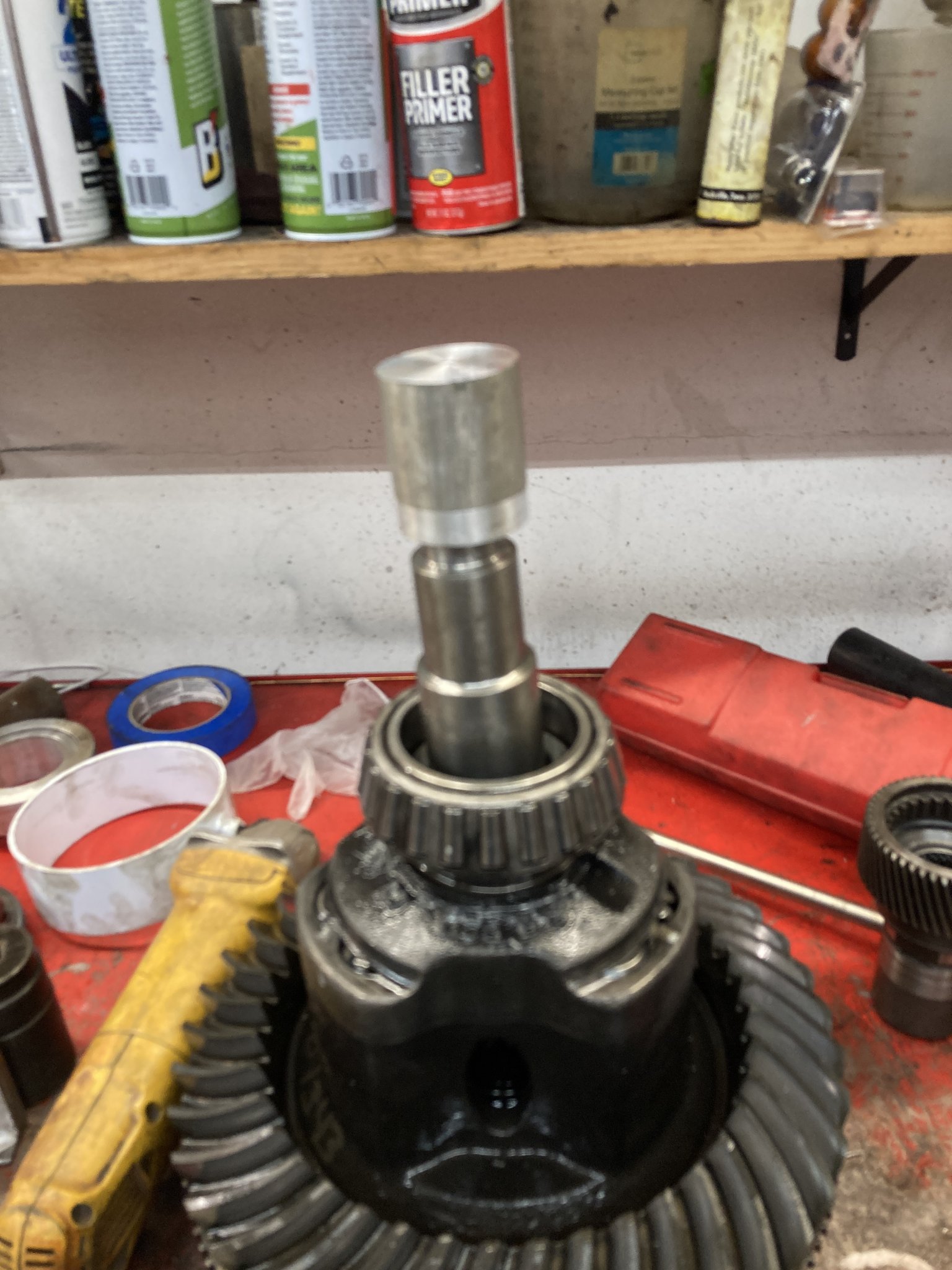

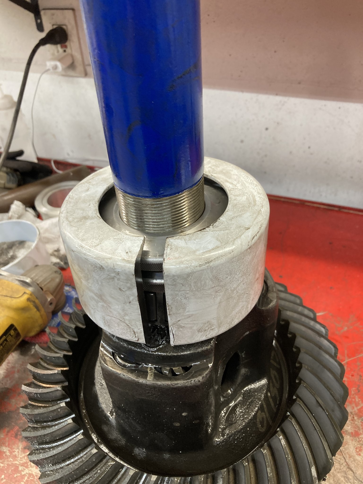

OK, well its "D_Day" so to speak.
Gonna slap her back together, and wish/hope/pray that I get it right.
I suppose that a little "aside" is in order here:
Aside:
After some reflection, it appears that, much of my "specialty tooling" was/could have been Dealership "shop owned tools". (At least more than I thought anyways.......)
I do remember a "station" being set up, and between my tooling and the shops tooling, the lines got "blurred".

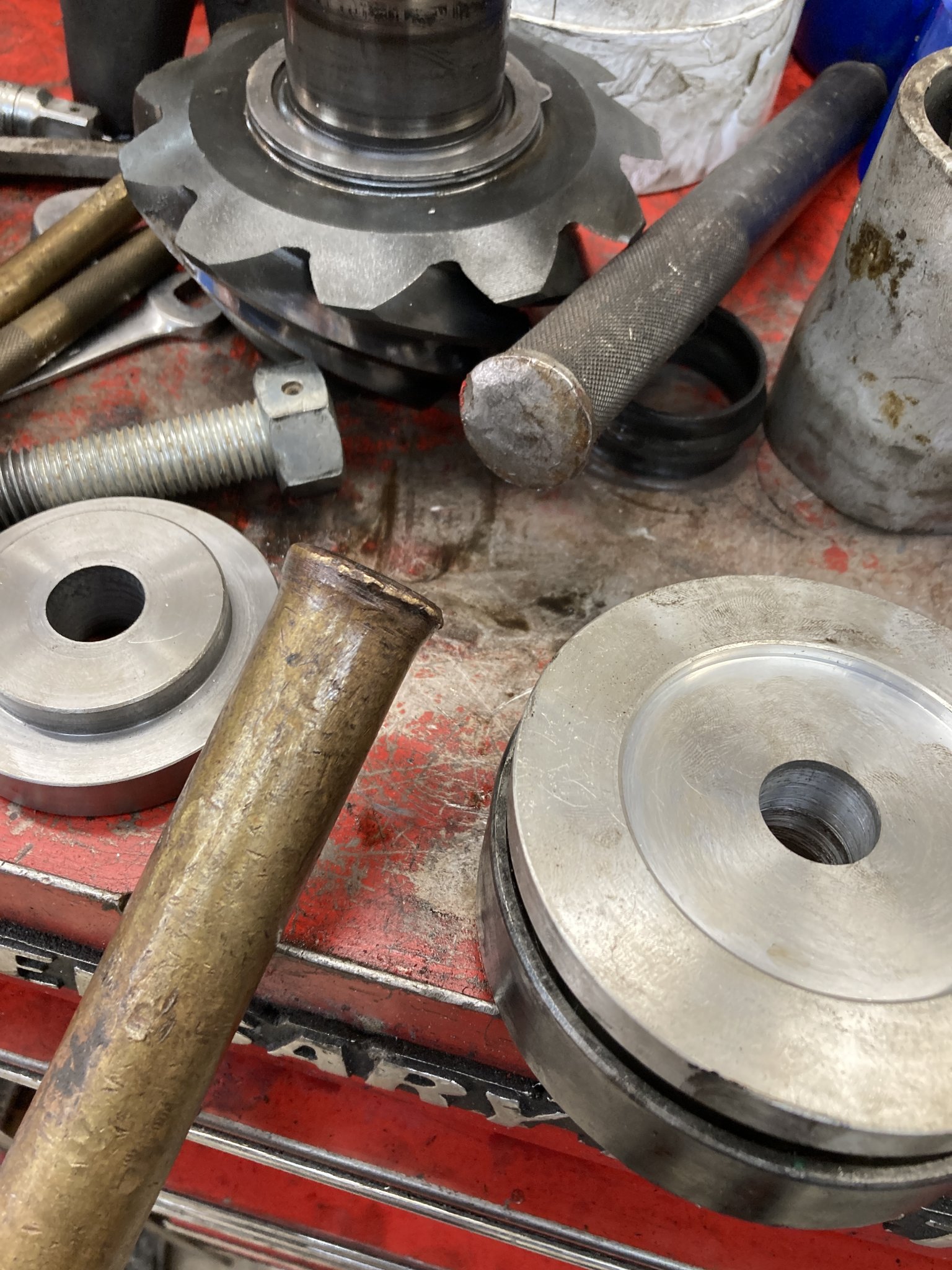

So now I am looking to seat the races, and I cant find one damn race seating tool that fits this axle.
Although they are not complicated tools, as you will see, I have to make some homemade stuff.
So here we go.

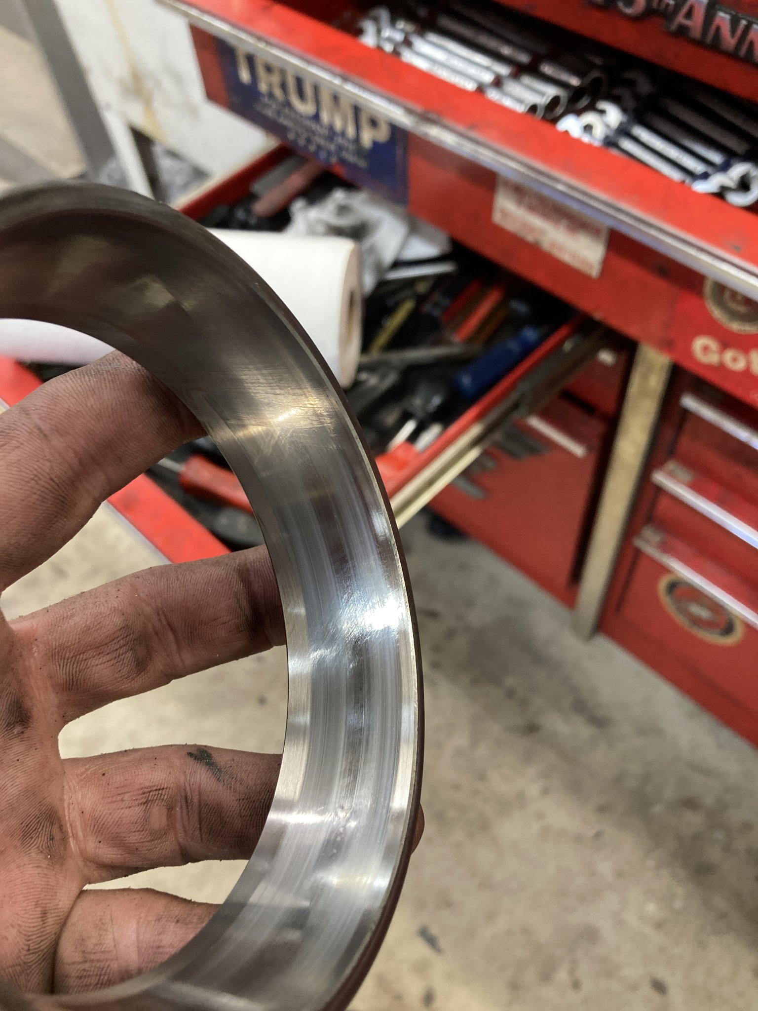

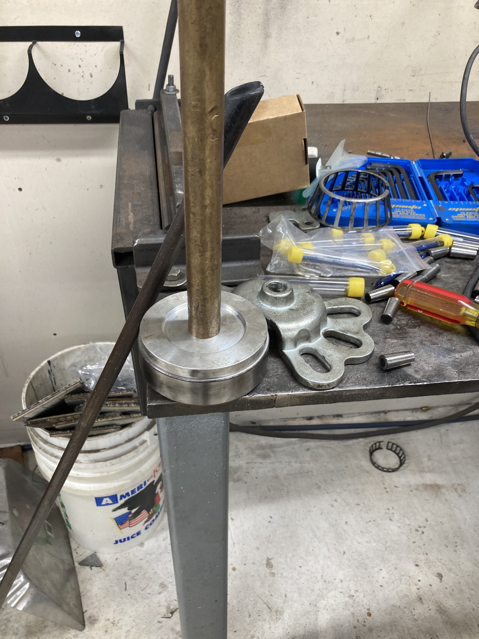

First the pinion race needs to be seated, both front and back.
Now my "major concern' here is that I do not want to "ding" or "damage" the new races by using the old "hardened races"
My preference is to use a "soft material" to seat them so that I don't chip/crack/break/damage the new race.
Have I ever told you how much I love having a lathe....... ;) (y)

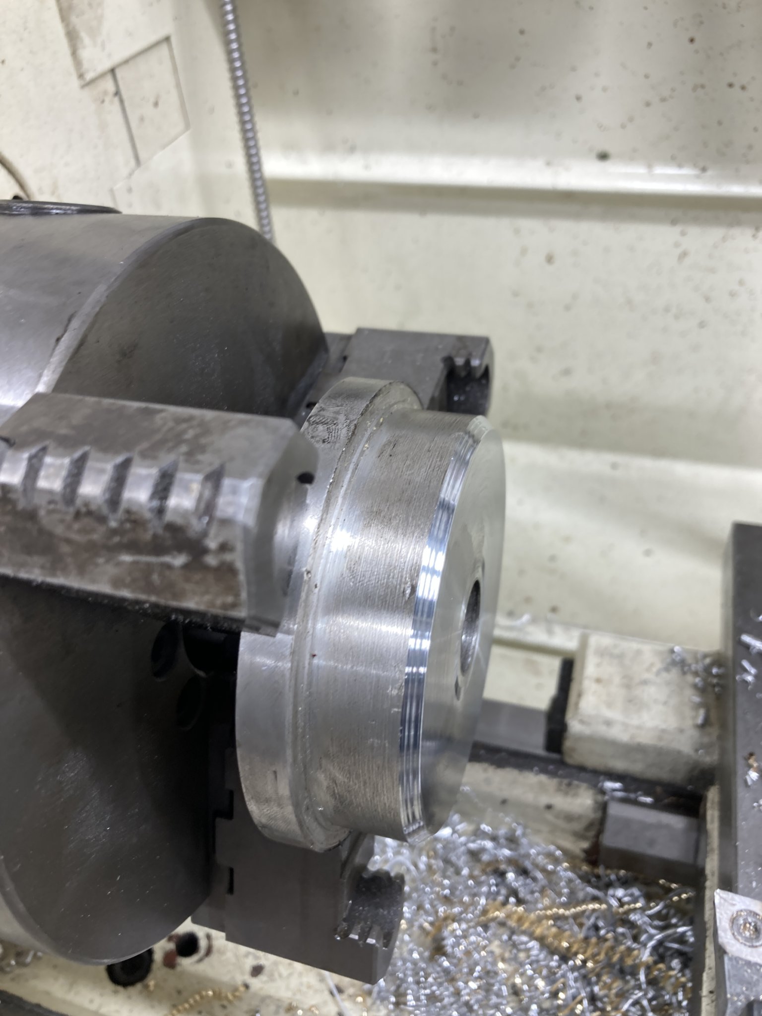

Yep, it's off to the scrap pile again to find some "donors to the cause"

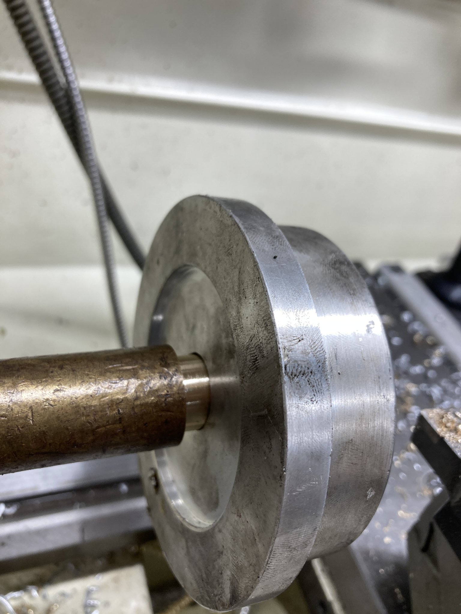

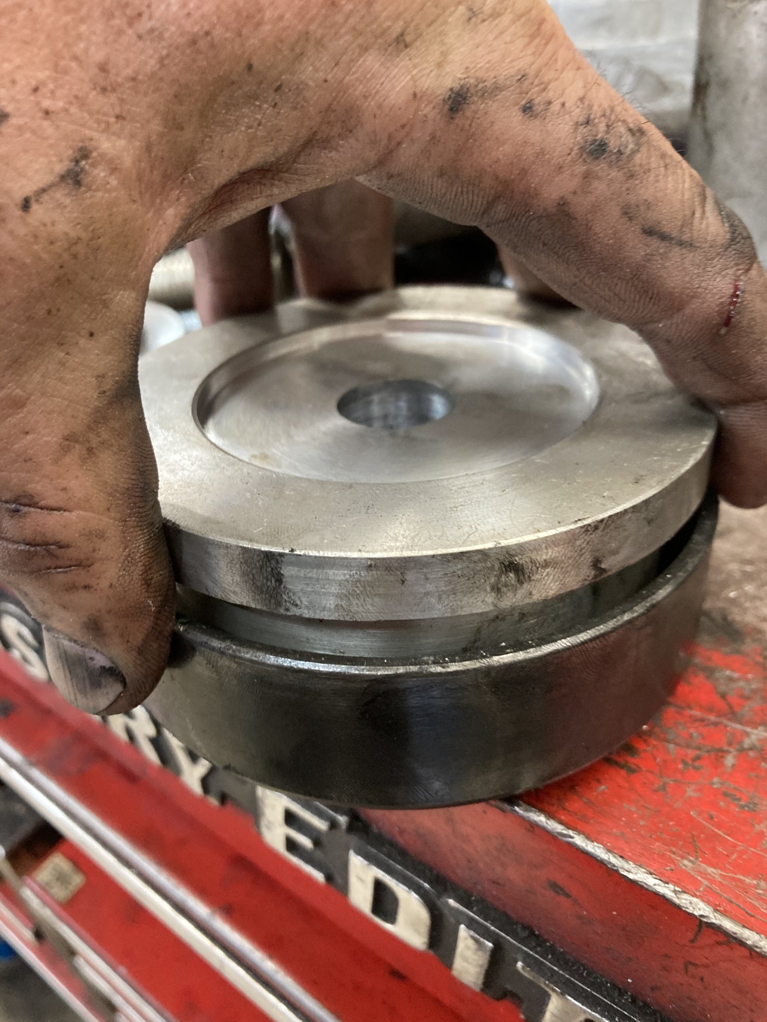

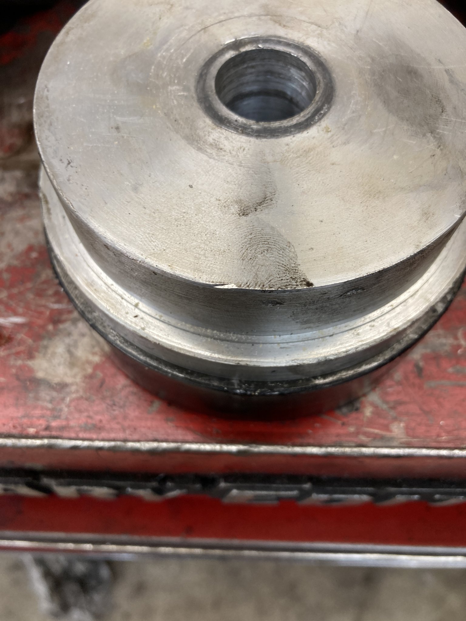

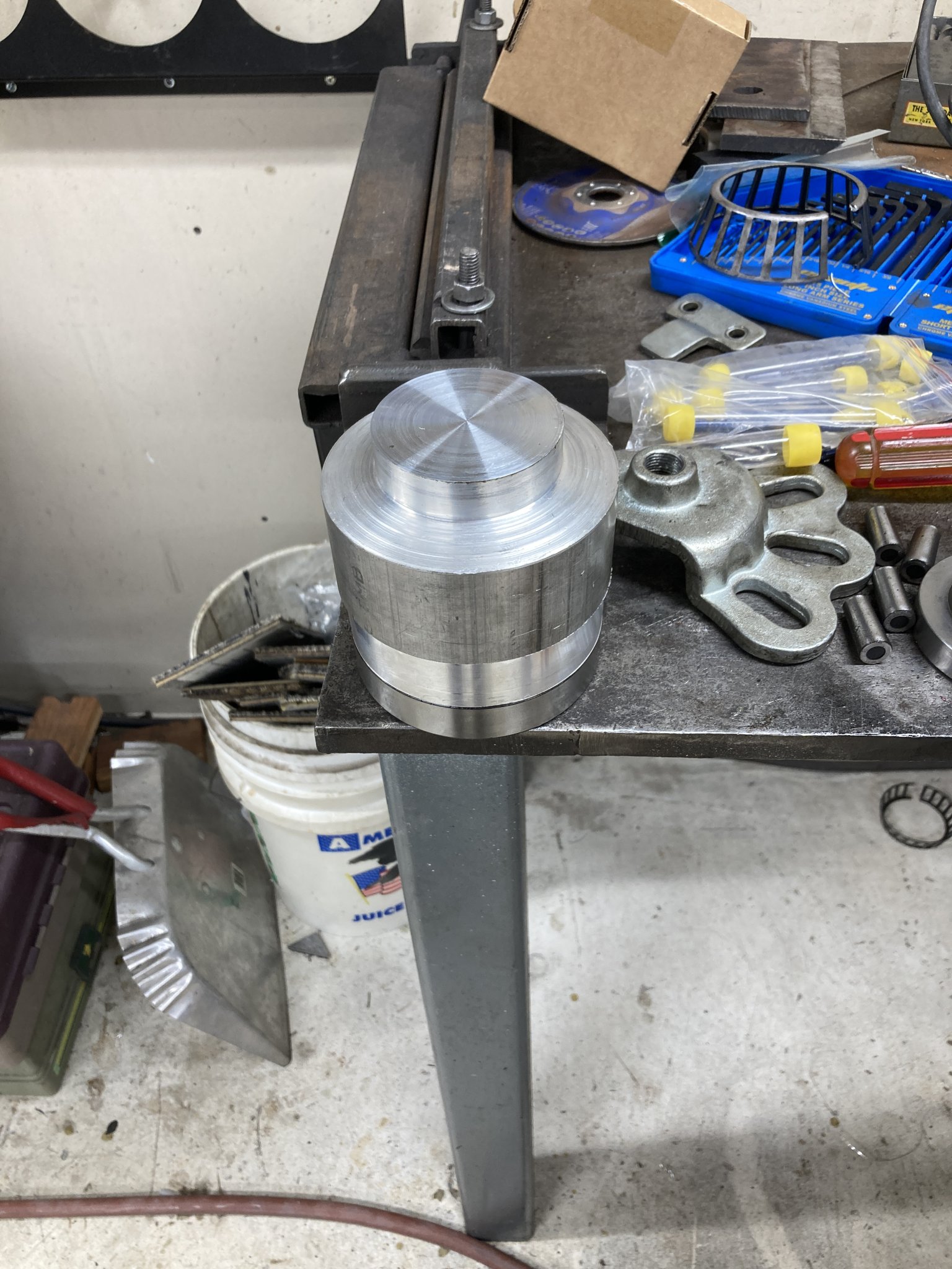

So here is the "punch die" I made for my CNC Plasma table drain. It worked great, but now it will "answer the call" for my "pinion race seater-beater" (the aluminum part anyway)
Hard to see in the pic, but it is nearly perfect, and should "trim down" nicely, and it already has a hole for the "thing you beat on" (Manderal? Punch?....having a brain fart now)
My "beater punch" does not fit it well, so from past experience, I could probably "get away with it", but I would like to have more control over it, so a tighter fit would be better.

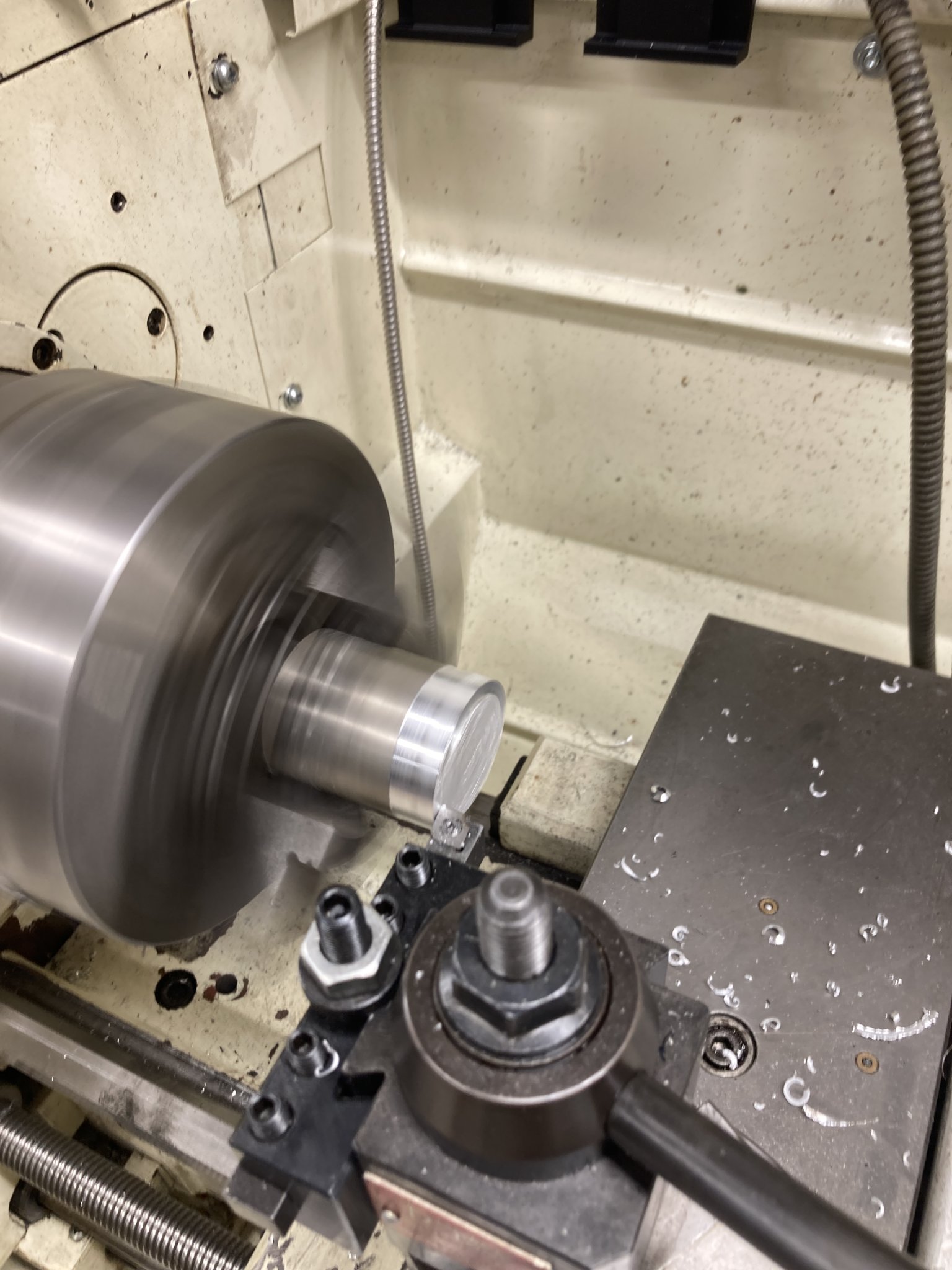

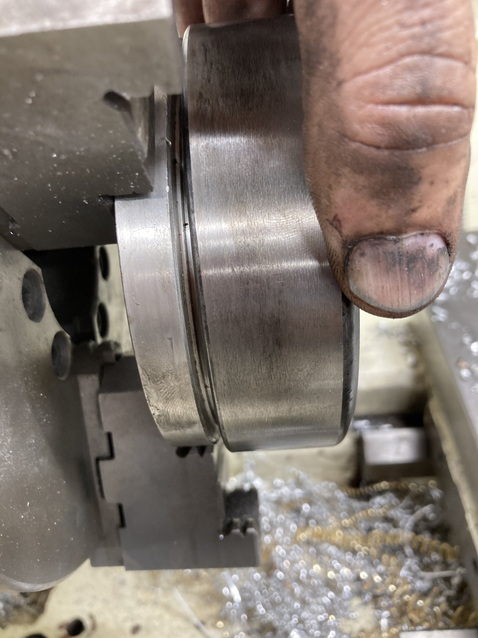

Flipping it over reveals a pretty good start. Just a few minutes on the lathe should be all that is needed.
Just to "taper it" a wee bit.
And BTW, now that I am thinking about it, THIS
is exactly why I keep all these seemingly "useless scraps" around.
I can't make that hole smaller, and I was going to make a "bushing" to make up for the difference, but I figured it would be faster/better to use my trusty old "big ass brass punch" .
Before
After
Now to "taper" it/ make it fit better.
FULL DISCLOSURE: I do not know how to taper something really. I kinda know the theory, but I can't recall how to do the math and stuff, so this is going to be "caveman tapering 101".
Please avert your eyes if you're a "real machinist"
I grab the carriage wheel, and the crosslide wheel, and try to "turn them both at once", creating a "quasi-taper".
Its ugly/brutish/not "the right way".....but it ends up working.
I must have forgotten to take a pic of the "final fitment" but it turn out pretty darn good.....
Here it is, 1 or 2 passes before the final pass.
3,292
4,154
A few "smacks" with the BFW, and she is seated.
Now for those you that are paying close attention, that race looks ....well...it looks used?????????
...............Yes, I F-----g installed the old race accidentally.......because I had been using it as a "template" and just "got caught up in the moment"
After a short cursing session, I knock that bitch out, and grab the new one and the BFH, and it goes in no problem......
The front is basically an identical process. I gotta make the tools and the "whole 9 yards"
Here is the finished product.
And yes, I installed the NEW race on the first try......🙂
Now for the "fun part".......Torquing that big ass crush sleeve.
For those of you that have never tried to torque a "crush sleeve", Well, it's tuff to explain.....
The best analogy I can come up with is this........."It is a cross between a The Worlds Strongest Man Competition, and performing Delicate Neurosurgry on a pitching ship.....during a hurricane"
You have to apply enormous forces to crush the sleeve, but you can only apply a turning force of a "few inch pounds" to the pinion.....and the "range" is typically VERY small.....
It is "stupid easy" to accidentally go over, and once you do, YOU ARE DOUBLE/TRIPLE F____ED!!!!!!! You have to get a new crush sleeve and start all over, there is no.... "oh thats close enough" in this game
You either hit it "dead nuts within spec" or you WILL be redoing the entire job in short order.
.......It's a slow/delicate and frustrating process sometimes.
For 15 bucks, I actually bought an "extra" crush sleeve, in case I go over, so I don't have to wait 2 days to get another one. .....And trust me....I have.

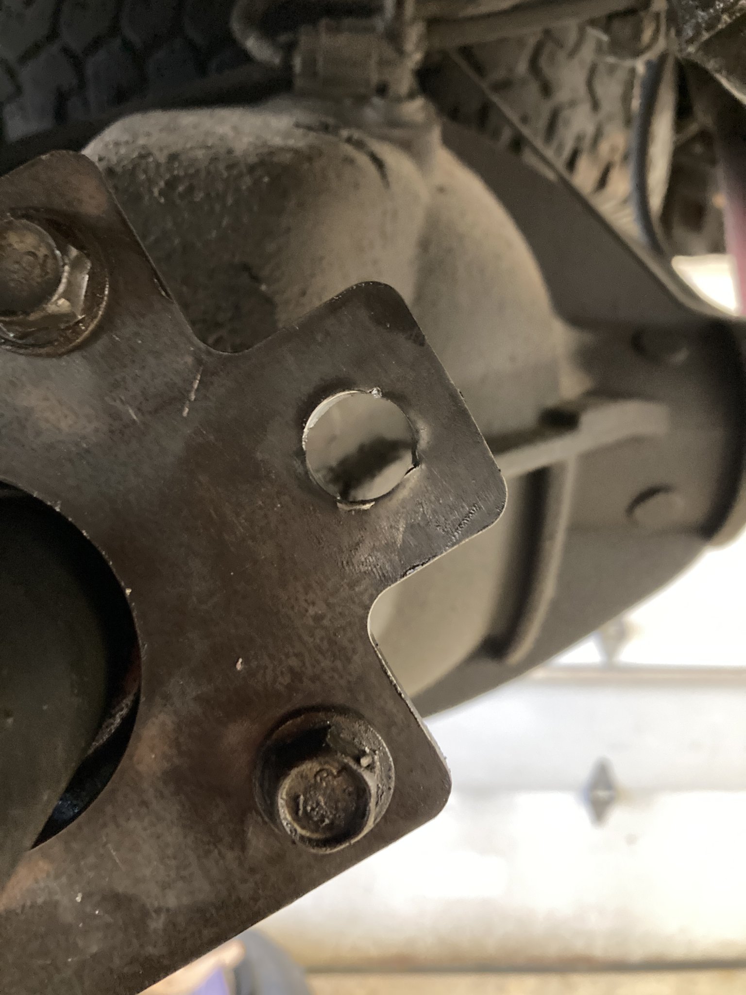

So first up, I attach my "new homemade" pinion tool, that I am "as proud as punch" that I made.
I took "painstaking" measure so make sure the "1/2" drive" cut out was PERFECT......This should be easy.....
Here it is with my breaker bar attached, so I grab my other breaker bar and start torquing the new pinion nut....
Hell......I don't even get the "slop" out of the pinion when this happens.
waaaa....waaaa....waaaa.........I rounded that "sum -bitch" off so fast "it made my head spin" (whatever that means)
I'm down, but not out. It's late in the 4th quarter....no time outs, and as hot as "2 rats screwing in a wool sock", but I "Marine on".........
I decide that a "combat fix" is in order, so I take the "newly ruined" pinion tool off, and head down to the shop.
In the scrape pile I find a piece of "black pipe"......This will do it.
I fire up the Tig machine and water cooled torch, and have a "go at it".
Here is the other side.
This "Bad M__________R" aint going nowhere!!!!!!!!!!
So I tighten her up, giving it all I have.......

But I feel my shoulder about to pop, so I back off and decide I need "leverage"
So I slide the black pipe into an "old aluminum fence post", then prop it up against the starboard side rear spring.
Pretty ingenious if I do say so myself.....🧐
I try hanging off that breaker bar, but no dice........
I find another piece of "fence post" and put it on the breaker bar, and commence to "swinging like an ape" from it........
The only thing that happens is that I split the damn thin aluminum post, and fall on my ass, and it nearly punctures my fuel tank.
hard to see, but it's split pretty good.
Here is the "gouge" in the tank.......I sure "dodged a bullet" on this.....
"M------------r C____________________R DAMNIT ASLL TO HELL AND BACK!!!!!!!!!!!!!! AGGGGHHHHHHHH"

In a "controlled rage"........ I am looking around the shop for "ideas".
I need a longer, stronger "pipe" for leverage....Yea thats it.....More leverage......
Then I spot my other "tall jack stand" and BAM, it hits me like a falling boulder.
Take out the "spinny part" and us the tube.
Now I slip that pipe over the breaker bar and........................Here it is
"The Masterpiece of Hillbilly Engineering"
But being the "safety conscious" guy I am, I grab my "blast shield" so that if/when it "lets loose", I wont have to make a trip to the ER....or my dentist.
So there I am, swinging on that thing like a "fat chimpanzee", when after a few minutes/seconds it begins to MOVE!!!!!!
YAY....I FINALLY DID IT....I BEAT "THE MAN"
Well then "Mother Reality" shows up and "Bitch-Slaps" me across the room.........
It turns out that all I did was bend that F'ing pipe.........
Dejected/ disappointed,/mad/pissed off/angry/enraged and ........."sweating like a whore in church"
I decide to "throw in the towel"..........................

The 1960s Mercedes car axles I worked on were made in a similar fashion. The crush sleeves required about 300Nm initially.
You truck axle is way bigger, but the way I look at it you applied easily 1200-1500Nm torque in your tank puncturing attempt.
I have the feeling something is wrong here. Is it the correct slieve? Is some washer sitting on an edge somewhere preventing the sleeve from being compressed (seen that on a car, ex factory, wheel bearing had 3mm axial play)?

As I sit there, sulking somewhat, I know that I am "neck deep" in this. It HAS to get done.
No BS, no excuses, no matter what, this thing is going to get done.
I have the knowledge, the tools and the drive.......Now i just gotta get the "muscles" :giggle:
Aside from jumping in my "Time Machine" and going back to 1998, the only alternative is going to be a mechanical one.
It is at this point that I decide to buy a "Torque Multiplier" . I have heard of these things, but only in passing. I have never actually seen/touched/used one yet.
After some thought, it is the best/safest route to go, and I figure, "What the hell, I like tools, so besides the money, there is no real downside"...............So it's off to the Big A to order this bad boy.....
There are a few different kinds, and many of them are geared towards "A semi's lug nuts".....at least that is what many/most of the pictures show in their ad's.
I decided that although this one was 2-3X the price of those others, it seemed the most appropriate to my situation.
So here is another 3 day set back.......But it (and the 3/4 drive socket) arrive on time, and soon I'm back in the "sweat box".........
Oh yea, I forgot to point out that Michigan is experienceing some of the hottest weather of the year, BUT ONLY on the days I am in the shop.......The other days when I am waiting for parts/tools, it's nice and cool...:cool:
I forgot to take pics of the rear, but here is one from doing the front that shows the set-up.
Here is the "new and improved Homemade pinion holder"
This one ain't going "nowhere".......(I hope)
So you need 3 hands to work that Torque Multiplier, (TM) but after some doing, that thing worked FANTASTIC!!!!!
I had to install and remove that "torque setup' about 15-20 times to keep checking the pinion pre-load....But I do not want to "go over" so it is worth the extra hassle to "creep up on it"
Man that TM was the BOMB.......I would turn that pinion nut "literally a millimeter" at a time, with almost no effort, then check it........Rinse and repeat........
The specs for my axle were between 30 and 45 inch pounds, and I F'ing NAILED it at 42 inch pounds
Aside: My personal preference is to set things up on the "tighter end" of the specs. My "Theory" is that after a little wear/break in they will settle somewhere in the middle of the specs......Although I have no proof that this actually happens.....In my mind it does......
I was so happy I must have forgotten to take a pic.
Now its time to reassemble and set the backlash.
So I "lay out" my "rolly cart" (just a habit that helps me focus, and organize for reassembly)
Hefting that thing was all I could do, but shortly afterward, it's time to check the "back lash"
Now for me personally, this is where the "art form" meets "the science/numbers".
I have to kind of "tighten and adjust" as I go......If tightening one bolt make the numbers go "catywampus" , I loosen it up and try another combo, always "slowly tightening & checking".
After 20+ years it's a slow process, but I eventually nail it.
The "back lash" specs for my particiar axle are .004" to .007" (it's a 2 cut, not a 5 cut)
After a while I get it to about .005'ish
I tried to get to .004", but settled on about .005" ish
Now its just a matter of making a "press tool" for the outer axle bearing races, and "Slapping her together"
