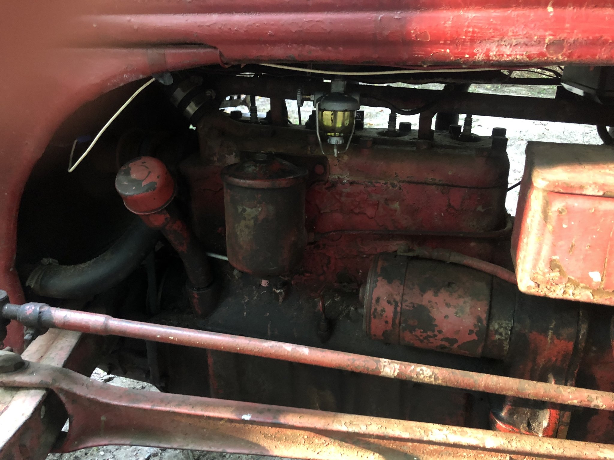

I vaguely recall posting about the JB Weld repair to a crack in the water jacket on this Ford 2N, 9N, 8N with a Ferguson hood junkyard compilation I grew up with. My father had repaired the crack with some sort of epoxy like substance when he bought the part with the engine a couple years before I was born. Whatever that was failed when I was a teenager. Started weeping noticeably. I was tasked with cleaning it up and repairing the crack with JB Weld. Job specs required it not leak; appearance irrelevant. After chipping off the old, failed whatever prior sealant was on it, a wire brush on a drill and brake cleaner got it ready for the JB Weld.
If you zoom in on the side of the block in the below pic, I think you can see the side of the block looks sort of melted. That’s my not very pretty slathering of copious amounts of JB Weld over the damaged area. Would have been in the 1979 to 1982 range. Don’t recall exactly.

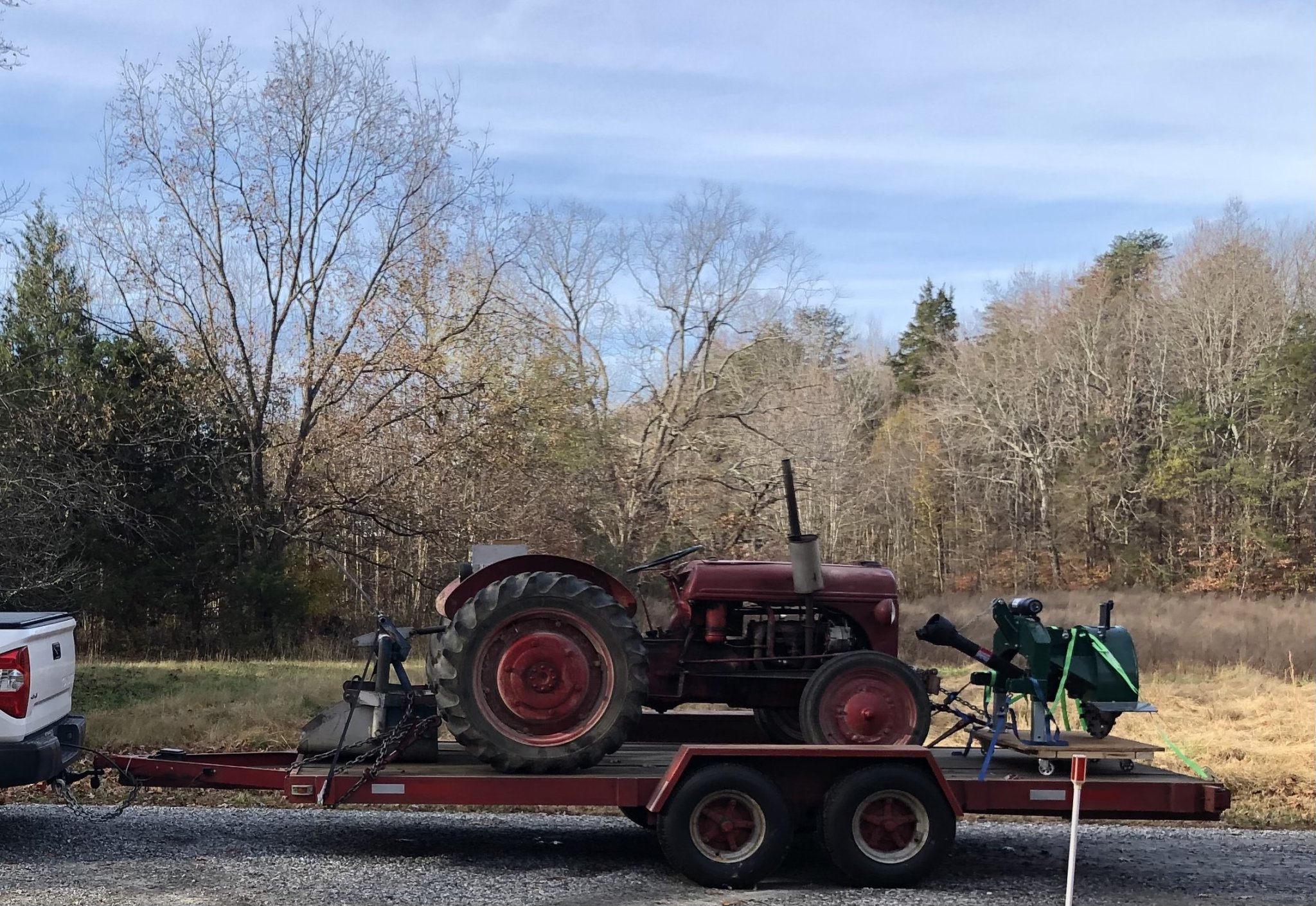

This was the last day I saw it. November 2022. Loaded up to head to a new home. Still ran perfectly well. My ugly JB Weld crack repair was still holding water.
