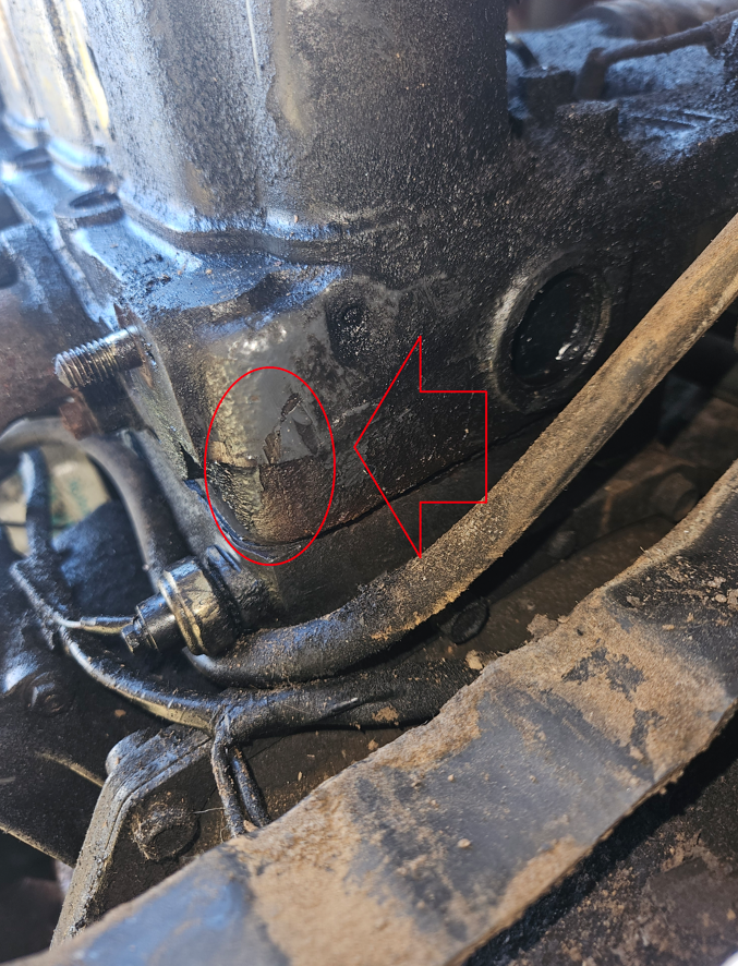

I took some more pictures so you can better place the crack. I whiped it down, used vinegar to clean off any residue and rust, and then used a steel wheel Dremal brush to get a better clean all over it, then I used a torch to burn off anything around it. I did this a few times trying to get it as clean as I could.
Here's a few pictures:
Here's a better picture of the crack after I whiped it down with some vinegar:
It does come from underneath though so it's a bit worse than it looks. Not a lot... but enough that it's gonna count.
Here's a zoomed out view I took after I removed the fuel tank:
Here's a picture after a bit of cleaning, you can start to see it more clearly:
And... here's a picture of my probably laughable attempt to patch this thing up. Not the prettiest but I did try to get a nice even glob spread all around the area:
I'll let that sit for a day or two and then we'll see what's what.

That's just a head crack.
aand it's more than likely only external.
If you pull the head you could get it fixed properly and never have an issue again.

He would need to pull the head to do that repair, but that crack might be repairable, would need to see the bottom of the head.

I'm thinking his JB weld fix is going to work. Waiting for an update

Welp...
Good and bad.
So far the JB is holding... but it's hardly a good enough test. I only let it run for a short while so it'll take putting it to work for a couple days before I think the patch will hold for any amount of time. I took a picture of the patched crack while running but it's kinda pointless to post it. It's just the same picture, it's dry and not leaking at the crack area.

While that crack has been dealt with (even if just for the moment) I'm not out of the woods yet. Found at least one more maybe-serious spot.
Here's a backed away picture to place the spot:
Here's a couple pictures of the same spot zoomed in on it:
Looks like this isn't held in flush and it should be?

It looks like the 2nd leak is from a pushed out freeze plug. I wonder if like you said your engine froze solid and that’s what could have cracked it?
