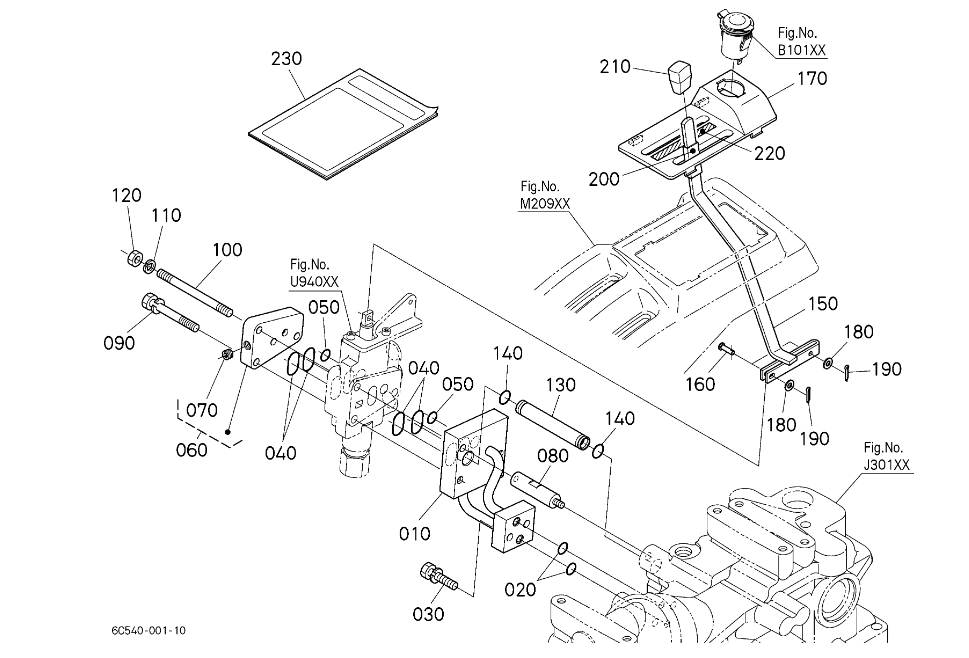

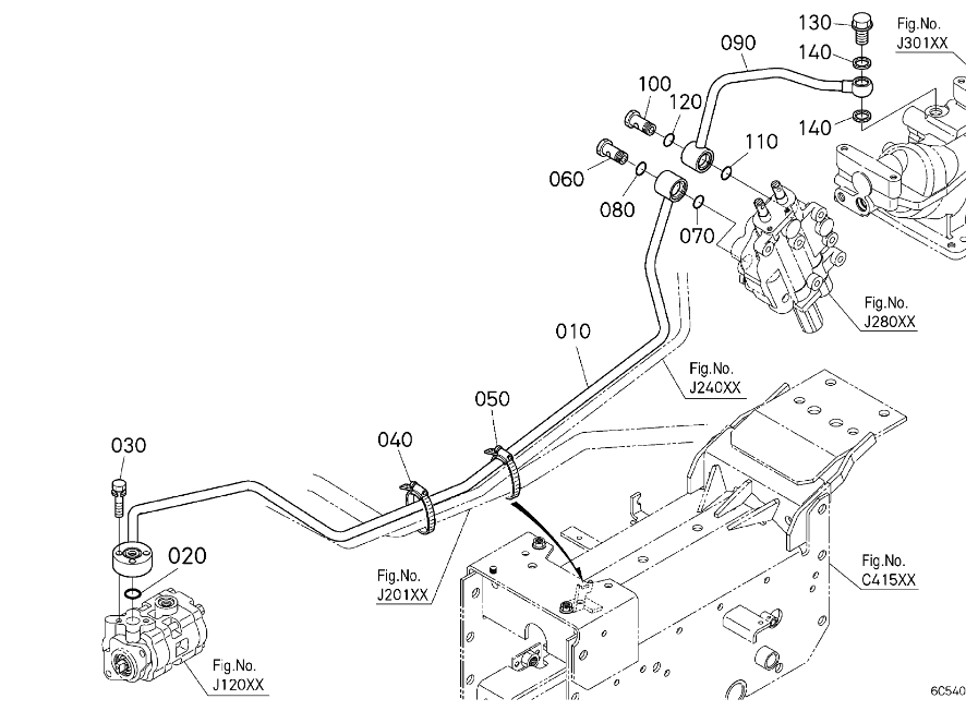

The man has a B2601. There is no simple pickup point other than the loader valve. His tractor setup is typical of current Kubota designs,
Top parts diagram is the adapter block for the B2601 factory remotes. It provides pressure out to a Kubota specific sectional valve and pressure return to the 3pt (item 10). A second pipe (item 130) completes the tank return. It is not "simple" and and there is no easy way to use that boss on the transmission with an after market valve. At a minimum you would have to make your own adapter block and then run three hoses to it from your valve. I could do that - most people can not.
Picking up pressure from the loader valve is simple - see second diagram. All you do is remove the little power beyond pipe (90) from the loader valve and replace it with two hoses. That's just a couple banjo to JIC fittings that anyone can handle. Then you find a place for the tank return. The port on the side of the transmission (item 140 in OEM remotes diagram) would be my suggestion and probably the hardest parpart.
Edit: Just realized he is hooking up a hoe so all he needs is the two pressure lines. Even easier.

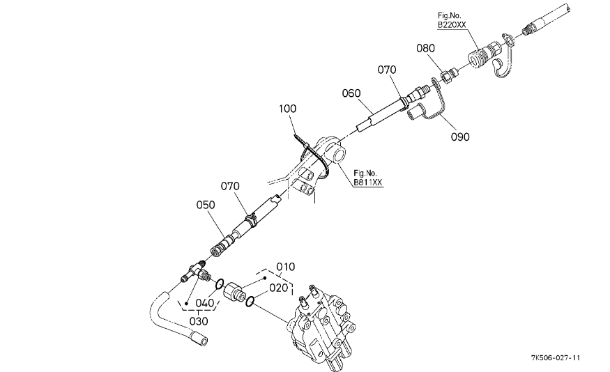

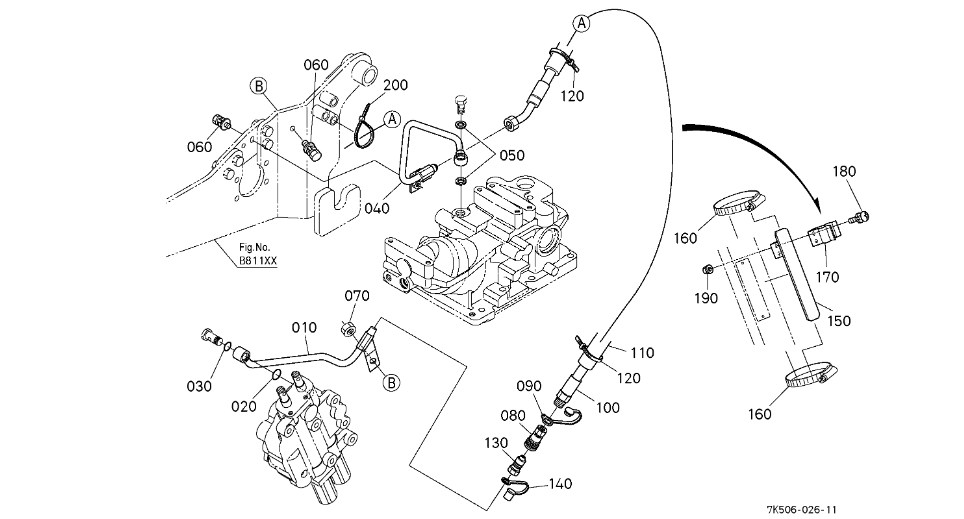

This discussion got me interested so I did some poking in the parts diagrams. It appears Kubota's current strategy (last couple decades) with backhoe plumbing is somewhat schizophrenic.
  1. On tractors where the rear remotes are plumbed with hoses coming off the loader valve (e.g. older B series and all standard L's) the backhoes are installed in the power beyond circuit after the rear remote valves and the backhoe tank return goes to the pressure return outlet on the tractor. In other words the backhoe valve is not configured for high pressure carry over (power beyond) because the 3pt is the only downstream valve and it is disabled when the hoe is mounted.
  2. On some tractors where the rear remotes are plumbed directly off a boss on the transmission housing the backhoe is plumbed with hoses coming off the loader valve (B01) and winds up ahead of the remotes in the power beyond circuit. Because the remotes could still be used with the backhoe mounted these configurations use a backhoe valve configured for high pressure carry over.
  3. On the current Grand L 60's the backhoe is plumbed off a boss on the 3pt lift cover which places it after the rear remote valves and before the 3pt valve. In this configuration the backhoe valve is not configured for high pressure carry over (power beyond) and uses two hoses to connect to the tractor.
To summarize:
  1. When the backhoe pressure take off is after ALL factory auxiliary valve options on the tractor the backhoe uses a vanilla open center valve and returns to the 3pt valve.
  2. When the backhoe pressure takeoff is ahead of ONE or MORE factory auxiliary valves the backhoe uses an open center valve with high pressure carry over to the remotes/3pt and and a separate tank return.
Since the original question was how to plumb a 3rd party hoe on a B2601 here are the relevant diagrams. The B01 factory remotes (if present) are installed on a transmission boss between the loader valve and the 3pt. The loader valve power beyond port is used for the pressure takeoff and pressure return is to a boss ahead of the remotes - top diagram. If the factory remotes are or ever will be present a third tank return would be needed - second diagram.
B2601/BH70 Pressure Takeoff/Return
B2601/BH70 Tank Return
Top parts diagram is the adapter block for the B2601 factory remotes. It provides pressure out to a Kubota specific sectional valve and pressure return to the 3pt (item 10). A second pipe (item 130) completes the tank return. It is not "simple" and and there is no easy way to use that boss on the transmission with an after market valve. At a minimum you would have to make your own adapter block and then run three hoses to it from your valve. I could do that - most people can not. View attachment 84016

In reference to the above diagram item (90) is the magical port/tube? I then remove said item and put in JIC fittings in lieu where (100 and 130) go correct? Do you know where the pressure comes from versus the return? Does pressure come from the side of item (100) or (130)? Guess I will find out when I hook it up and read the pressure gauge on the BH itself. If no pressure just swap the lines.
Does anyone have a parts manual then so I can see what size items 100 and 130 so I can get the JIC fittings and hoses made?

Pressure comes from the loader valve and goes to the inlet side of the loader valve. Its likely the one with the pressure gauge and may be labeled P.
You need to remove both banjo bolts and measure the diameter of the threads. They will almost surely be BSPP threads. WAG is 3/8 BSPP which measures .825. 1/4 BSPP would measure .515.
