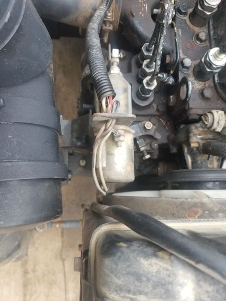

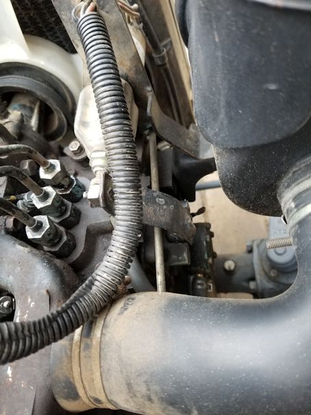

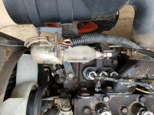

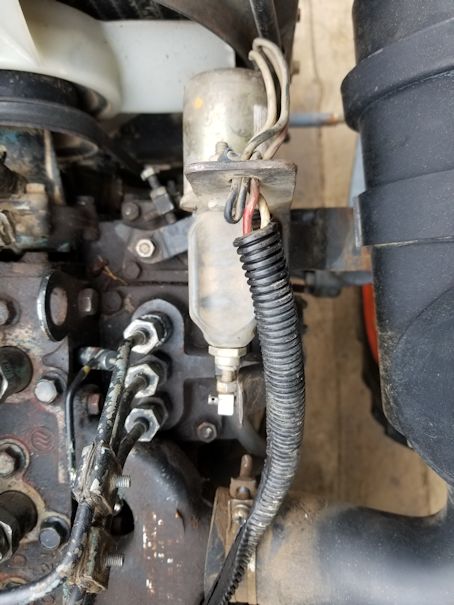

Here is a picture of my solenoid setup, it's tight but it works perfectly.
Pulled in is run
There was a stock solenoid on it mounted much lower, bit I think I couldn't use it due to the radiator placement, but not sure, it's been like that for the last 5 years I think.
It's a three wire solenoid, Ground, Pull in, and Hold.
It's pulled in by the starter and held in buy the switch, you need to a diode on the hold side or it lock on and will not shut off, I think it's because of the way the charging system works. ;)
