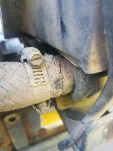

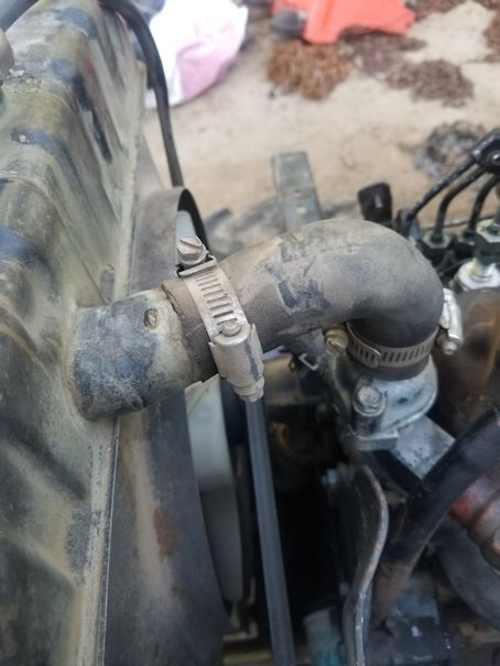

Pictures as your going will help us help you if something doesn't work right.
This is the radiator connections, compare them to yours now and you'll see they are shorter and smaller and at different angles.

Sorry for the crappy photos. I can't really get a a camera in there to get a good shot of it. But, I can move the pedal about 1/4 through its travel before the fork even begins to contact the sleeve. It looks like the adjustment is pretty far out right now, and there's just not enough travel left before the arm hits the stop once the fork makes contact.
I'm going to get the cooling system figured out first, and then try welding some material on the clutch fork to make up the difference.
