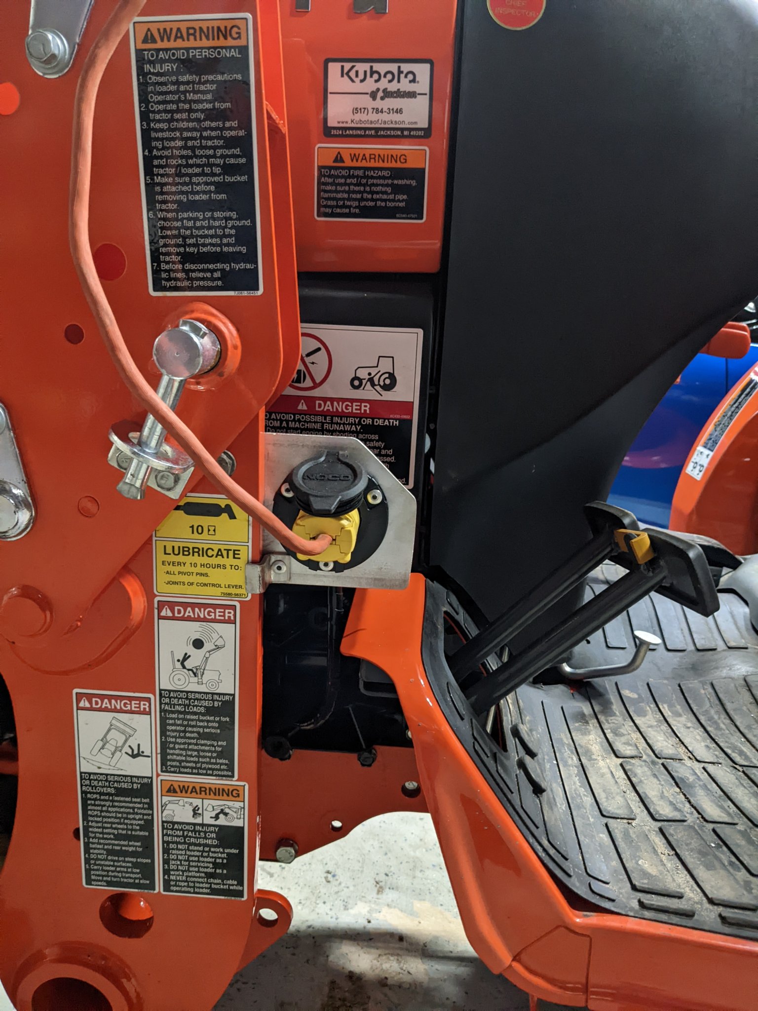

I'm in Mid Michigan and it rarely gets below -10c in my barn where I keep my LX2610. But on this on as well as my old B7510 I have always had a block heater connected to a Wi-Fi controlled plug. That way I can turn on the block heater before I head out to the barn. usually 45 - 60 minutes is plenty to get the block up to about 40c. I have the block heater not because I'm worried about it starting. I have it because cold starts are about the hardest thing you can do to "abuse" the motor. Just thing with oil super cold how long it takes to get to all of the bearings and the valve train....
The $90 it cost me for the block heater and the handy plug I mounted on the side of the tractor will likely work out to a lot more hours I get out of the motor before it gets worn out. Just my $.02
The $90 it cost me for the block heater and the handy plug I mounted on the side of the tractor will likely work out to a lot more hours I get out of the motor before it gets worn out. Just my $.02 View attachment 73342
Thank you for this reply and picture. I will be adding a block heater and WiFi plug soon. In the meantime I will be using my makeshift tent heater to minimize damage from cold weather starting. The local forecast is calling for a few more nights down to -35C (-31F), so I had better get it right.
