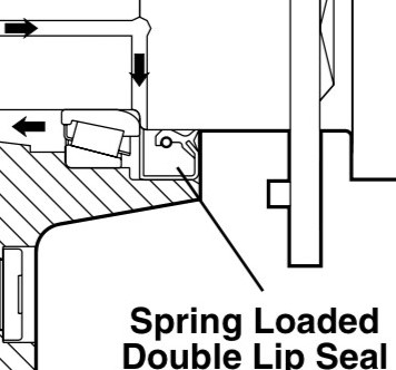

That is the only way to service the trailer bearings and inspect the brakes, this EZ-Lube nonsense is just a sales gimmick for those that like to ignore proper maintenance. In PA, and I suppose some other states. the brakes need to be inspected every year. How would you like to pull the hub with that tube of grease making a mess?
The axle manufacturers have been producing a incorrect design for many years, look at their drawing and you will see virtually no shoulder for the rear bearing cup to contact. I did actual measurements and found that there are some with no shoulder when considering tolerances. Now consider the grease being pumped in right where that poor contact is and filling the seal with grease and then pushing thru to the brakes. In addition, how long do you thing the proper bearing clearance will be in tolerance with this faulty design? Just one more reason to do it right and forget the grease zerk B.S.

I sorta have to disagree. Well, at least on my 4 Dexter axles. The EZ Lube has worked very well for many years. That picture is not an engineering drawing. The grease seal is designed so that interior pressure forces the lip tighter to the spindle. This is how the Bering Buddy maintains a water tight seal. It's also how a mess can happen because too much pressure will invert the lip and it will never seal right again.
They say the seal should be replaced any time the drum/ hub is removed. I'm guilty of not doing that, and never had grease on my brakes. Every few cycles I'll do it though. The grease in the hub stays put. Clean off the spindle before re mounting the hub and the seal shouldn't "squeegee" the grease off (and onto the brakes).
However, Its easy to set the seal too deep in the bore which could affect the seal- ability of the seal.

I currently only have 5 Dexter axles, but I have had many more. I pulled trailers thru 48 states and a number of provinces. The picture is the one posted above and is reasonably accurate. I layed out the hubs in AutoCAD using actual measurements and engineering drawings, so that I could understand exactly what I was dealing with. Those that want to trust this junk to luck, all I can say is Good Luck.
