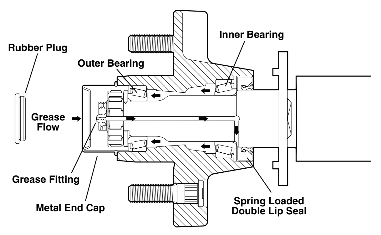

I found this article with a nice drawing that some might find helpful.
That picture shows exactly why the hub should be turned as grease is injected. The port at the inboard side is only a single 3mm (or so) hole. The holes on my 7500 lb axles are pretty small. If it's not turned, the new grease only purges through the bottom couple rollers. I learned by watching my dad do this in the 80's with boat trailers.
For those not familiar, a pressurized bearing cap (Bearing Buddy) is only a cap and can be added to most any hub. They are IMHO a waste if not submerging the axle. Especially since they should be removed annually to purge the entire hub as in the Dexter video.
