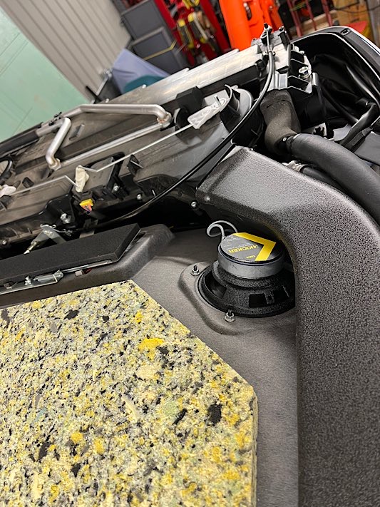

Thanks to Maine Farmer I got my radio in yesterday. I initially bought a harness from my dealer but noticed it only used 6 pins (on the 9 pin plug). I figured I needed at least 7 so ordered another via eBay. Turns out the Kubota OEM radio plug for Grand L’s doesn’t use the constant 12V pin, maybe the Kubota Jensen radios have a battery or something to keep station presets?
Anyway, things went great and installed the Kicker speakers too, really makes a difference.
