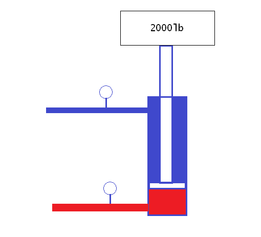

Now allow me to use a cylinder example to illustrate my point a bit further.
The piston in this diagram is 2" in diameter and the rod is 1" in diameter. This cylinder was pressurized on the base (red) end to raise the 2000 pound load while the rod (blue) end was open to atmosphere then both rod and base end were sealed. At this point the cylinder is completely filled with oil and the pressure gauge on the base end reads 636 PSI and the rod end gauge reads 0 PSI. That's using your arithmetic.
The double acting cylinder is allowed to sit for 24 hours and when we come back both gauges now read 2,546 PSI and the weight has not moved. What happened and how did I arrive at the new pressure?
