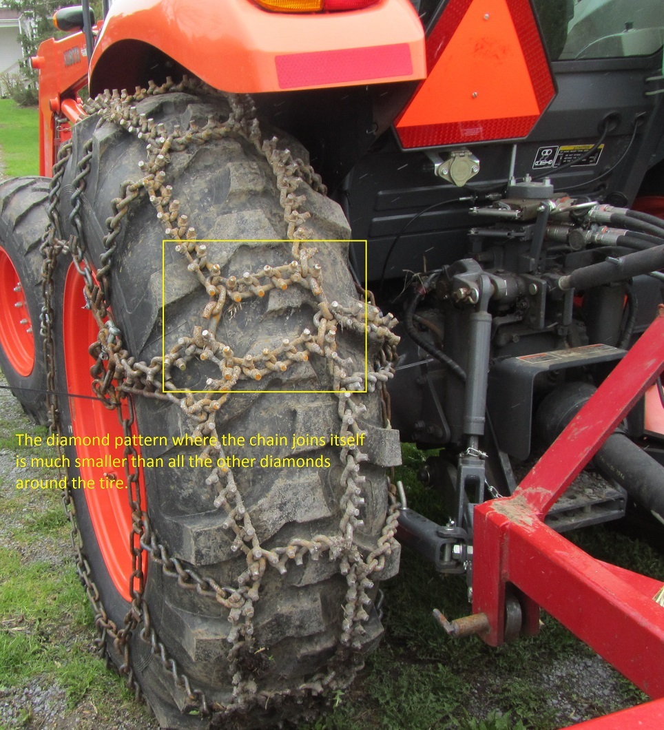

With these style of chains you need to be buying them from a dealer who will stand behind their fit.
With a brand new M7040 with 16.9 x 28 R4 tires I thought chain fit would be simple. Trygg advertised their product as not needing any fitting to work.
When I installed them, the diamond pattern you see in your posted photo overlapped. i.e. the chains were too long.
In the end it turned out that the tires on the new tractor were 3" smaller in diameter than the Tire and Rim association spec. 3" in diameter meant 9" too long in length.
Kubota took no responsibility.
Fortunately for me TRYGG stepped up, had me ship the chains to one of their distributors in Canada who rebuilt them to fit the dimensions of the tires I had.
A good price from China on a set of chains which do not fit properly will mean decades of frustration for you.

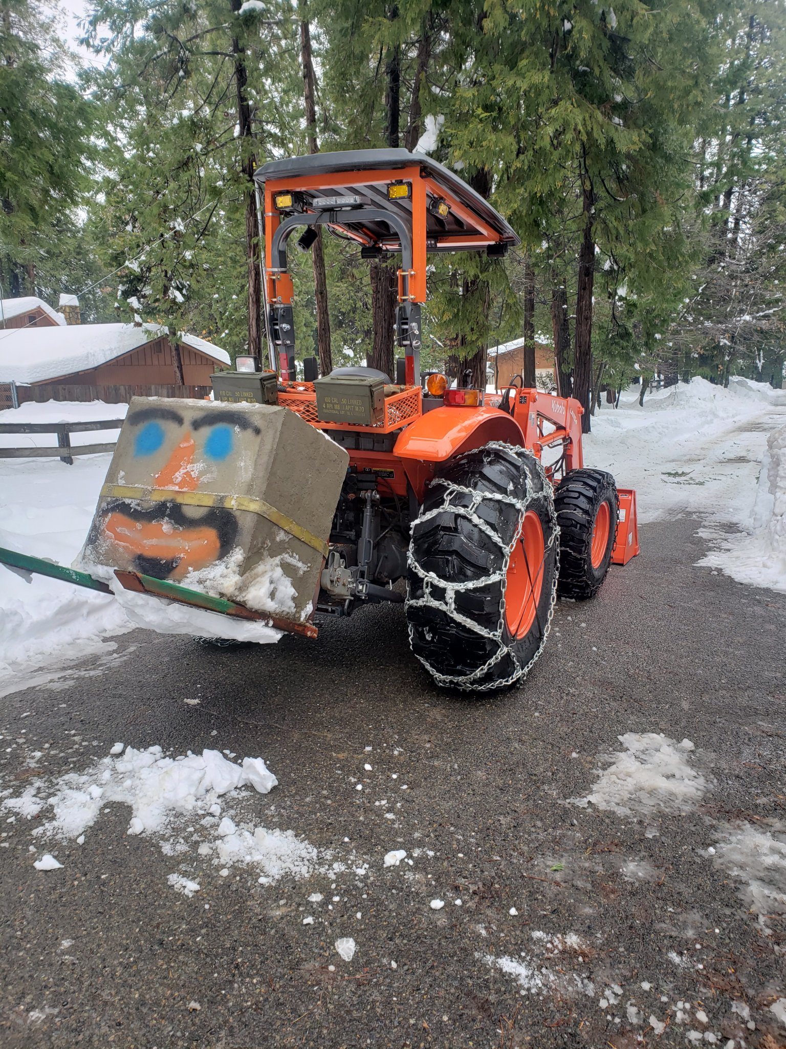

I went to my local auto and truck parts store yesterday and got a set of Duo chains for my m6060. $900 made by General chain. Ill install them today.

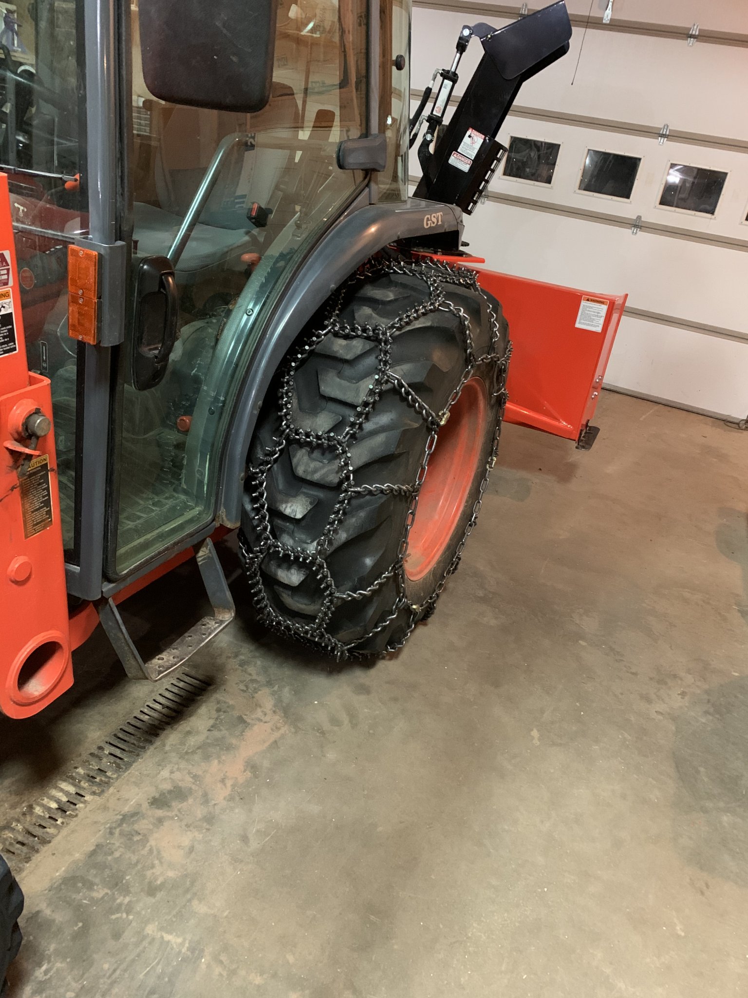

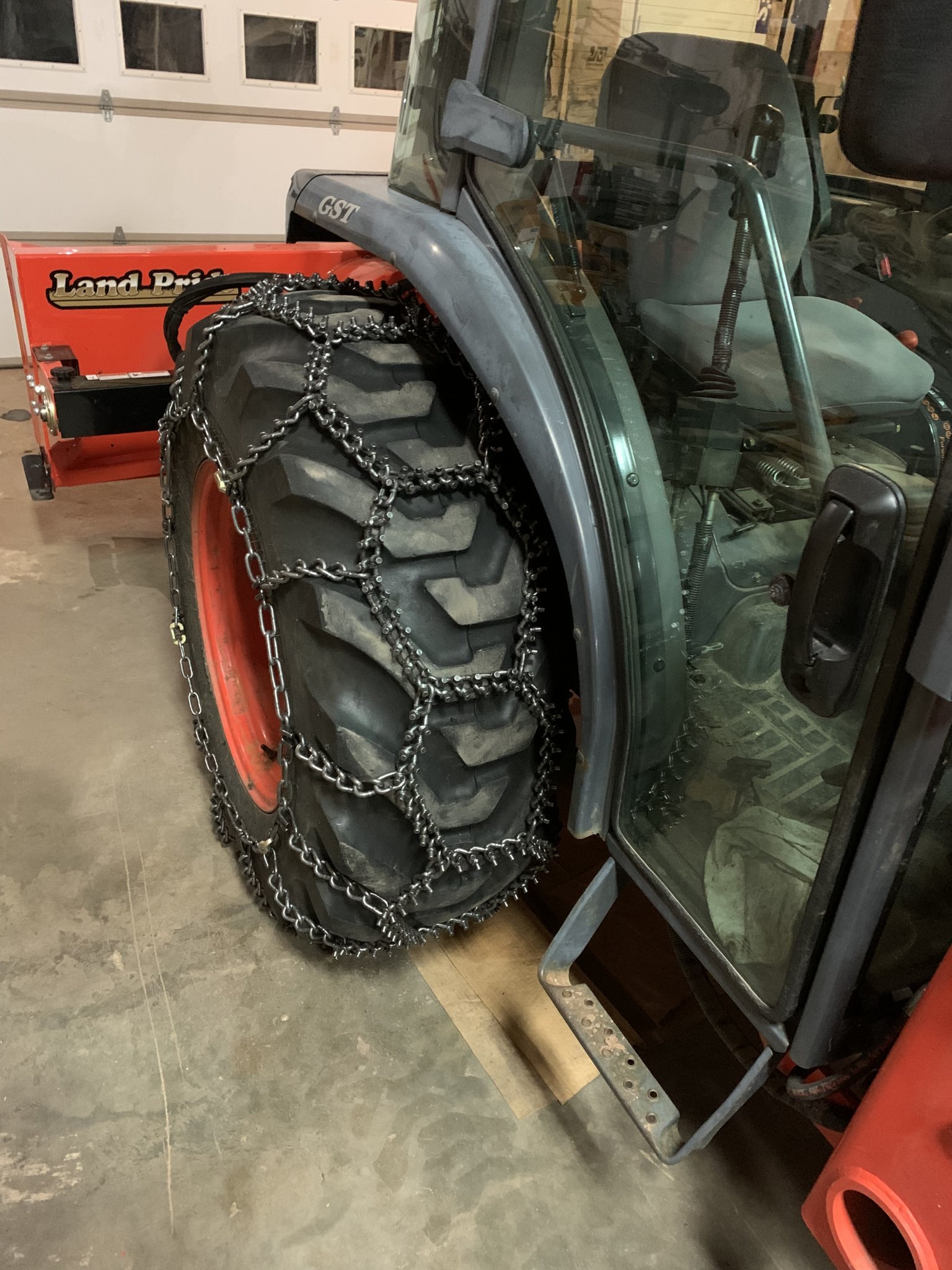

Happy New Year. Chains came today and I was able to get them installed. They were long so I had to make a few cuts. It went pretty smooth. Did some blowing and plowing, a g huge improvement! Thanks to everyone who ofered suggestions.

Great job installing those chains! Do you have a picture of the section where the ends meet? Just wondering how that transition point looks. You mentioned having to make some adjustments to get the fit to your satisfaction.
Your installation pictures look like they should be an advertisement for the chain manufacturer!
