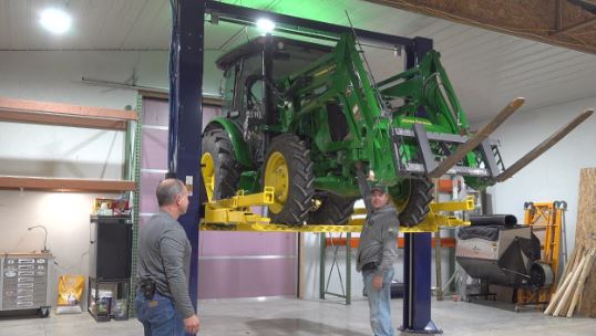

I'm setting up a storage / maintenance shop close to home and plan to use it for personal service and storage of vehicles, equipment and other toys. My son and I enjoy service and car projects. I have been doing some recent investigation in to purchasing a car lift that allows me to work on cars, trucks but also would allow me to do my tractor, UTV, ATV maintenance.
I got to the point where I thought I would need both a 2 post lift and a 4 post lift. 2 post for most vehicle work and 4 post for tractor and other work. As I looked closer at the 4 post lifts it quickly became apparent that with the short wheel base of my tractors it was hard to find a 4 post lift that would be safely rated to lift my tractors as the runway capacity quickly diminishes as wheelbase decreases.
I decided to buy a 2 post 12,000 lb rated lift and started to think could I find a way to use my car / truck lift to safely work on my tractors and other equipment. As I looked a little further I found a product called Turf Rail - www.turfrail.com
It is a fully adjustable frame / carriage that can be used with larger 2 post lifts to allow you to lift anything up to 7,000lbs, this is a great idea and will allow me to just have one heavy duty 2 post lift that will cover all my vehicle needs (Diesel GMC 3500 pick up down to small car) and with the Turf Rail addition I can work on my MX, L series tractors and all my other off road equipment.
Anybody own or use one of these Turf Rail lifting adaptors? Here is a photo showing the Turf Rail product in use. Sorry for the wrong color tractor below!

Nice gadget but I am not sure i would have much need for lifting any of my tractors. I do have a two post but its asymmetric and it seems like that system only works with symetric lifts. Plus it costs more than the lift.

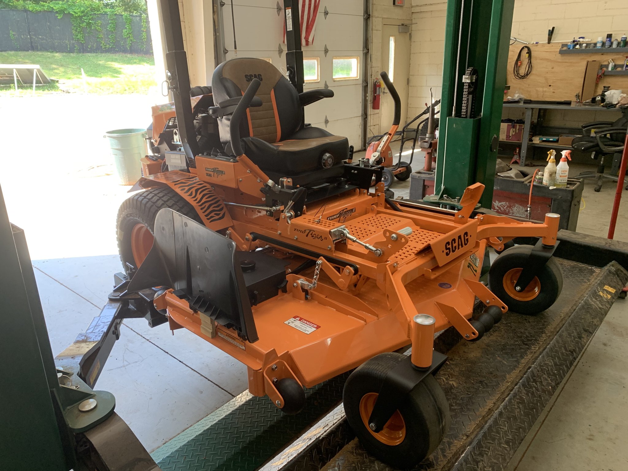

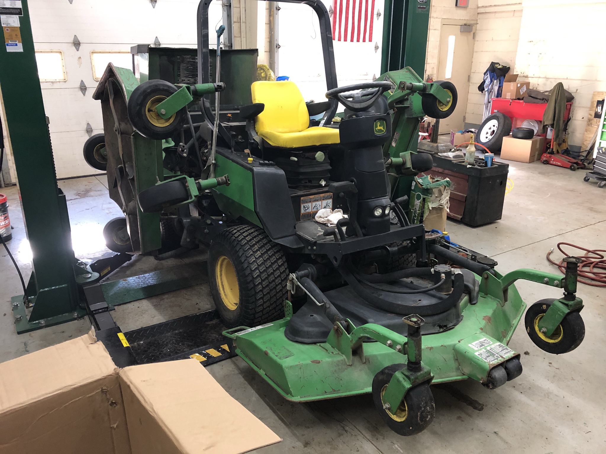

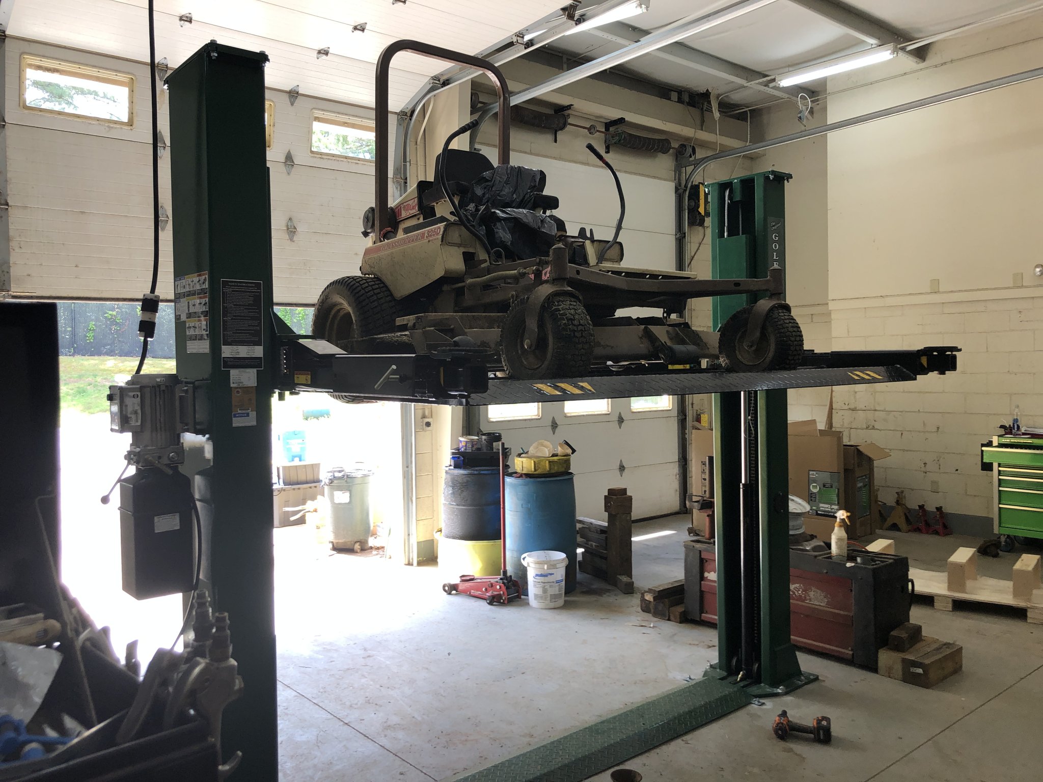

I have a Golf brand at work with their turf kit. It is a bit different than the 2 tray like above.
I needed max versatility, as you can see, I have a lot of different types of equipment to work on.
Dan,
You are correct, it is for use on a 2 post symmetric lift setup. As far as cost goes, I wish I would have purchased a lift 5 years ago, they were a fraction of the price of what they are today! Nothing is cheap anymore. I'm fortunate that budget is not my key consideration. Quality shop time with my son is a pleasure and is priceless.
As you said it is one of the best tool investments you made, I'm a year younger than you were and looking to free up from work and pursue things I like a little more.
I'm buying a 12,000 lb ALI certified lift for vehicle use, it is an expensive investment and the add on Turf Rail just adds to the cost. As far as being a gadget, I personally have a lot of equipment that it will allow me to lift safely and do service / maintenance work on, someone came up with a good idea that solves the dilemma of how to use a 2 post lift to work on everything from a snow blower, atv, utv, lawn tractor up to a 7,000lb tractor.
There are other solutions that are much simpler and a fraction of the cost to adapt 2 post lifts but most of them are aimed at the 1,000 lb lawn tractor market. I'll be happy to see my friends and my sons friends when they need to use a lift.
