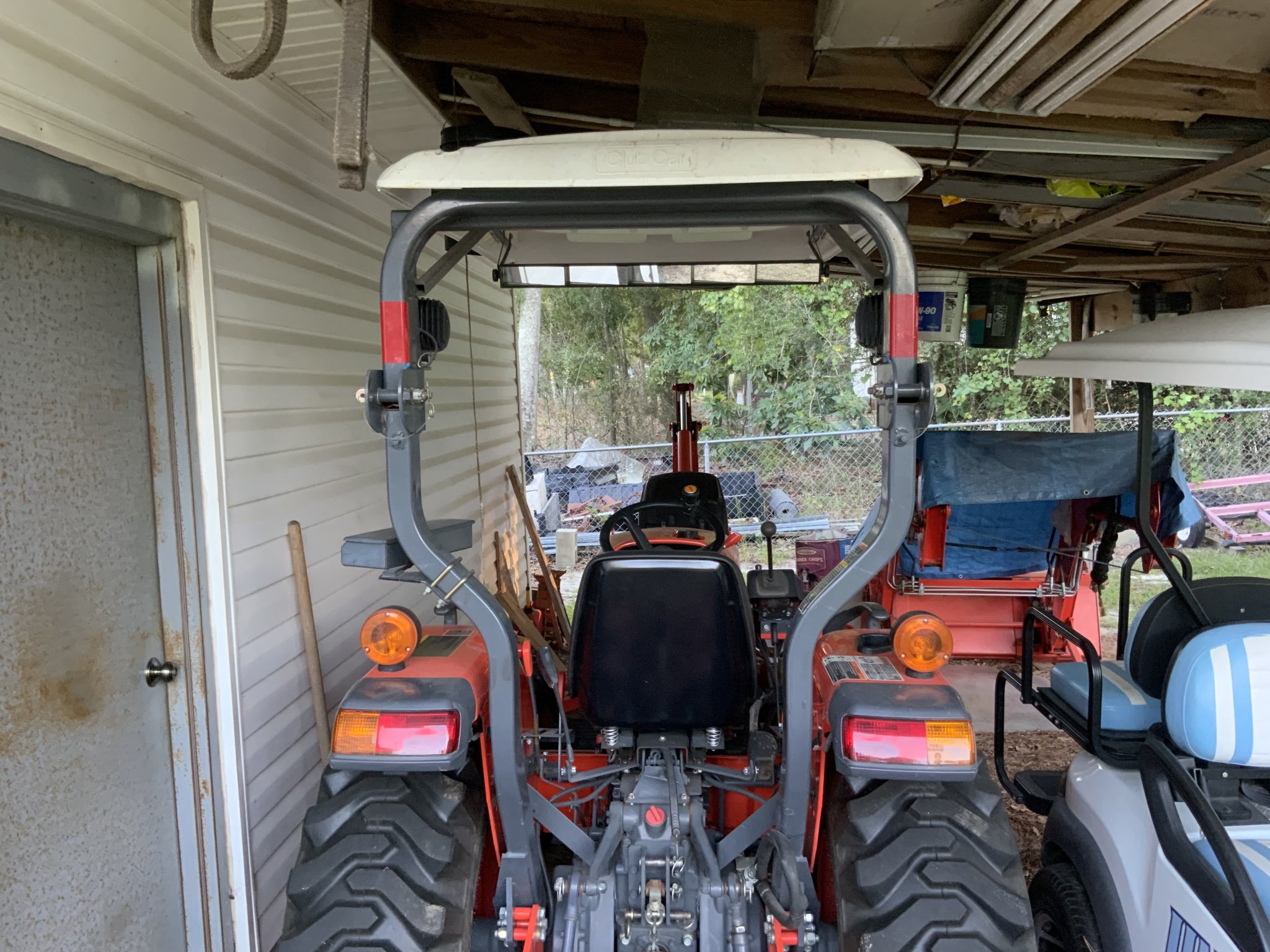

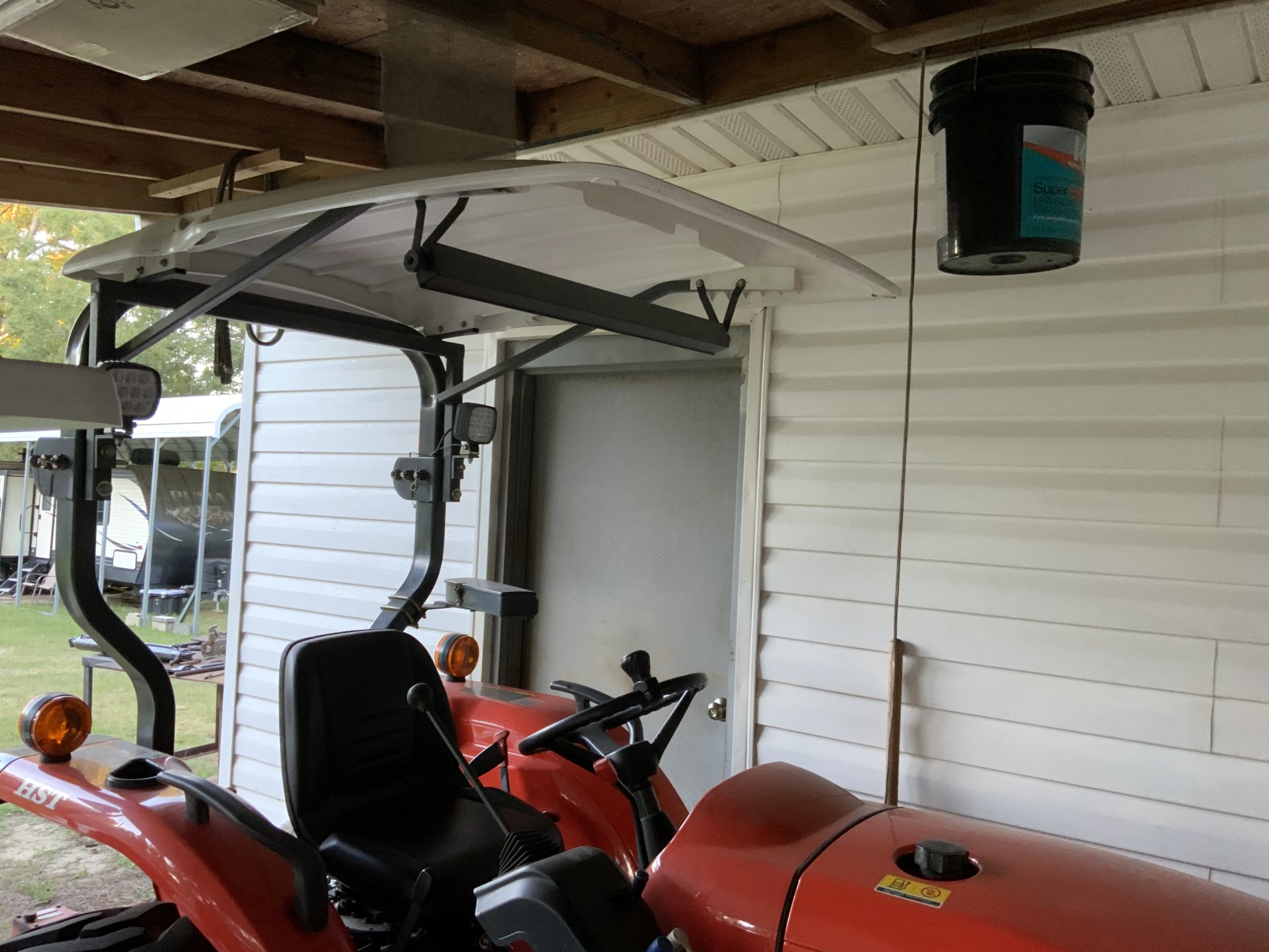

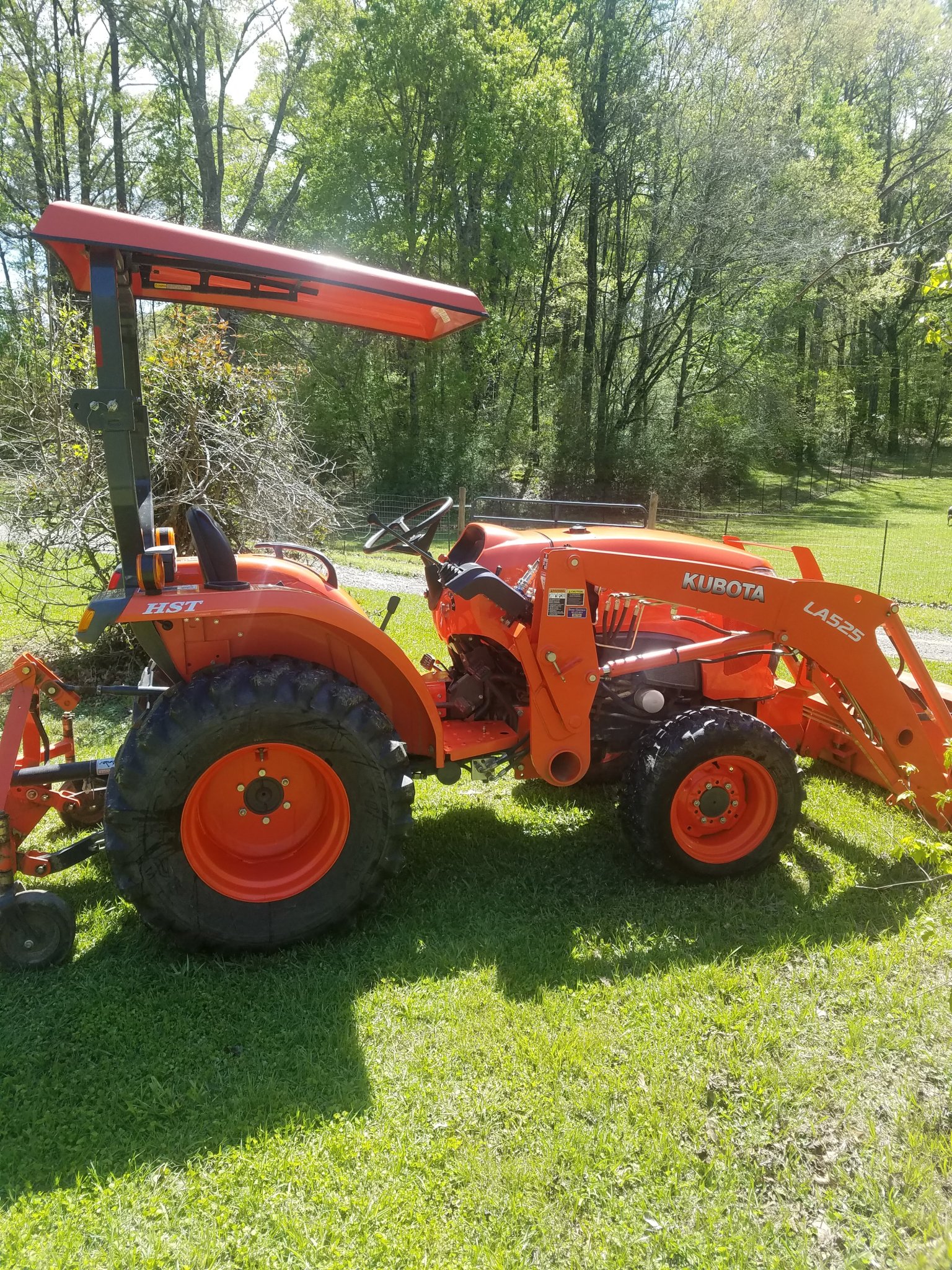

This is what I made it is a club car ds top I made the frame and attached it to the ropes using the existing holes where you would fold the rops also made a great place to mount the led lights also added a golf cart mirror

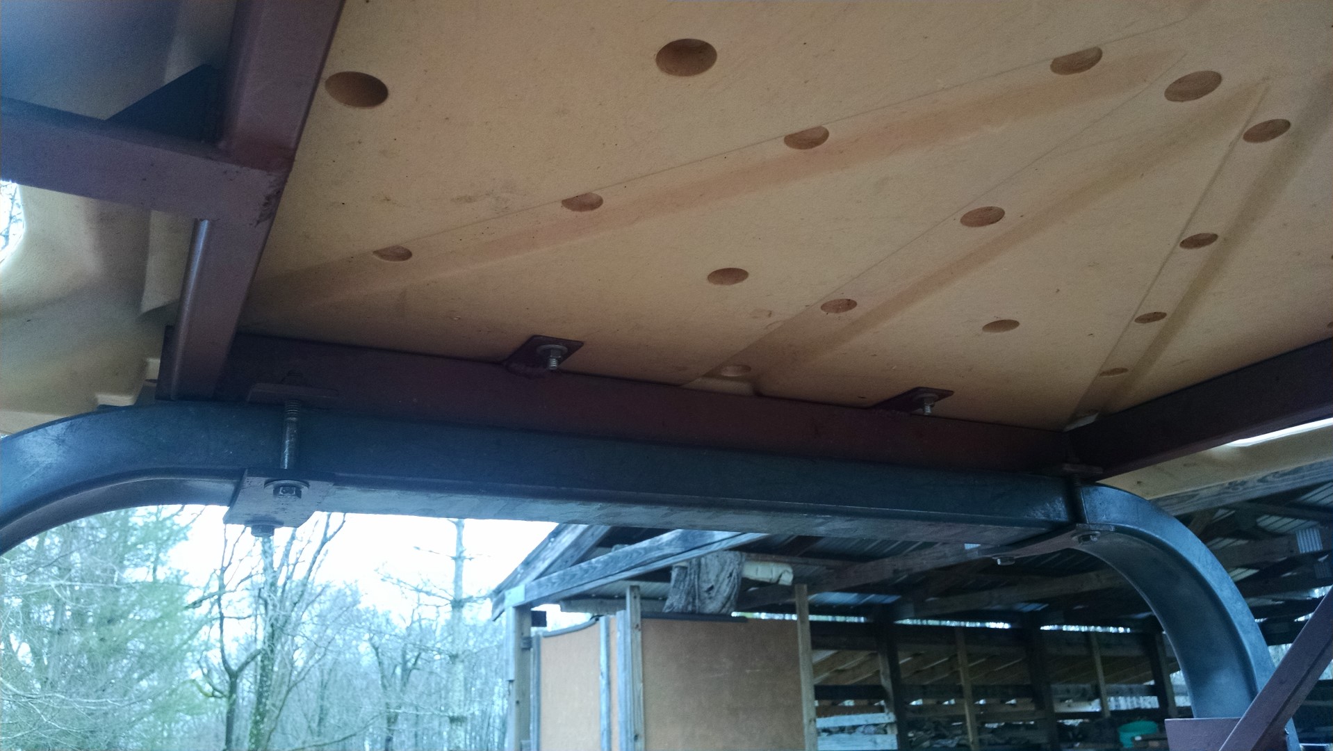

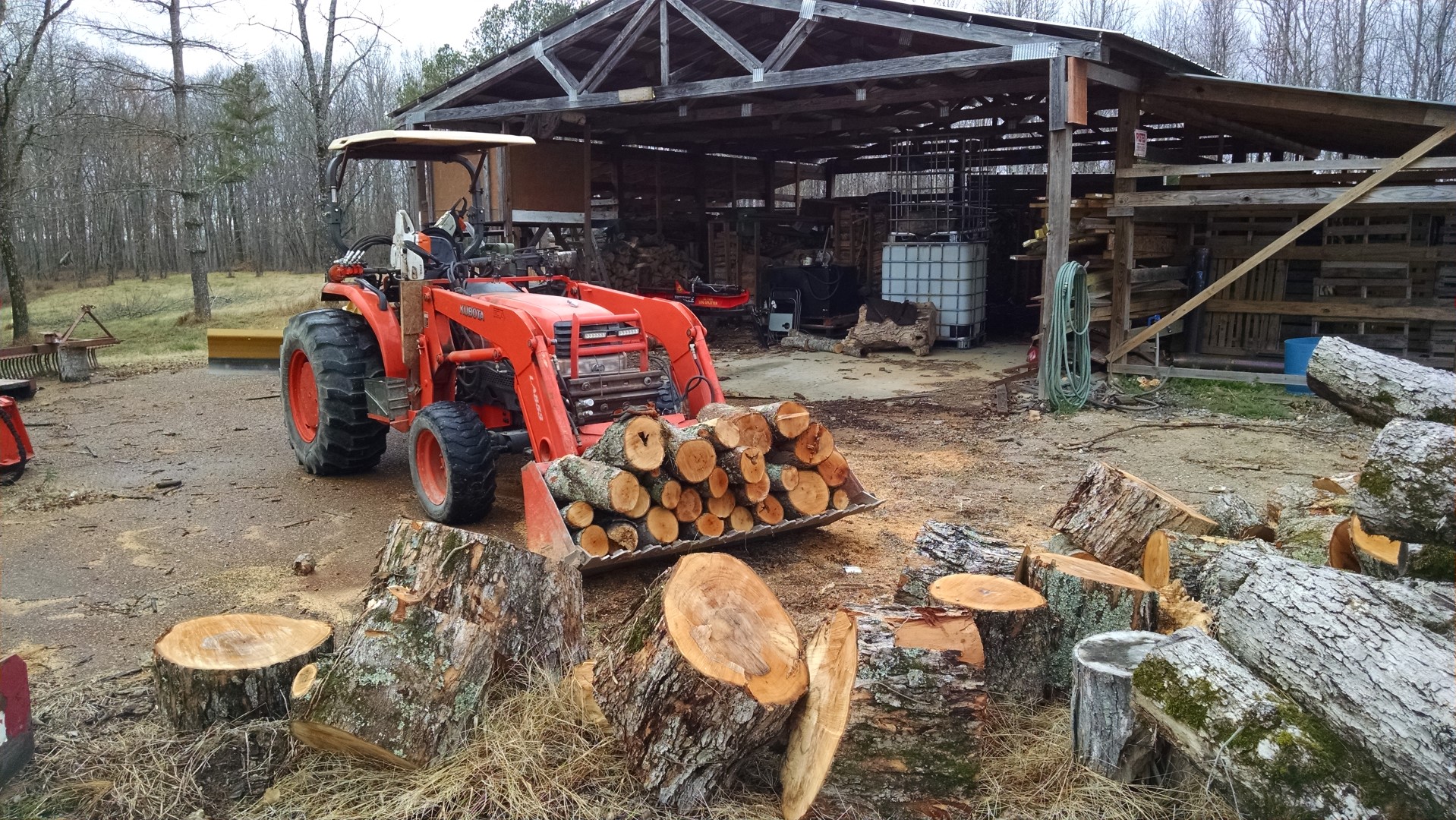

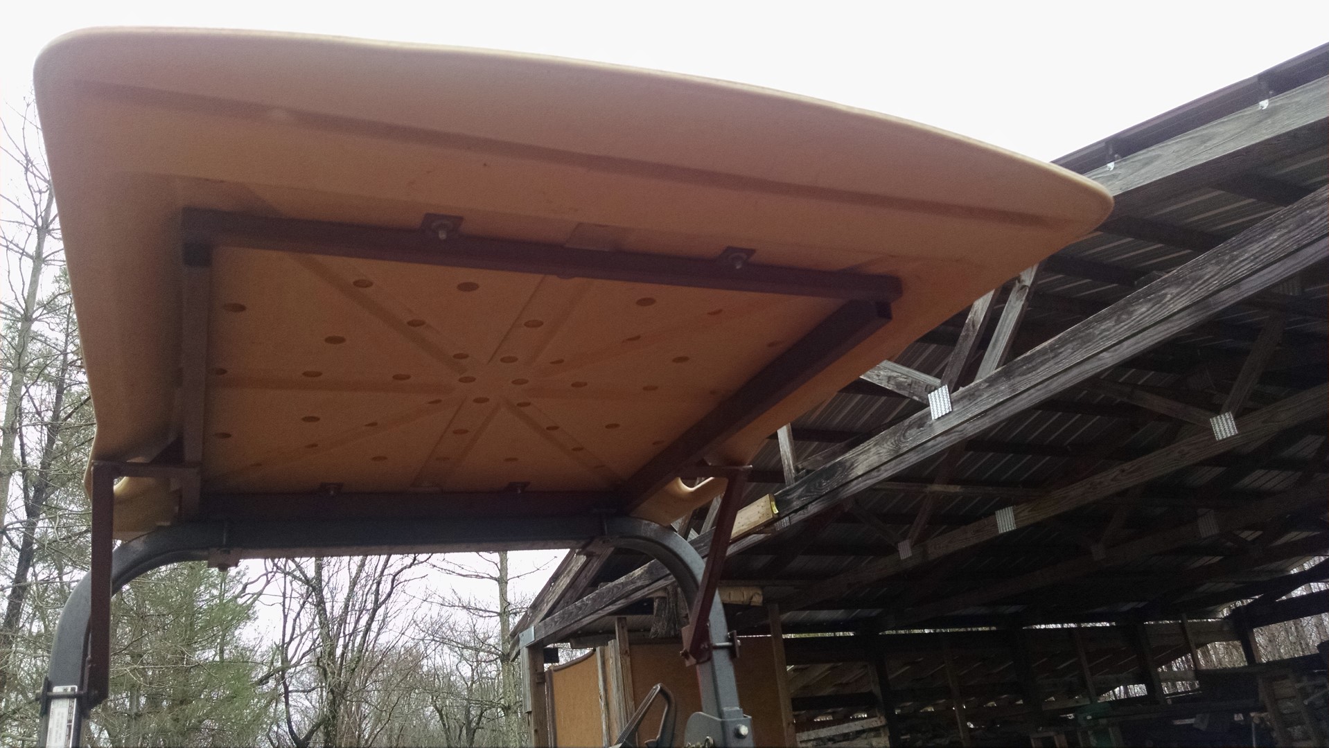

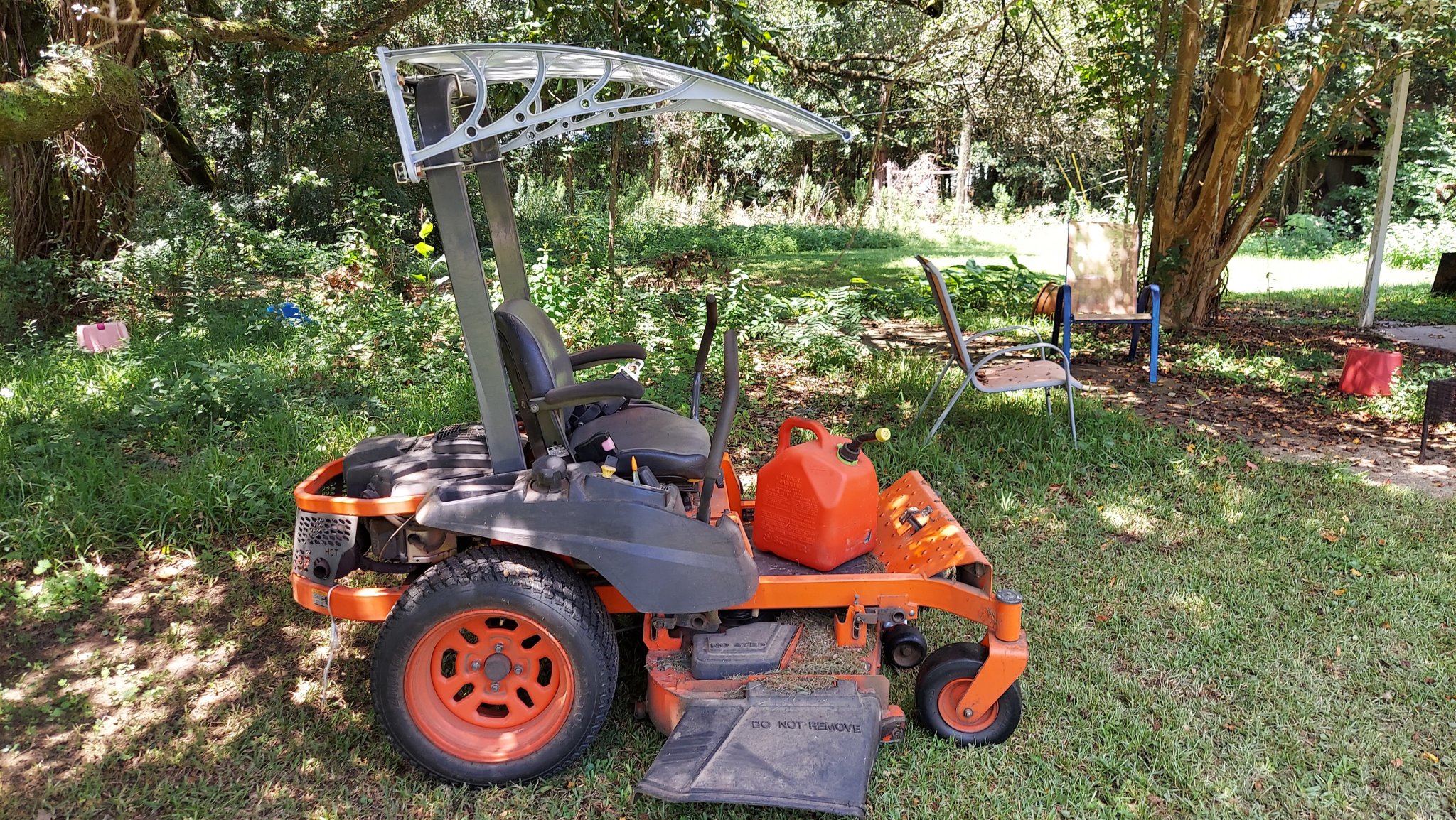

$50 golf cart roof:
I bought two at the same time and installed one on my Kubota ZD326 zero turn.

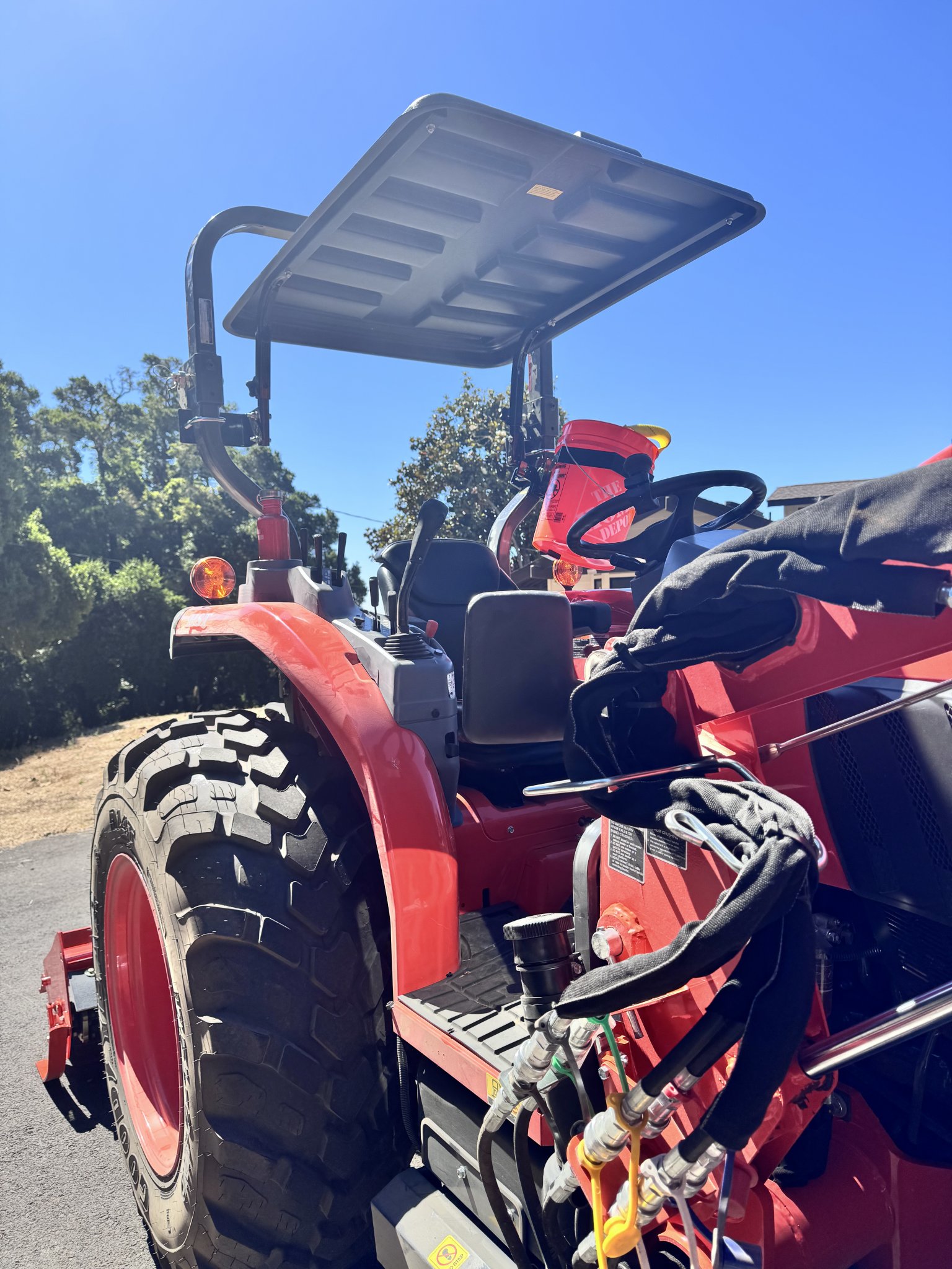

I just got this rhinohide and like it quite a bit. Smaller than some but can mount lower (if the ROPS spacing is wide enough). Sits about a foot above my head and I feel like my head at least is always in shade no matter sun angle. Also very lite and comes off easily. IMG_6815.jpeg

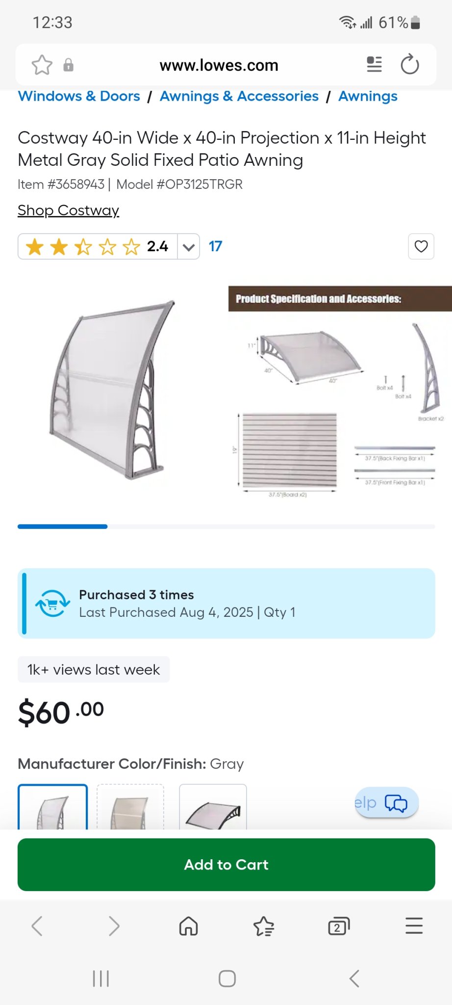

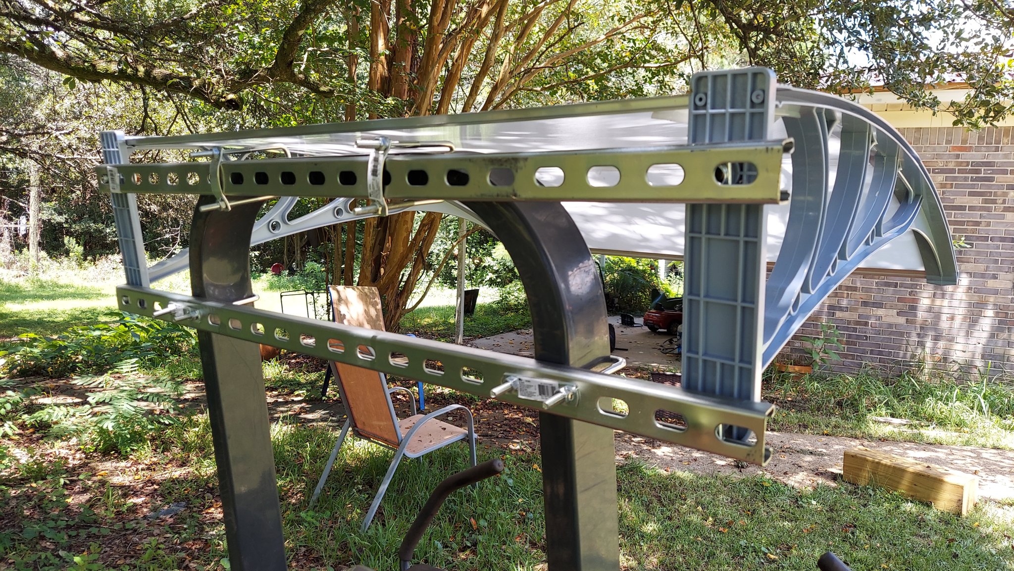

I ordered a 40x40x11 window awning for $60 and used square ubolts to add strut across my ROPs bolted it on and wala.
