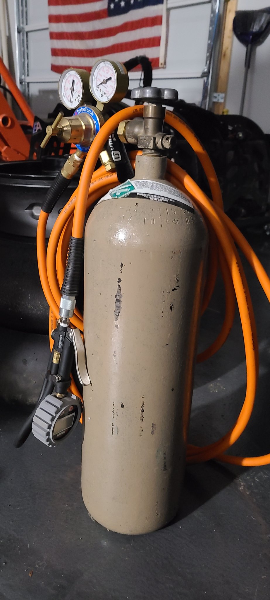

When I had the cub garden tractor,, ( really a good hard working little beast) I had to replace a tire and I tried all the tricks I ever heard, nada,, to it to the tire shop I already had it on the rim, they leaned it against the wall and brought over a tank, looked about the size of a gas grill tank. It had a valve and a nozzle on the valve , put the nozzle next to the tire pointing into the gap, and slapped the valve handle. That sudden burst of air popped it right in place, checked pressure and it was good to go,, took like 2 min
I use the nitrogen variety. Tank holds 3000 psi.

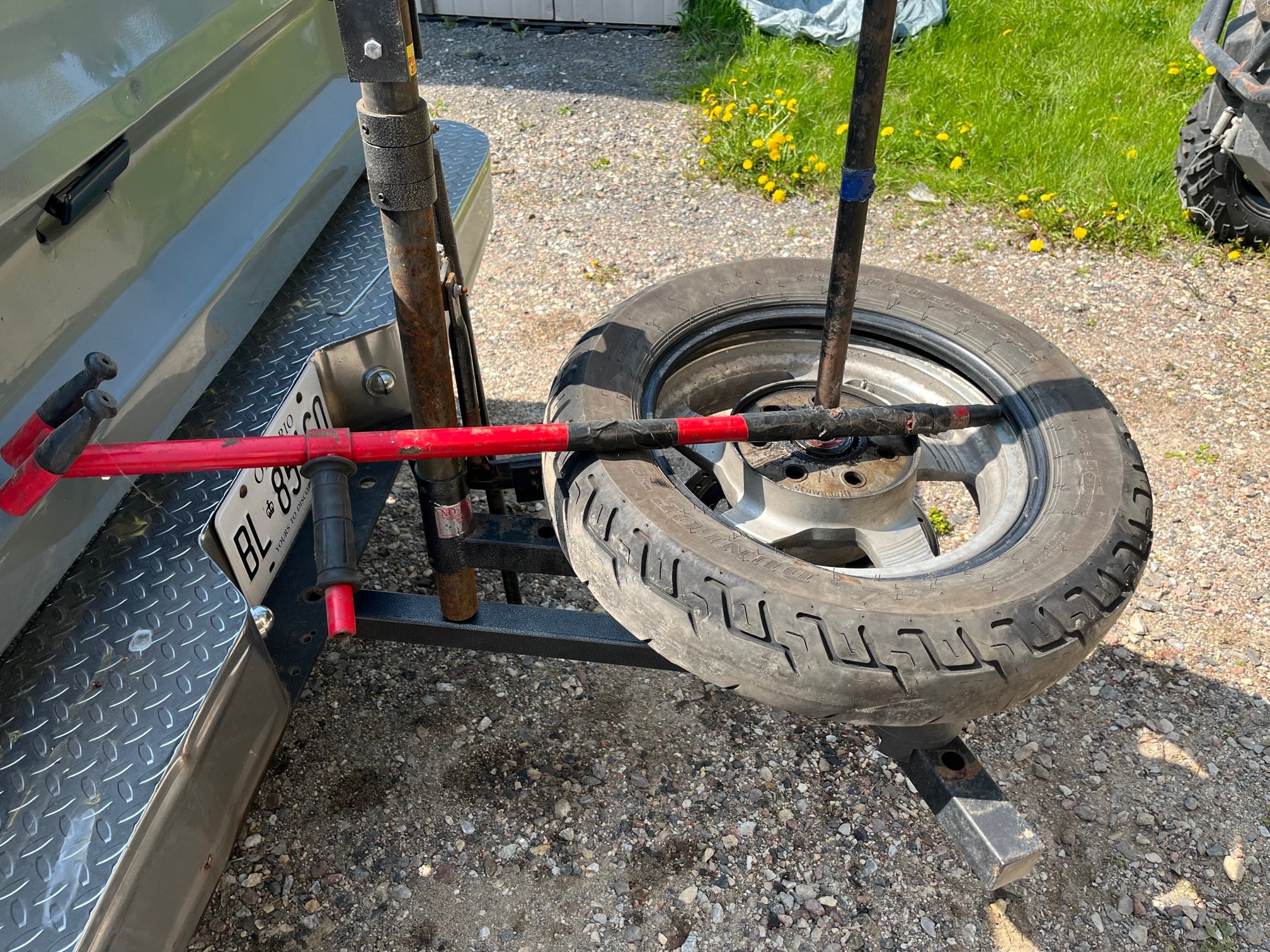

i have a no-mar tire changer. used the bead breaker on it, then just spooned the fronts off and then back on. wasnt very difficult. only real issue is the rims are too small for my clamp system so i tossed a ratchet strap around the tire and secured it to the machine. i dont have a picture of it with a tractor tire but this is how its set up for a motorcycle.
