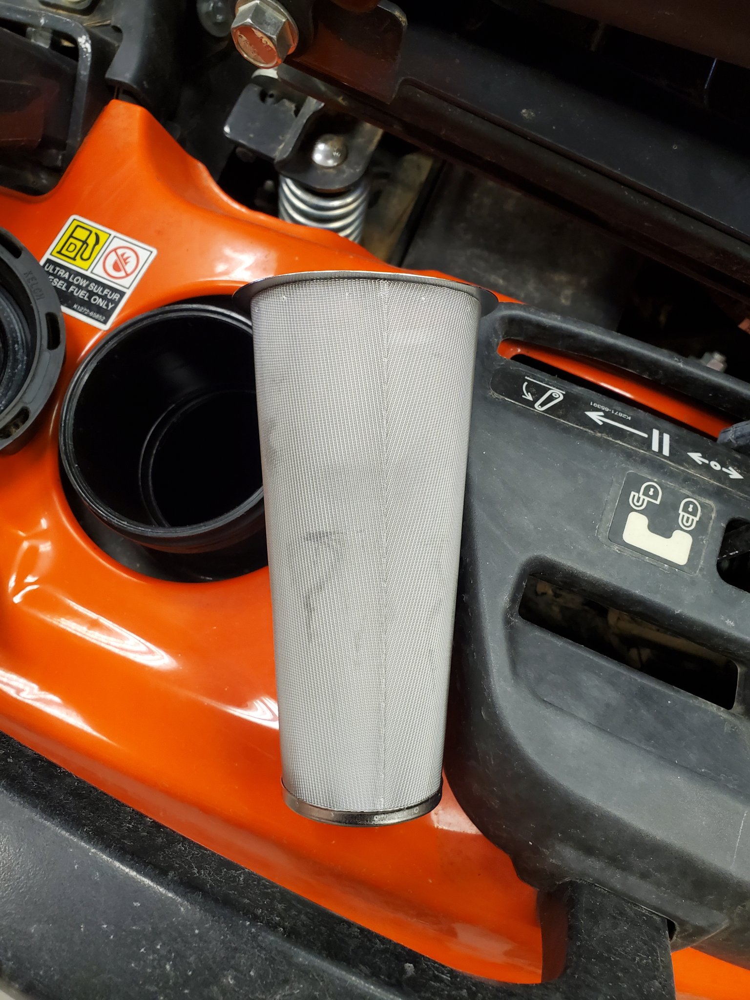

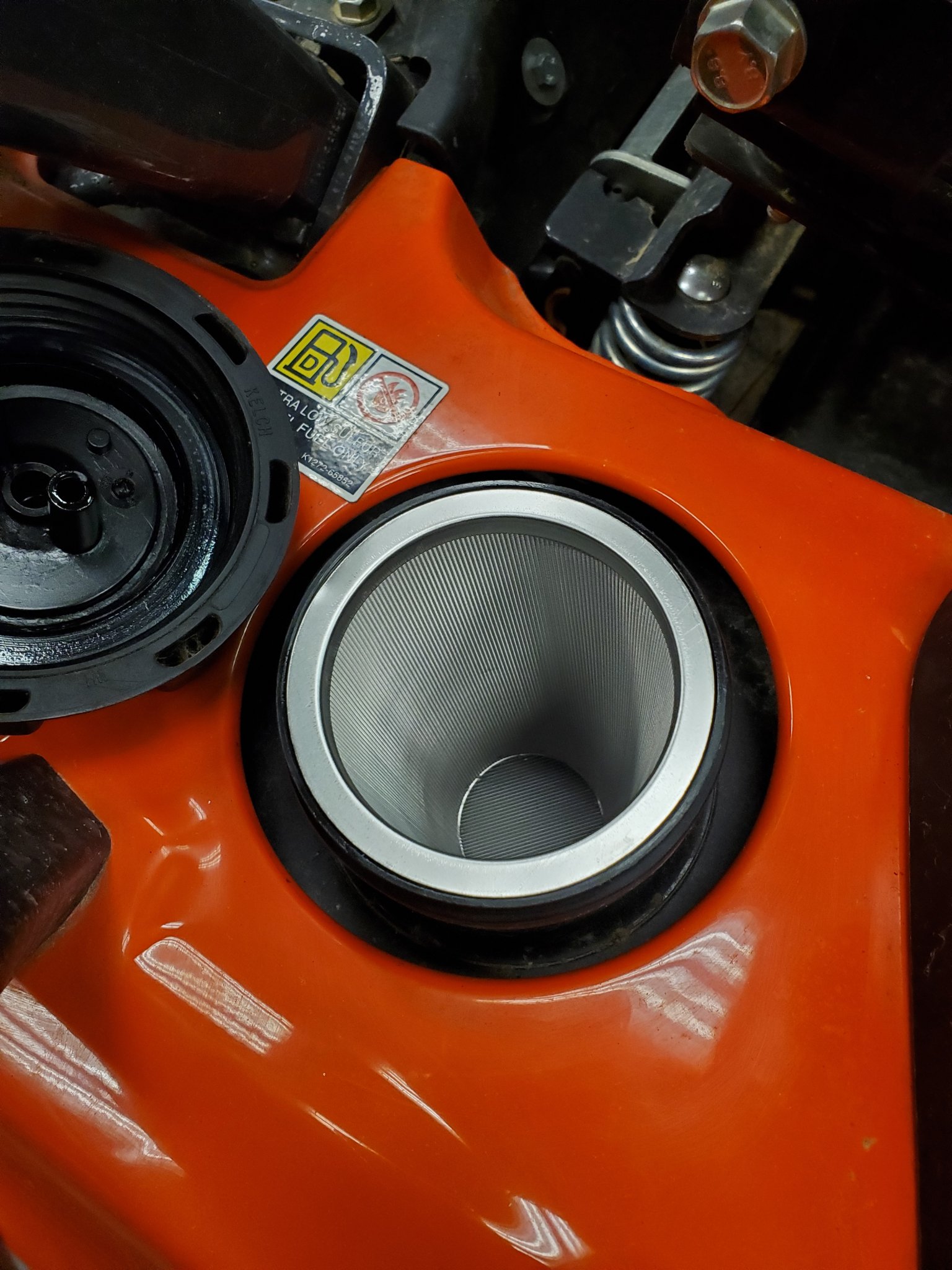

Greetings,
I have found a perfect fit, drop in screen for the BX23S fuel tank. It is a Zell cold brew iced coffee tea filter for 32oz wide mouth mason jars. I purchased mine here; Cold Brew Coffee Maker, Iced Coffee & Tea Maker Infuser for Mason Jars | Durable Fine Mesh Stainless Steel Coffee Maker Filter (Stainless Steel - Tapered, For 32 oz Wide Mouth Mason Jars) https://www.amazon.com/dp/B07JGW7NJZ/ref=cm_sw_r_apan_glt_i_RJG87W589F2H6C3KV8F4?_encoding=UTF8&psc=1
I did not use the included silicone gasket. I also do not know what else it might fit.
Cheers.

Greetings,
Cheers.
View attachment 74714 View attachment 74715 View attachment 74716

I bought the one that was recommended in the other thread, and there is no way short of hammering it into the filler neck on my BX23S that it is going to fit. This one looks like it might be a better choice since it is tapered at the bottom.

This is the one that was recommended in the previous post, and I ordered one, however, it just doesn't fit. When I mentioned this in that post, I was told that you have to fiddle with it, and it will eventually dropdown. Problem is that if it is difficult to get it in, then how difficult will it be if you need to get it out sometime in the future? I haven't gone back and tried it again, since it has been so cold that I spend as little time outside as I have to. My old bones don't like the cold.
