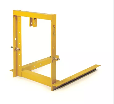

If not committed to concrete ballast box, consider a 3PH 'carryall' and a 'skid of weight'. Actually 2 'skids of weight'. EASY to get 'weighted skid' on/ff tractor. You can 'dial in' a heavy and a light skid,choose the one you need for the job at hand.
When you need some ballast for light loads,say compost or mulch fork the 'light' skid. For hauling buckets of stone, grab the 'heavy' skid.
A lot of guys have a 'skid of tools',say for land clearing. Makes it quick and simple to grab everything in one shot like gas,oil, saws, pruners, ropes,bandaids,.......

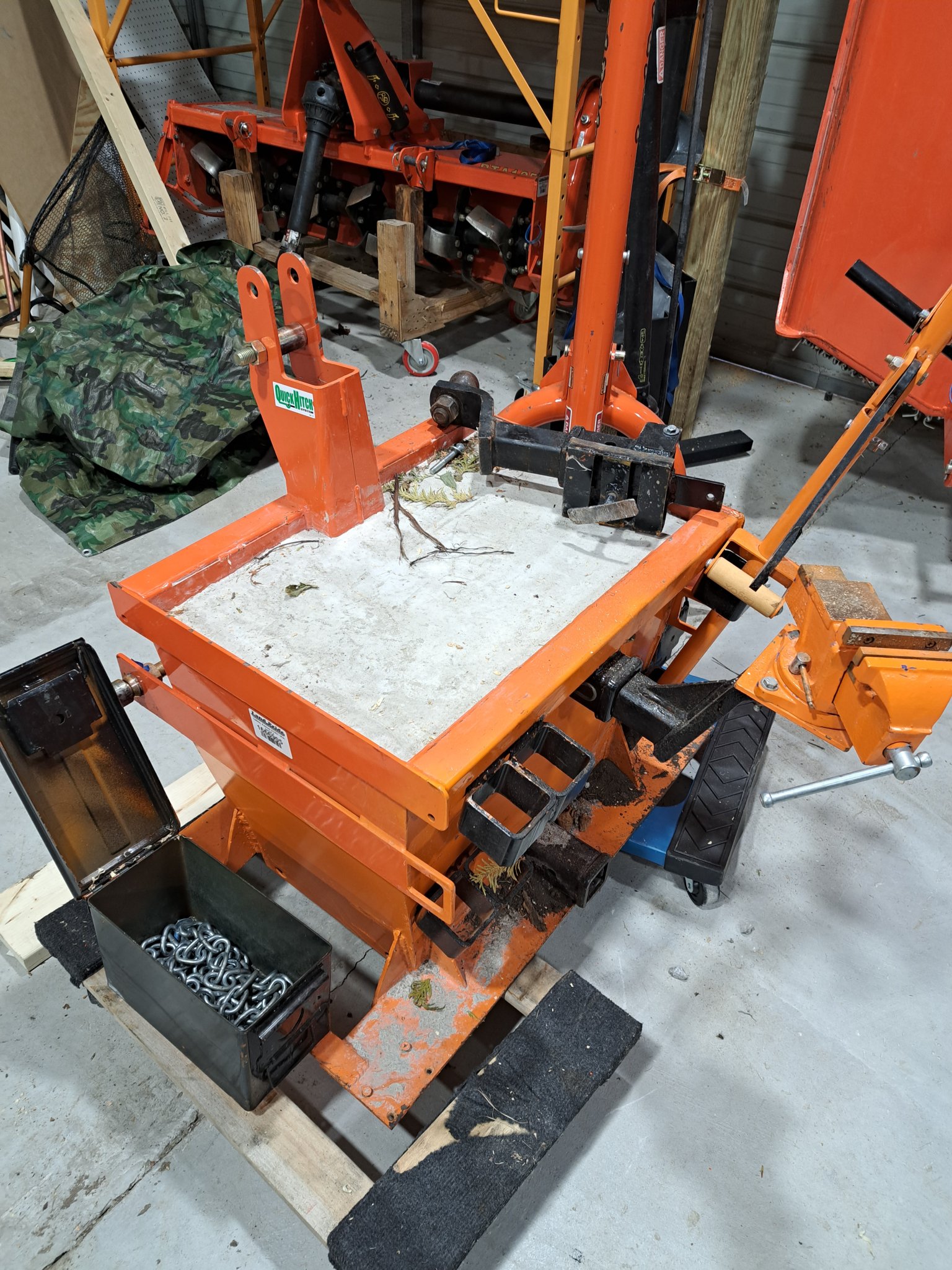

I bought a pre-made one from Titan for my B2301.
I believe it was around $125. I filled it with concrete 1/2 blocks (caps blocks).
They are about 30# each and I believe I fit 12 into the box.
I went that route for a few reasons. First of all it has tubes in the corner for tools, shove and rake handles and it also has a 2" receiver. It seemed more logical to go that route.
Most of the concrete ones I have seen have been damaged and chipped away, a few broken where the lower 3 point steel protrudes.
Which FEL do you have? Kubota has suggested counterweight weight depending on the FEL capacity.
And it varies from 350# for a LA304 to 800# for a LA504.
So there's a lot of room in there for experimenting.
Balance is important...but the main purpose of a counterweight is to lighten the load on the front axle when carrying a load. Filled tires don't accomplish that but will help with stability.
1,812
1,910
Before getting to happy with the throttle, I’d encourage to consider all the different tasks where need ballast and then search some of the older threads on weight hangers, ballast boxes, and carry alls…there are pros/cons to each. You might find all kinds of great ideas (tool carriers, trailer hitch, multi use implements) that might be helpful before you start pouring the mix😉.
I agree.
Lots of cool things that can be done to a ballast box, so a little planning could go a long way.
I ended up using/having some scrap steel parts that I used as filler (i.e. my trucks old flywheel, and brake rotors...) then filled it with concrete.
However, before I started the concrete, I cut a hole at the bottom and welded a 2" receiver at the top and bottom.
Now I have a concrete work surface and a way to sharpen my chainsaw with the vice that I mounted to the top receiver. (hahaha......so I don't have to walk the whopping 40 feet back to the garage. :unsure: )
Then I welded some scrap pieces of square channel for rakes and stuff.
The funniest part is that I almost never use it since the BH77 is on most of the time. Fun project though.

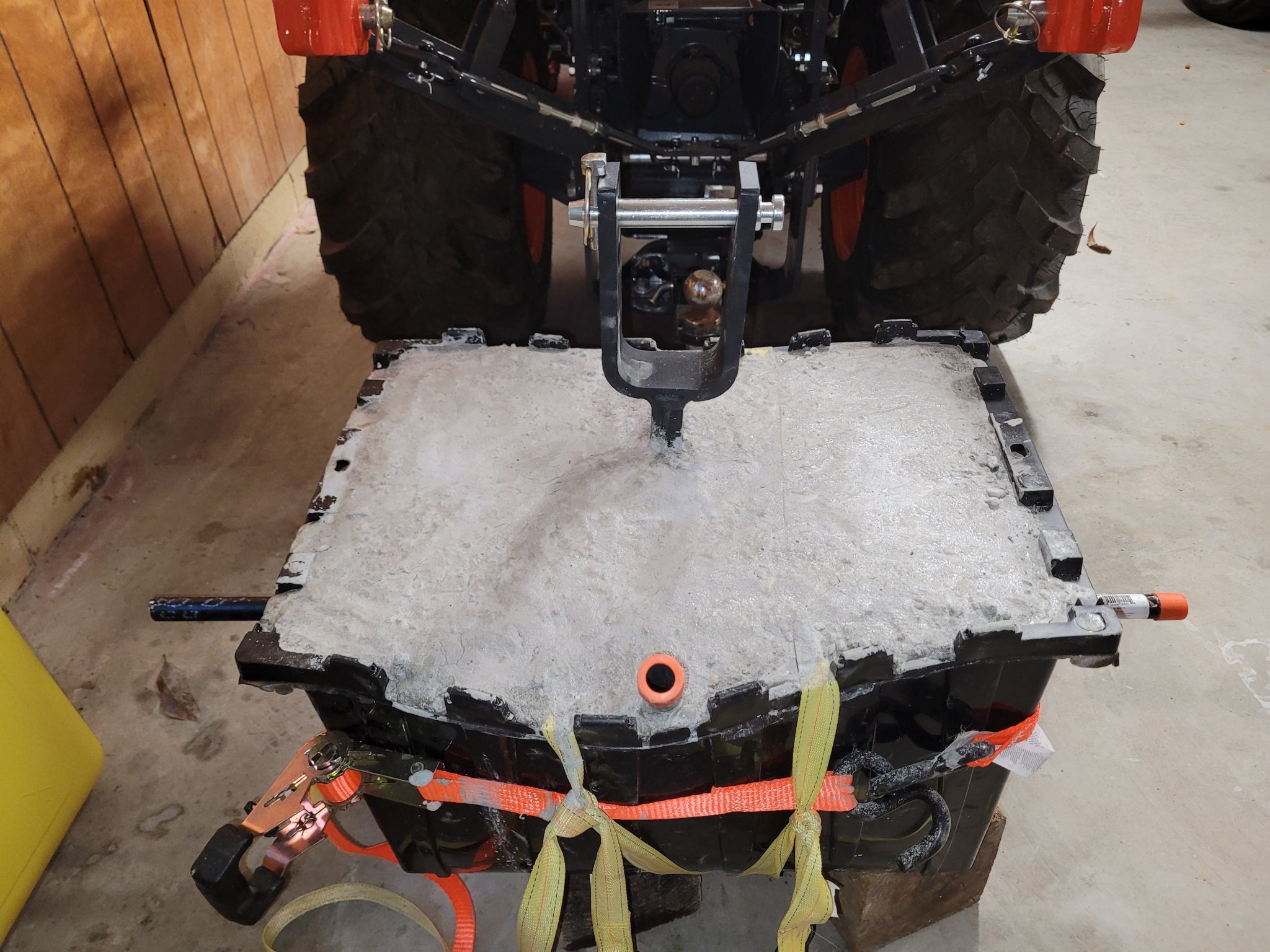

I ended up going with the "Country Boy" idea of filling a plastic tub with concrete. It ain't pretty, but its heavy.... Thankful for YouTube and the internet. I put the extra pipe out the back, I figure I could slide a steel weight over it I have to. ended up with 250Lb of concrete and some old rusty rebar and wire I had around here. It should help...
