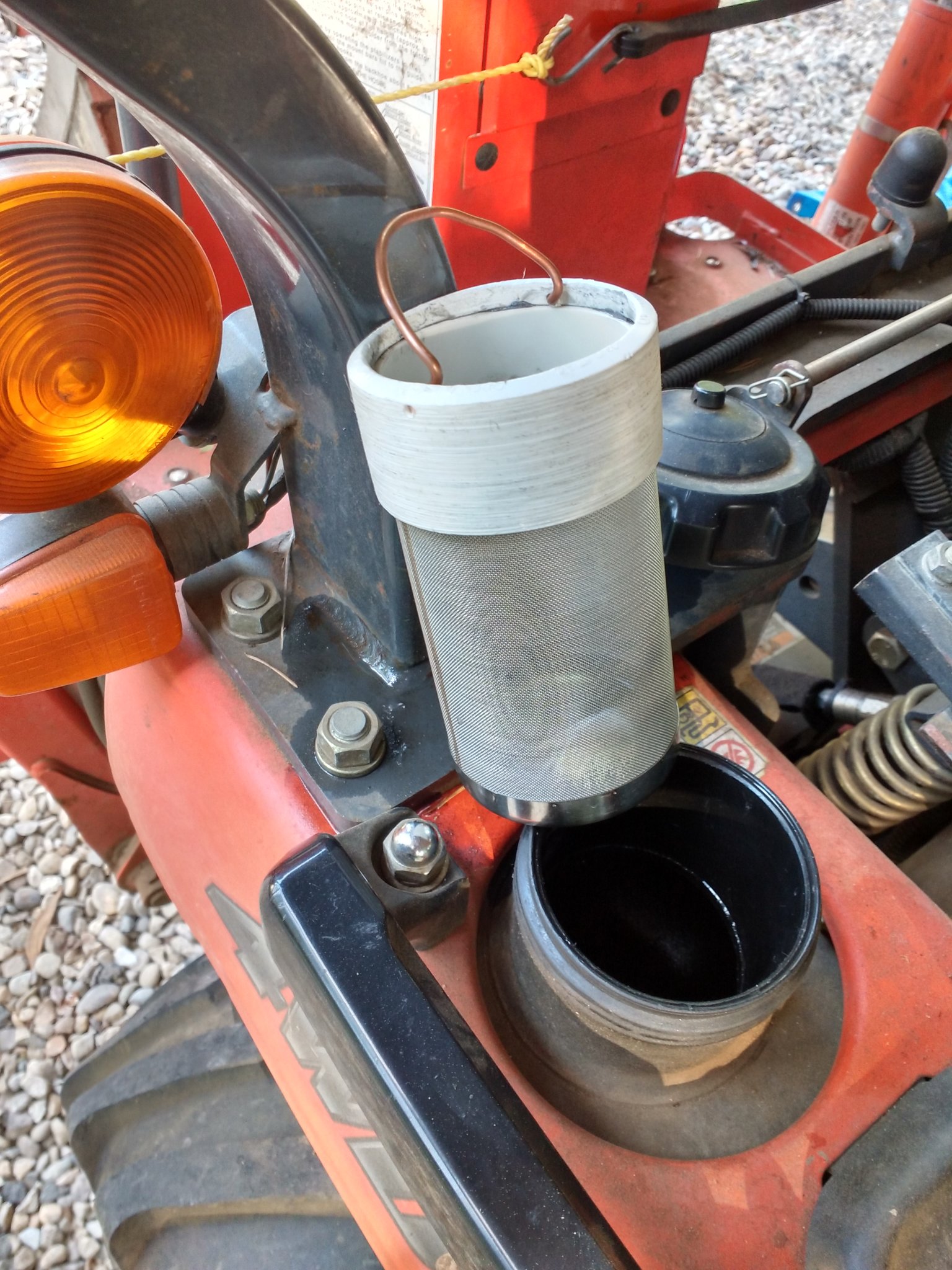

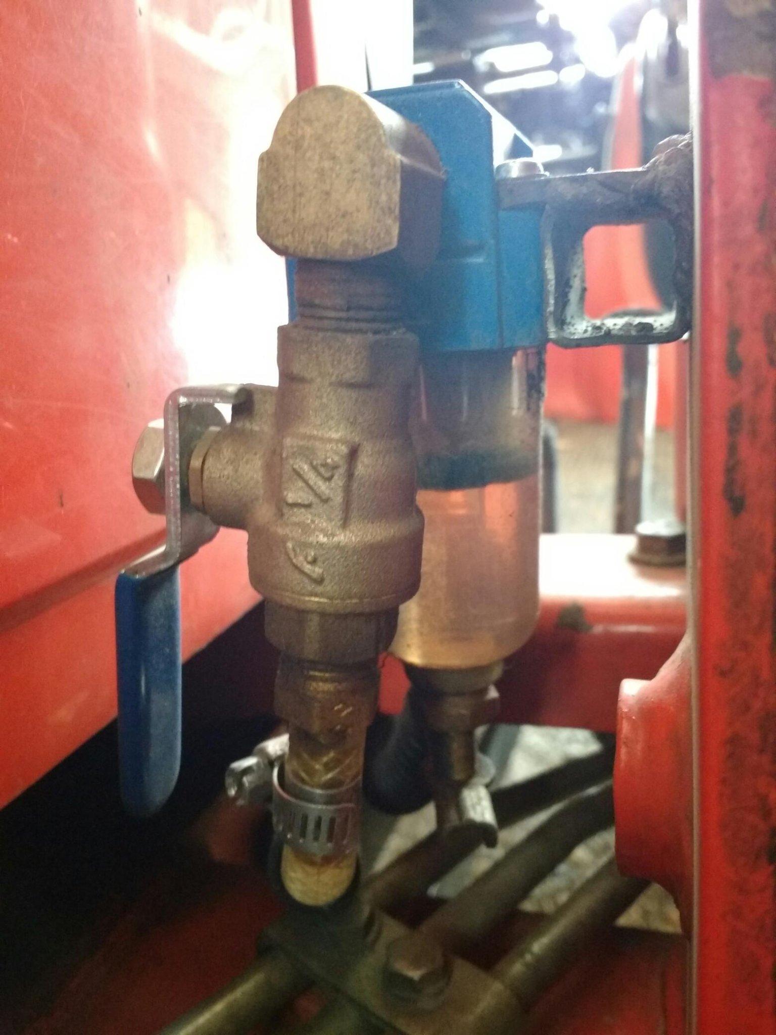

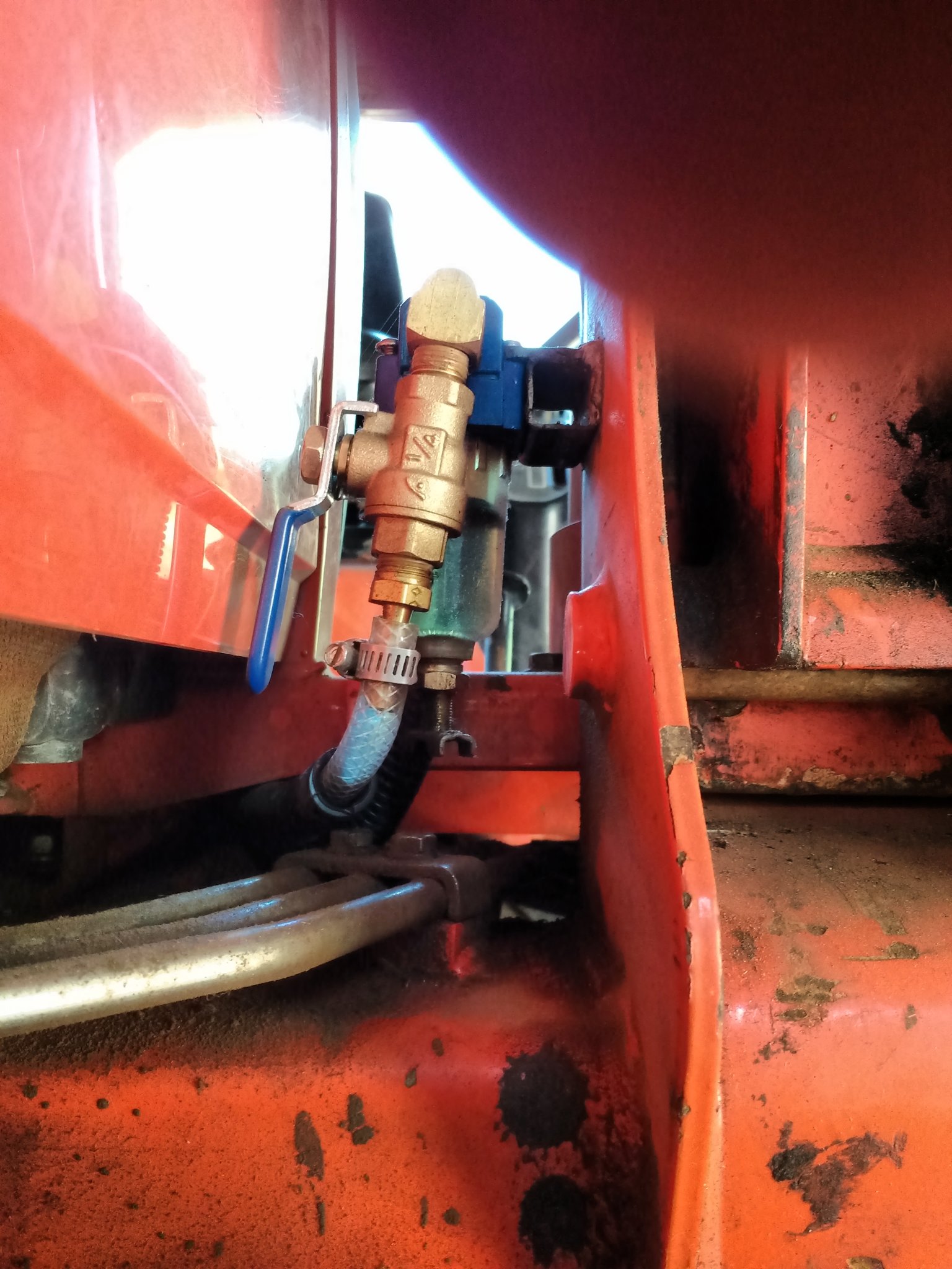

I got all the manuals. The front axle has high viscosity gear oil in it, don't want to run UDT as its viscosity is pretty high, more liable to get seal leaks. It is time to change to coolant. I have a primary fuel filter that is visible for crud build up, and if it is clean (which it is) it is very unlikely that the secondary fuel filter needs to be changed. Also, the fuel filler neck has a screen to keep junk out of the tank.
