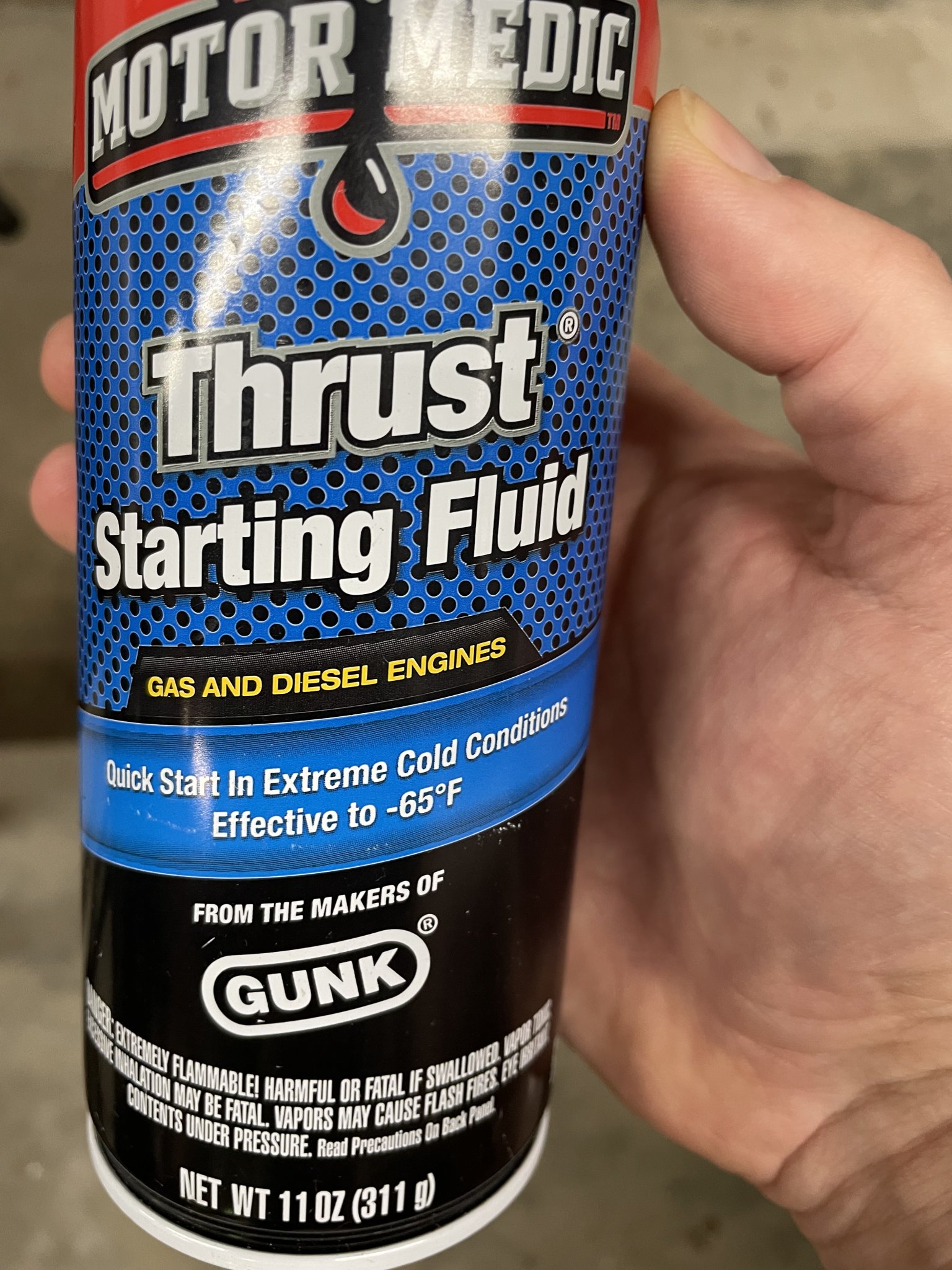

UPDATE #2
After reading the responses (much appreciated), I decided to try the "no fuel" possibility; even though I can hear the fuel pump run and could see fuel filling the filter bowl.
I disconnected the air cleaner hose and applied diesel safe starting fluid directly into the intake... It started and almost ran for a fraction of a second!
Now, I'm considering that maybe the fuel pump works but is too weak to fully pressurize the line?
(Also, verified I didn't accidentally reverse the fuel filters flow... I did not.)
"Diesel safe starting fluid" ???
There is such a thing?
If there is....it ain't "safe"!

My understanding is that SOME diesel engines by design used starting fluid of some kind.
NOT Kubota tractors though…
Yeah, I’m not an expert on engines, but, when used properly, can help diagnose a non-starting issue.
Previously, I used it sparingly directly into the intake manifold while cranking, and the motor chugged a bit.
I tried the same thing, but with a mist of diesel from a spray bottle. It didn’t have the same effect. I’m guessing because the diesel spray didn’t atomize into small enough droplets.

It is common knowledge that using ANY starting fluid in a modern diesel will guaranty an imminent death for that engine
That may be true, but I wouldn’t classify my Kubota engine as “modern” since it’s all mechanical without an ECU. Either Way, it didn’t cause any damage, but thanks for the warning.
8,001
5,187
My L48 is from 2006, but I will not use any starting fluid either.

Starting fluid / ether in these ultra high compression engines can squash the rods thus dropping the compression and making them not start.
So saying you didn't do any damage is only verifiable with compression test and that still don't 100% rule out it breaking rings, or lands causing oil consumption.
