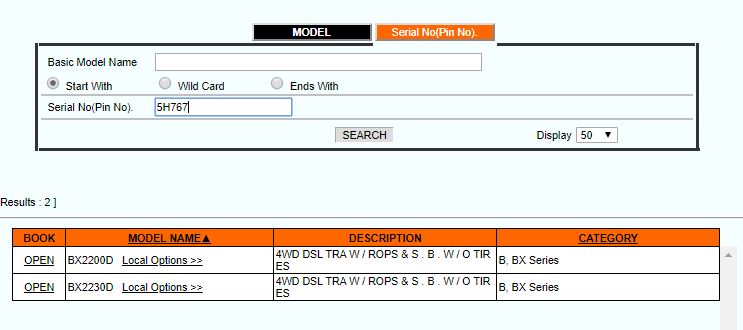

Thanks to both you guys. Based on what that thing is doing, I believe the electrical system has to be based on the 2230. It certainly isn't working right with the double switch only closing with continuity across one side, unless of course there is another problem somewhere else.

Put in a new K1122-62250 NSS. Everything operates correctly !
The switch that was initially installed was either mis-packaged or was defective.
This should have been caught by the shop, never installed and never released by the shop,working the way that it was, but they made it right. Service manager came out to my house today with right switch & helped me get tire off and switch installed. This is what I call great customer service.
Thanks again to all the help I received from the forum & helping me figure out the correct wiring schematic. Still find it weird that the BX2200 was wired as a BX2230. Learn something new everyday.
