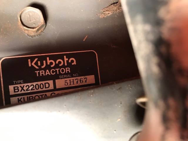

Skip G,
Help us to help you get to the bottom of the problem.
#1: Give us the serial number of the tractor so we can look it up via Kubota to make sure we are addressing the right tractor model and submodel or variation of these models.
#2: Do you have any paperwork on the switch that they installed, like a part number?
It's really sounding like you have the wrong switch for the NSS, which will cause you all kinds of grief and mis wiring.

We need the tractor serial number not the motor serial number. ;)
