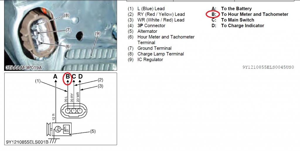

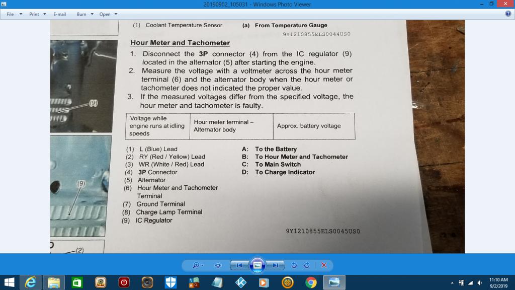

I've done quite a bit of searching on this issue and found a few threads but nothing with the answer to the question I'm going to ask.
The question. Does anyone know the "proper value" of the signal sent from the alternator to the instrument panel for the tach/hours. I tested as per the WSM and at idle I get ~.482v and that increases as the engine speed increases. I've dug through the manual and have not found the "proper value".

You are not interpreting the page from the WSM correctly.
The required voltage is the battery voltage.
In theory, the tach is using an alternating current pulse internal to the alternator to calculate the rpm's . This signal would not be present on the main alternator output terminal but on one of the small terminals specifically terminal B.

Thanks for the reply. I had a hunch I was looking for battery voltage but needed a confirmation. I did check from the B post. Im going to double check my finding later today.
So it looks like if I get the same results it looks like I may have alternator issues. Wonder if the broken wire I found grounded and shorted the alternator module?
Any way you know of to send a signal to the tach to confirm its okay?

If the alternator is charging properly, it is unlikely it was damaged. The tach signal comes from the diode bridge which would be tough compared to some of the electronics in the internal regulator.
I do not know a way to send a signal to the tach. I am certain there is one but finding out what it is for different rpm's would need a conversation with the original designer. Further, generating a varying frequency signal would require specialized test equipment.

I double checked my previous findings and it's the same result. ~.48 v between terminal B to ground.
I assumed the alternator itself is charging fine because no light came on, but now I'm questioning that assumption. I did do the check for the indicator light and that test showed the light does work.
I guess tomorrow I'll test the charging output of the alternator.

So an update.... I pulled the alternator and had it tested at rebuild shop Working perfectly. I questioned the reading I was getting from the tach output and he explained that it was correct. Output signal to the tach can't be battery voltage. He even pulled another alternator off the shelf, spun it up and got the same results.
He feels I have another broken wire someplace.

Read test step 3 carefully. You have a different reading than battery voltage so it means your tach and hour meter are bad.
