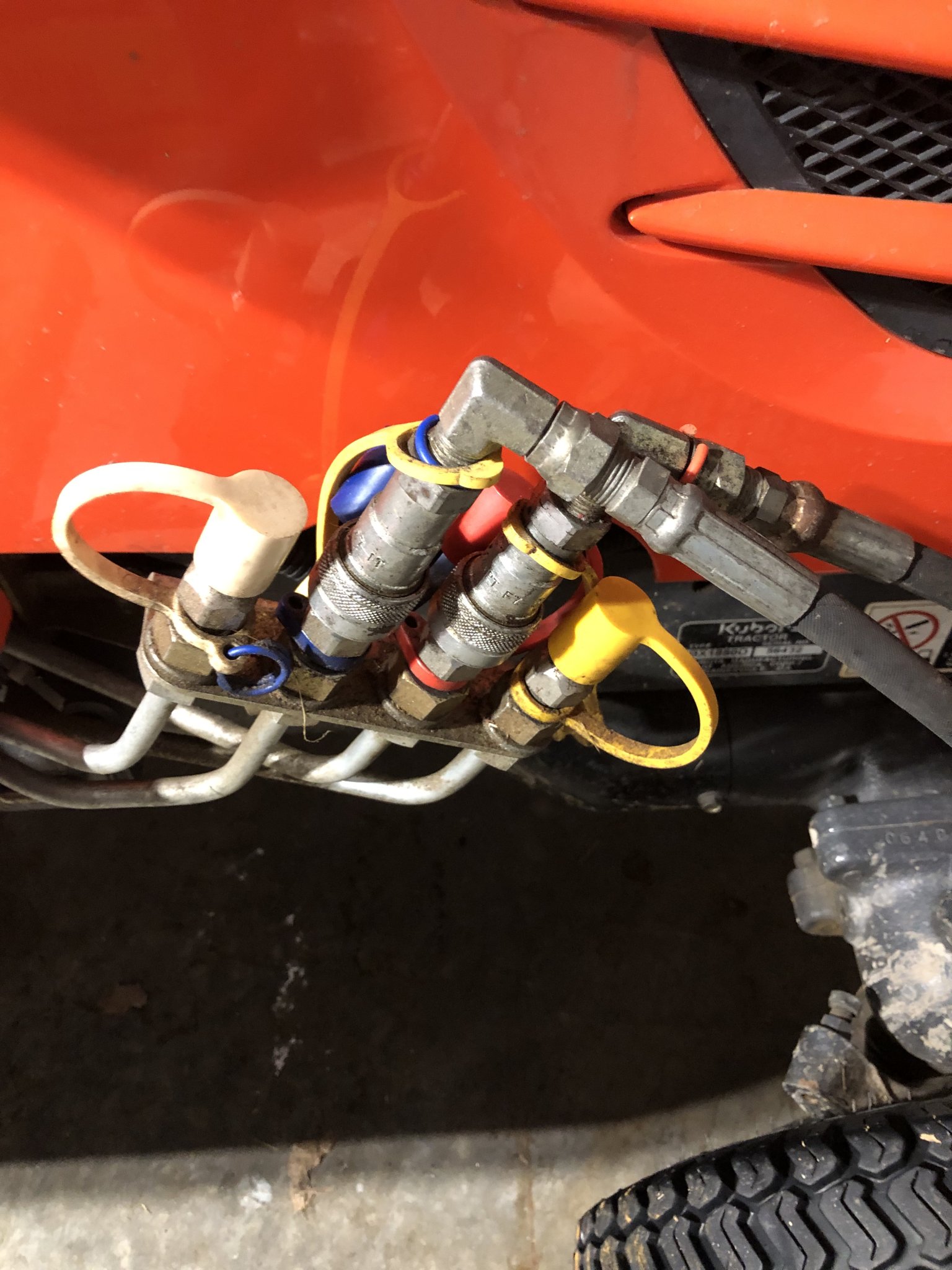

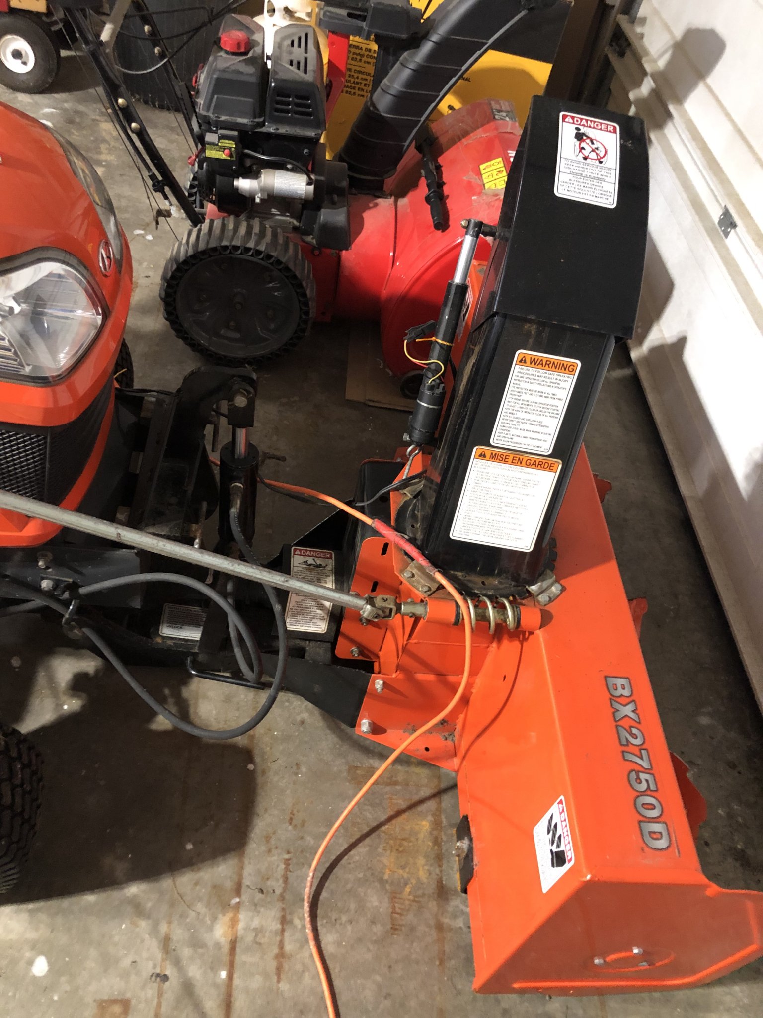

Anything is possible. I’m new to tractoring so I'm not 100% what I'm even looking for. I’ve attached pics of my setup.
2,910
4,536
Kind of weird the center two connections on the loader ports are a pair and the outer two are another pair but if that’s how it is, I guess that’s how it is.

Haven't used it yet this season, but my pretty sure my BX2750D blower on a BX2360 tractor uses the white/yellow pair.....those are boom, and red/blue are curl.
Will have to double-check.

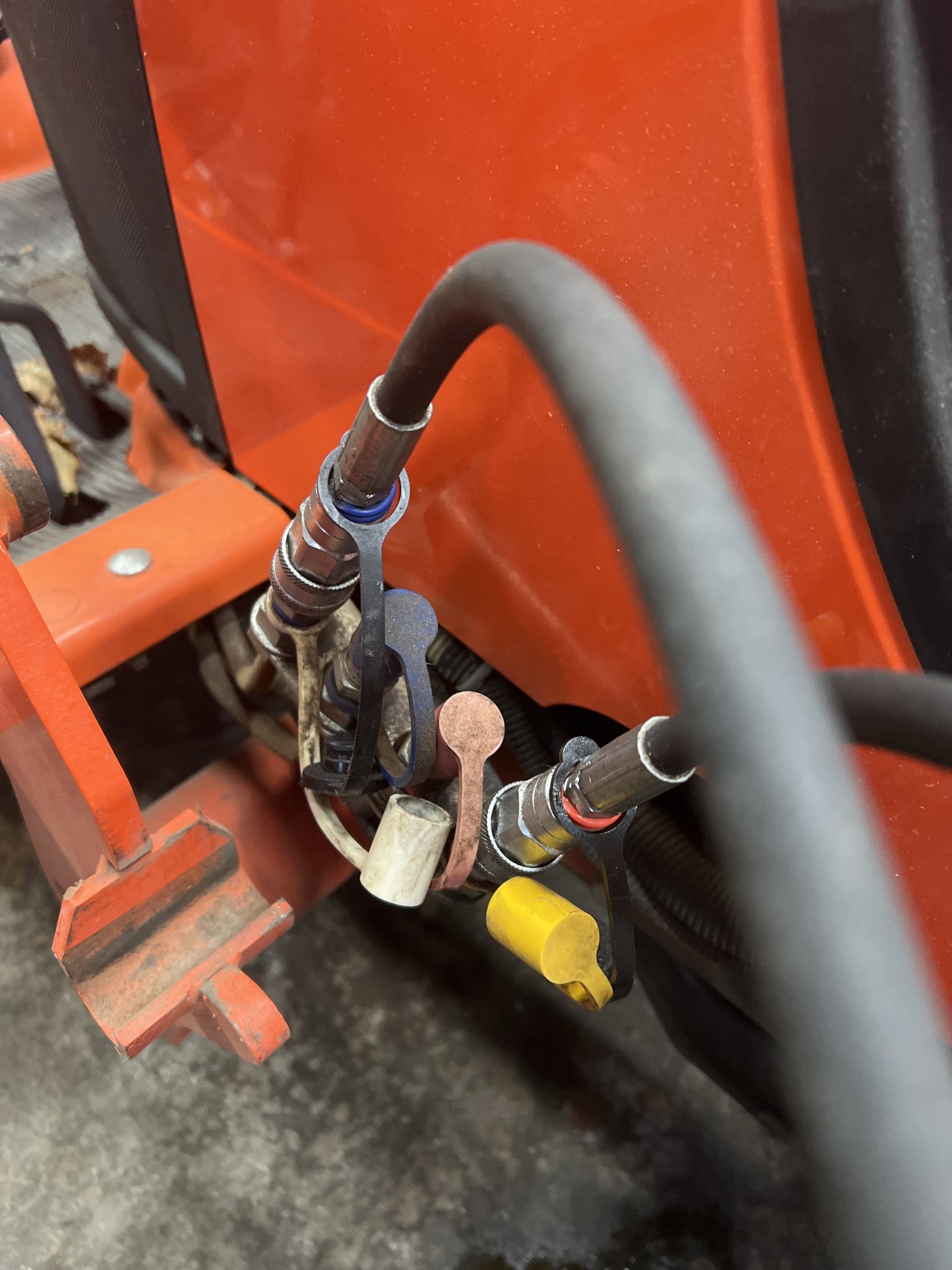

Off note from my snowblower hydraulic connection picture, the blower came with red and blue “markers” but actually go on white/yellow pair.
There are corresponding markers on the tractor-side male connectors.
If I were the OP, I’d move the blue to white, and red to yellow.

I'm curious about is WHAT are the two orange things are behind RCW's loader frame !!!

I don’t see loader mounts on the tractor, so it could be different if not tailored for loader function.
