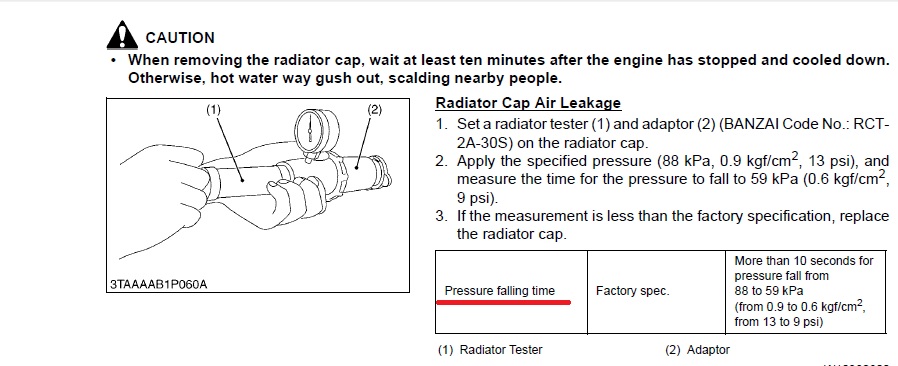

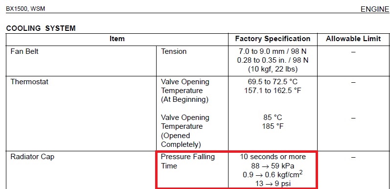

Please look at the Kubota spec which has a time for pressure to drop from 13 to psi.
Do you have that info for your $7.00 cap which is protecting your machine worth thousands?
Maybe I think differently at my age but for me peace of mind knowing I have not made a substitution which, because of my lack of knowledge of my machine's requirements, puts the risk of damage too high.

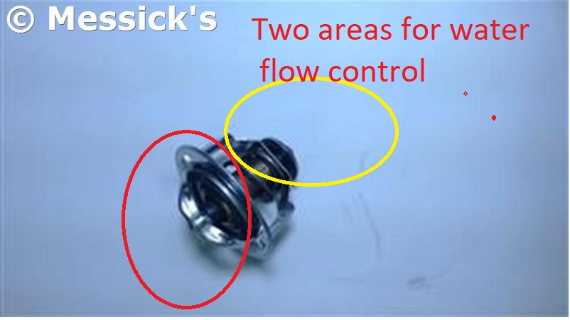

What comes to mind when I suggest caution is a thermostat situation posted on this forum. The tractor was a new Kubota whose thermostat was controlling two water passages. The owner had bought a generic NAPA stat and now was having problems with over heating. In selecting the NAPA stat he did not understand the cooling system design on his tractor.
This is the example which comes to mind when owners start deciding what will work without having the background to make such a decision.
There are many members who are quite capable of making such decisions but there are also those owners who come here for help who are still learning
