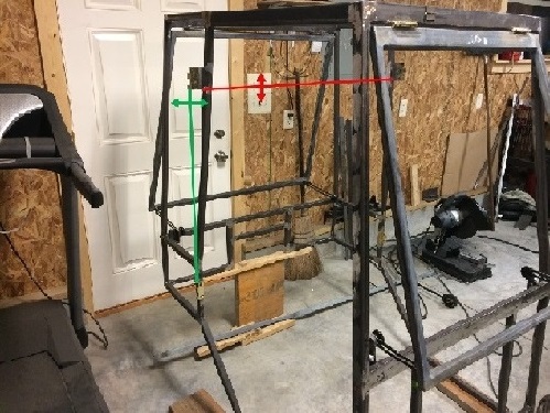

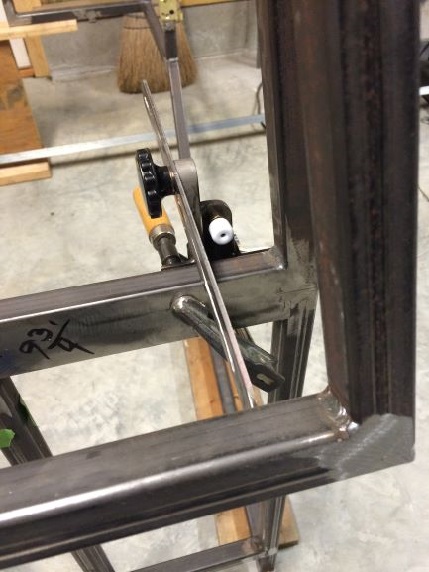

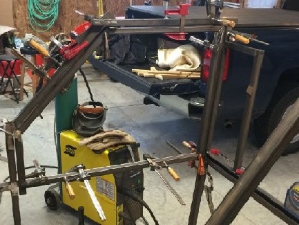

Just like the window frames, the door frames were built using the cab frame as a template. Hinges spacing their reveal and 1/4" stock spacing the remaining 3 sides. Unlike the windows however, these required them to be built in 2 steps, 1 for each plane. The lower frame section was built first and, the upper section last. By doing it this way, the only compound miter I had to deal with was the front upper post where it intersects with the horizontal member. Everything tacked in place, the 142 clamps removed holding spacers, etc in place and welded up on the bench. I don't have a full blown shop like some of you, only a few hand tools. My welding bench is a piece of cement board layed over a pair of sawhorses. Been working so for, so why switch!
So far, so good. They appear to follow the cab opening and every thing should be good, just need to get the hinges installed. I chose a location for the lower, transferred hole locations and went to drilling and tapping those. Now for the uppers. Because I chose to not build a big box (thanks, Chim) and didn't want to fight the weight of the door trying to open them, I have them swing plumb. The upper hinge pin needs to be out in space, so to speak. This was a bit of a challenge at first and required a couple of head scratching and multi-grain, fat free, protein enriched energy drinks to figure out. Just as I dutchman'd in 1/4" stock for the other hinge locations, I did the same for the upper hinge location on the doors. Only instead of 1/4x1, I used 1/4x3 and left the length long, the excess protruding towards the outside of the cab. Again, the door frames were set into the opening on 1/4" spacers, lower hinge installed and using a length of all thread, I was able to locate the upper hinge positions. Transfer the hole locations, drill and tap a few more holes, cut off the excess 1/4x3, install the stops in corners and we should be good to go!
WRONG!!!
The right hand door fit like a glove. My angle followed the cab almost perfectly. I couldn't ask for anything better. Remember the bling hog finding an acorn??? It applies here! Well, i'm all proud of myself and move to the left hand door, the one I'll likely use the most. Well lets just say i'm less than pleased on how this side turned out. The hinge side lines up well with the cab frame but the front doesn't. I'm off a least a degree or so. I know it doesn't sound like much but, over 30" it adds up pretty quick. My door reveal when viewed from the front started at my planned 1/8" at the intersection of upper to lower but, by the time I got to the top of the door it was like 3/8-1/2", totally unacceptable.
Out come the cut off wheel for my angle grinder and the propane language as I proceed to correct this mess I have created. It took 3 or 4 attempts to finally get this side to a point I thought I could live with. Thank goodness that's done! This had to be the most aggravating part of this build. And, this is the reason I wasn't about to attempt to build flush inset doors in the first place!

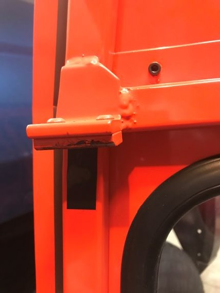

When our story last left off, we had the door frames completed and hinges installed. Next up was to figure out was the door latches. I knew I wanted some form of stops on the latch side to help prevent the doors from closing too far and bending the 1 1/4" sheet metal overhanging the frame. And, because, I was leaving an 1/8" gap for weather stripping, I was able to find 1/8" push in stops at the hardware store. Now how to incorporate some form of latch & handle that won't look like an afterthought. I had originally planned to use truck toolbox latches. They were readily available, I could modify them for inside release and wouldn't catch anything if I got toooooo close with the tractor. Only problem with this idea was, I had no real estate left inside along that corner to act as a catch. That got used for a wire chase. Up until now, I had been using a stash of neodymium magnets to temporarily hold things in place during this build. Slap a magnet on the frame and it made a convenient place to hang a scribe, drill bit, tap, etc. The thought of using these as door latches hadn't occurred to me. It was the wife who suggested using a magnetic latch on one of her 'lets see if he's still alive' trips to the garage. Wow, what a great idea, honey. Why didn't I think of that? I didn't have to worry about an inside release. Just fab up some brackets to stick the magnets on and we're ready for door skins! Since the magnets attractive force varies with the square of the distance, I added a piece of electrical tape to the door frame, increasing the distance on that side reducing the attractive force on the door side. So far this has worked great. The doors close against the rubber bumpers/stops as the magnets pull the door closed. The magnets stay put on the bracket side and with a little tug from the outside or bump from the inside the doors pop open. The only downside is there are no locks on the doors. This is probably a good thing as I've lost my short term memory and would end up losing the key anyway! I'm at that age where my Rememberer is getting worse and my Forgetter is getting better. To eliminate the bending moment placed on the hinges when the doors are closed, I incorporated wear plates on the frame and door. If I find the doors wanting to pop open on their own during operation, I can add a ball nose plunger thru the lower wear plate later to increase the retention force.
The door skins were rough cut to size and bent to match the angle of the door frames. I temporarily attached each skin to its frame with a couple machine screws. This allowed me to install each door in its opening and mark the final exterior size and window openings. Each door skin was drilled for plug welds, welded then reinstalled. I confirmed window openings were correct before I was brave enough to poke the openings in.

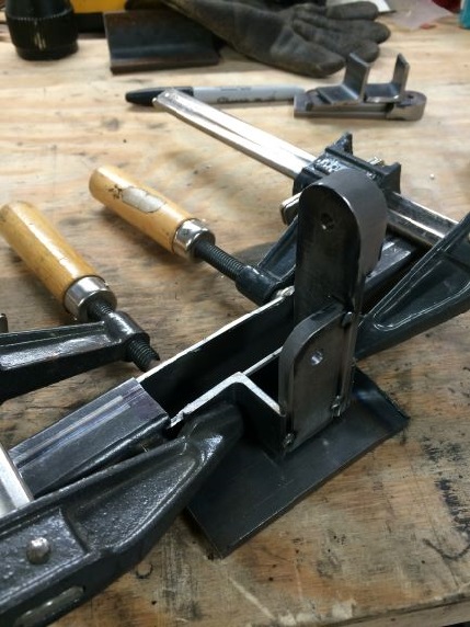

Time to figure out how to hold the front and rear windows open and closed. Latches and gas shocks would have been nice but, I'm a tight wad and wasn't going to spend a bunch of $ just to hold things closed. I ended up cobbling the front and rear brackets together with materials on hand. I had to purchase the knobs which add a nice finished touch to the interior. Both front and rear window brackets are bolted to the frame in case I need to remove them later. Like the doors, I wanted some form of stop to prevent things from traveling too far when closed. The threaded adjustable portion from interior door stops provided the solution. The slotted sliding portion is cut from some 1/8 x 1 stock. Holes drilled at each end and opened up with a cut off wheel as I don't own a mill. Same as before, hole locations transferred from the brackets to the frame and mounting holes drilled and tapped. The brackets on the windows are just 1x1x1/8" angle, locations established after the frame brackets were bolted in place.
As usual, pictures below

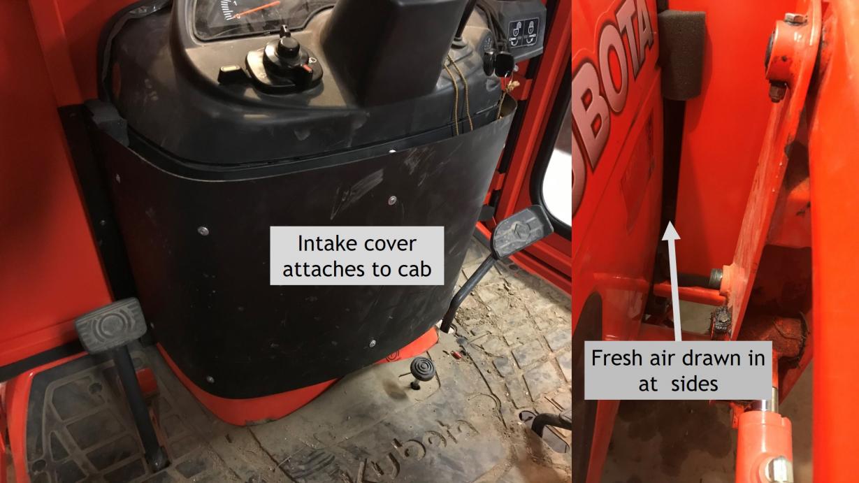

The lower windows in the front of the cab are critical. I have one cab from Curtis and its windows are placed such that I can't see the front tires at all. Totally useless. In building up the cab for my other B7510 I opted to go with a Lexan sheet across the lower portion of the front of the cab. I can't believe how much better the operator's situational awareness is with the extra visibility afforded by being able to see through the lower portion of the front of the cab.

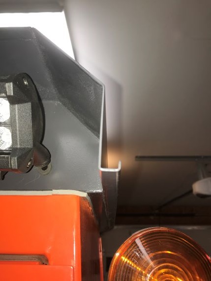

To deal with the reverse airflow of the BX models, instead of covering the intake screen with a fabric material like the Curtis Cabs, I cobbled together a cover out of OSB & 1/8" HDPE. After all, I had been ignoring the wife's honey do list and really didn't want to dig myself in any deeper! The OSB frames are sealed in fiberglass resin and space the HDPE out about an inch away from the screen, providing an space for fresh air intake. The sides of the cab next to the engine cover are also spaced in an appropriate amount to create this air passage. Since I'm not blowing snow, I'm not too worried about this getting plugged up but, will keep an eye on it this winter.
Power was run off the battery thru a 25amp circuit breaker. An Anderson PowerPole connector lives near the right hand side loader mount to allow easy removal in the spring. #6AWG primary wire supplies the Blue Sea 8 circuit distribution panel. #14 wire supplies the wiper motor and #16 to the remaining lights and fan. Switches are 10amp SPST I found on Amazon. 18w flood lights reside in each corner and should provide plenty of light for night time plowing. At this point, I have a fan but no heater. I ran out of time and will give it a go this year and see how things go.
In an attempt to seal up as many large gaps as I could, the HDPE was used in the rear of the cab and closed cell foam along the doors and front.

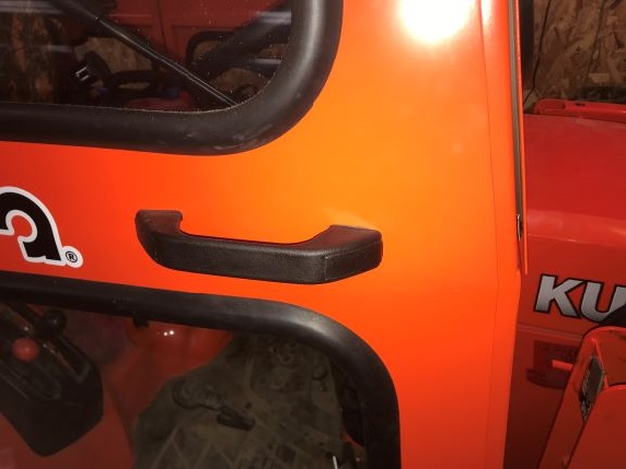

The hazard lights, mirrors and backup camera weren't originally planned for. The more I looked at the hazard lights mounted in their original position behind the glass portholes, the less I liked that location. After I had the cab in self etching primer, I noticed the size of the factory lights would fit nicely where I located them. They help to give the cab a factory look and provide better visibility. I extended their wire leads and utilized the factory harness locations behind the tail lights. The mirrors are cheapo Amazon golf cart mirrors, mounted directly to the door frame and up high so as to not reduce visibility. So far they are working out and haven't vibrated out of adjustment. Since I plow in reverse for larger snows, I thought I could afford to splurge on a back up camera and save my neck. Mounting location for the camera is up high between the rear work lights tucked up underneath the roof overhang. Monitor is located front and center next to the electrical panel. I can bounce back and forth between the mirrors and camera without moving my head.

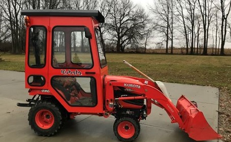

Hope you've enjoyed this. I plan to update this in the spring when I pull the cab. If anyone has questions, feel free to ask.
