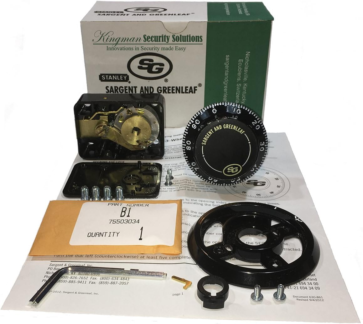

But the one thing I hate/can't stand/worry about, is the "electronic lock" and the EMP that is going to lock me out of it, when it hits....(and it will hit...trust me).
I'm just a "mechanical combo guy" in my heart of hearts, but I have never changed out a "safe lock" in my life so this should be fun.
I did a little research, and found out that Sargent and Greenleaf are just about the only game in town. There are others of course, but S&G seems to be the "industry standard", at least for this style lock.
In reality, I wanted one with a 4 digit combo, but I had a hard time locating one and this one kept popping up, so I got lazy and figured my main threat was/is probably these 2 numb-skulls,
and I highly doubt they would ever be able to defeat a 3 digit combo.
So a few clicks, and 3 days later this shows up on my porch.
