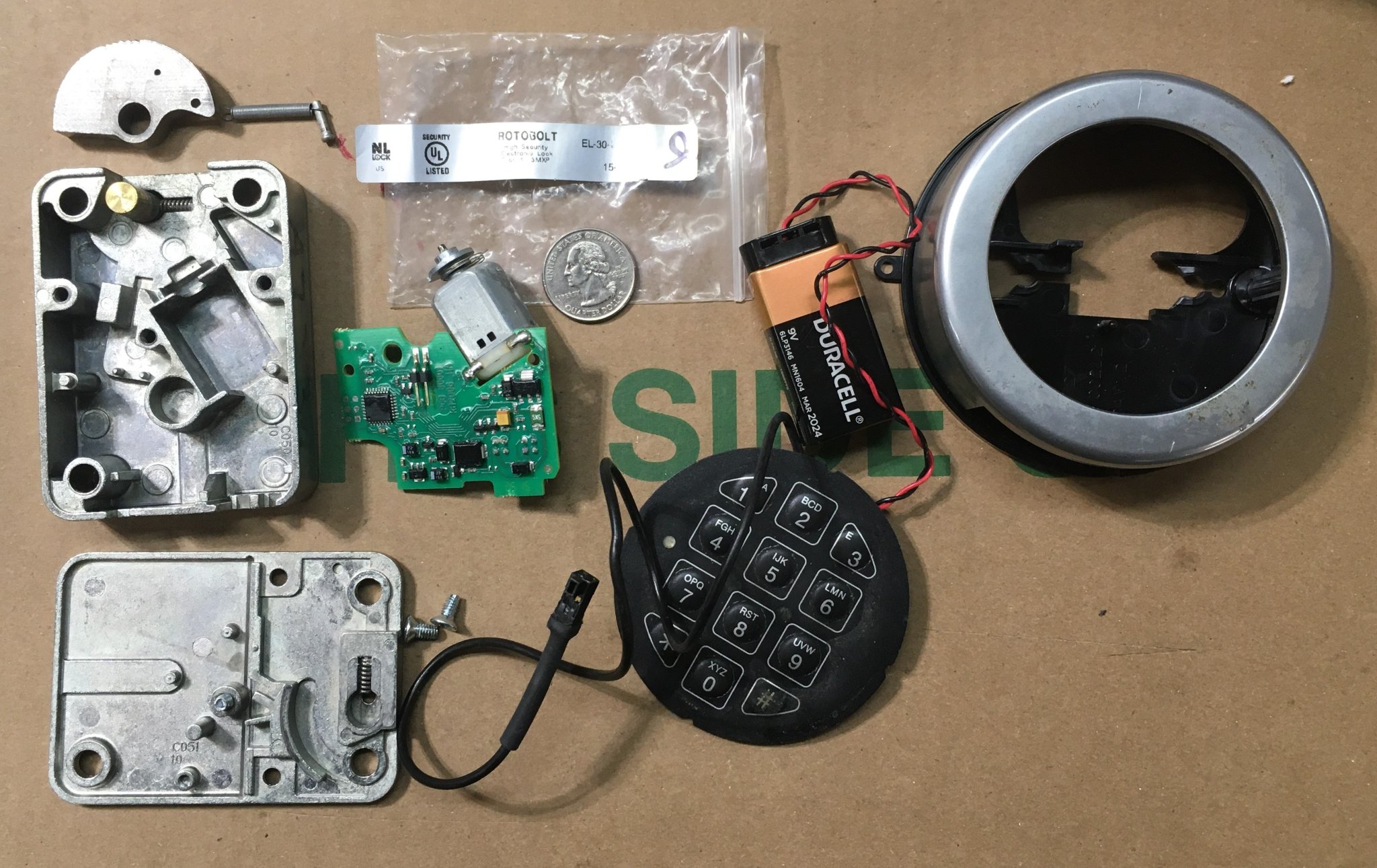

Here's some interesting info and pics on what's inside one of the so-called better digital keypad locks commonly found on today's safes:
My locksmith buddy brought me this digital lock that they had to remove from a safe. The owner wanted a dial lock put in. This digital lock had failed. I'm not sure how they were able to remove it or if the safe owner had left the door open at the last moment before calling this locksmith. My buddy asked me to play with it and see what I could figure out.

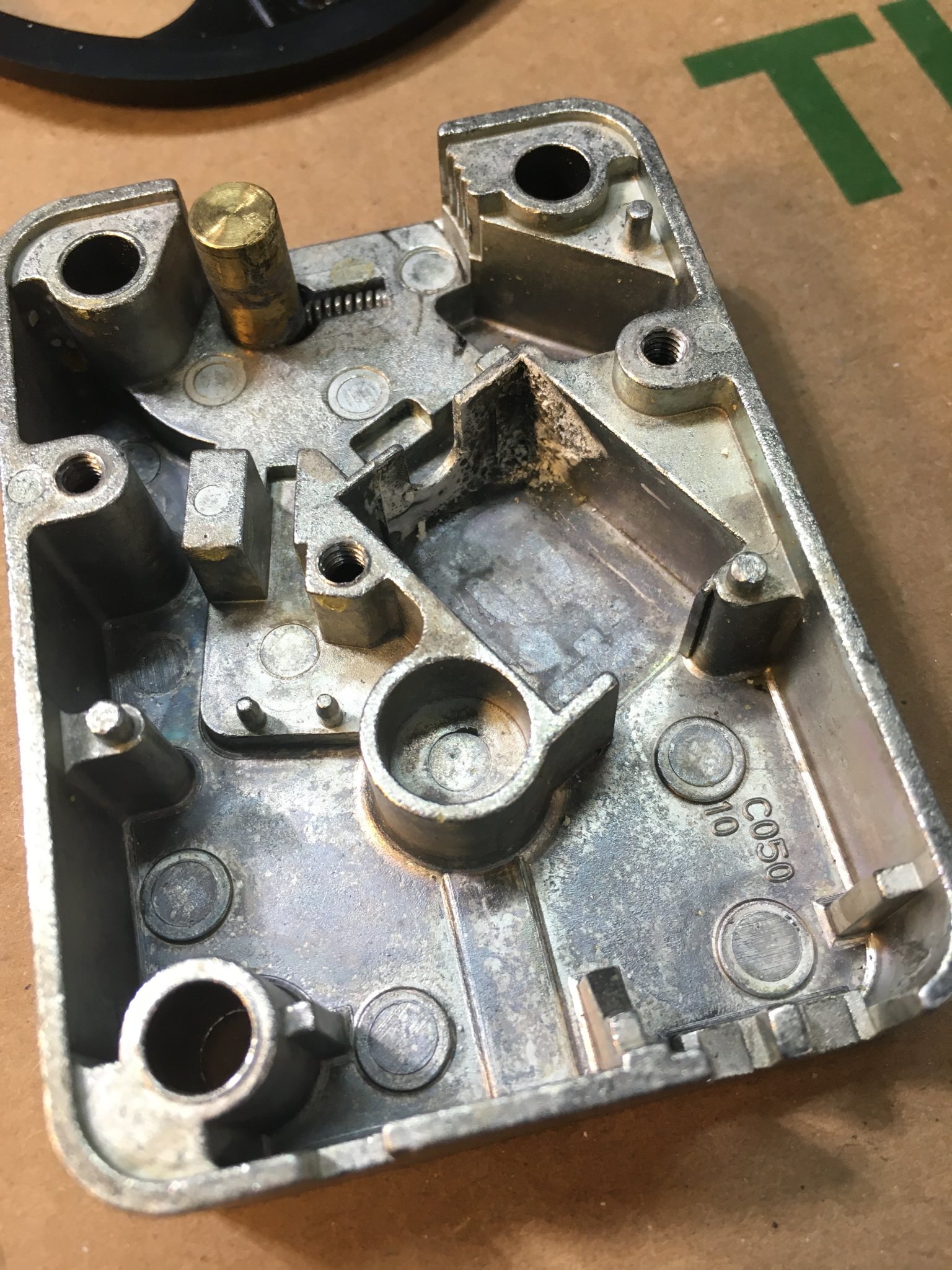

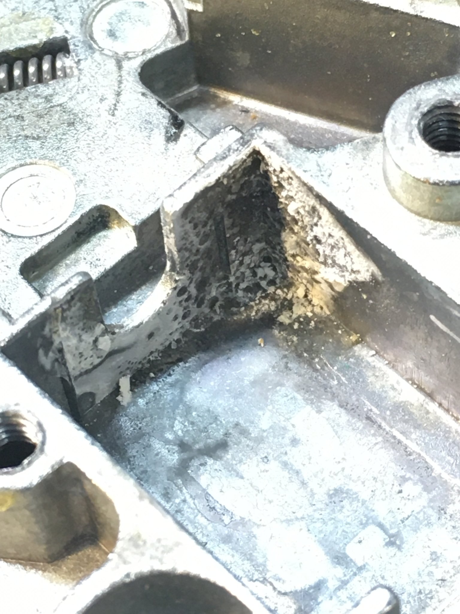

The lock didn't work, the keypad showed no life....even with a new battery in place. I took it apart and found some corrosion as seen right around the end of the motor shaft area. Oddly, the rest of the lock body was clean with no clue as to why the corrosion took place inside the motor housing area.

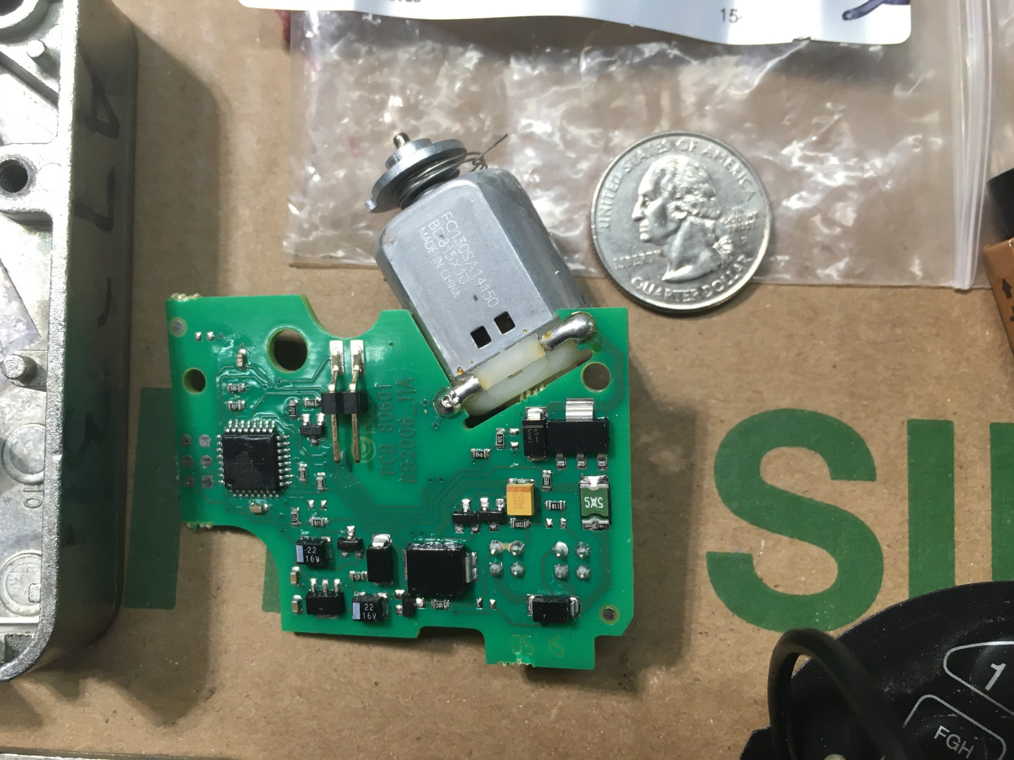

I removed the motor, took it apart, cleaned it, and tested with battery and it actually worked again. Reinstalled on circuit board and no sign of life. There was absolutely no help from emailing the manufacturer....they wanted to sell a new system. (This would never be used again anyway, but was just to learn from.)
There are two pins on the circuit board (next to motor) that almost scream "reset" pins. But shorting them together did nothing either. Alot of internet searching of different manufacturers revealed that their techs might have some "secret" key pad sequences for testing. Some sites gave suggestions for possible key pad "codes".
After all kinds of random codes punched in, suddenly there was a beep! I have no idea what was done to wake the controls up. But with those keypad sequences and the shorting of the pins.....all of a sudden the factory set code of 1, 2, 3, 4, 5, 6 worked again. That tiny motor would turn about 1/2 revolution to allow the rotory bolt to swivel. the motor would stay in that position for only a few seconds before de-energizing and returning to its bolt blocking position. To open the safe, you'd have to turn your handle within those few seconds that the motor's cam allowed the bolt to swivel.
With the instruction manual for changing the factory combo to a personal one, all attempts failed. Maybe that part of the programming was irretrievably lost or damaged.
The only corrosion internally in the middle of the lock body is still a mystery. Maybe the only clue can be found if you enlarge this thumbnail and zoom in on the motor data stamped on its body! :ROFLMAO:

As for myself and as RWS stated, I'd rather have a good mechanical dial lock such as S&G versus putting one's trust in a 50 cent circuit board controlling a 25 cent chinese motor.
