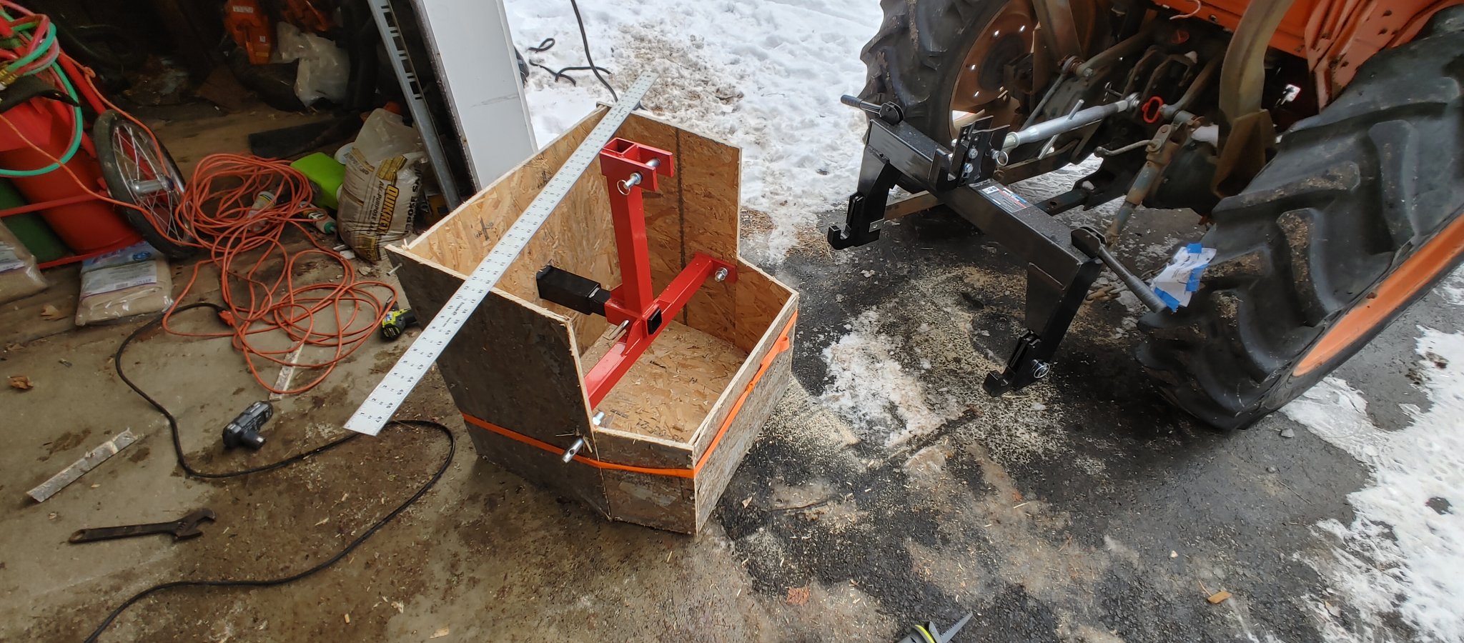

Gonna be (barely) warm enough to pour some concrete the next 4 nights so I'm going to try to build a ballast weight so I don't have to wait until spring:
Should be quick hitch compatible and weigh about 1100lbs... I'm off to go buy a bunch of bags of concrete and some rebar now...

If you put a couple of 2" PVC pipes upright in the rear corners, you have a place to drop a shovel or rake in ...
Are you gonna block off this purple area to fill in the back section?

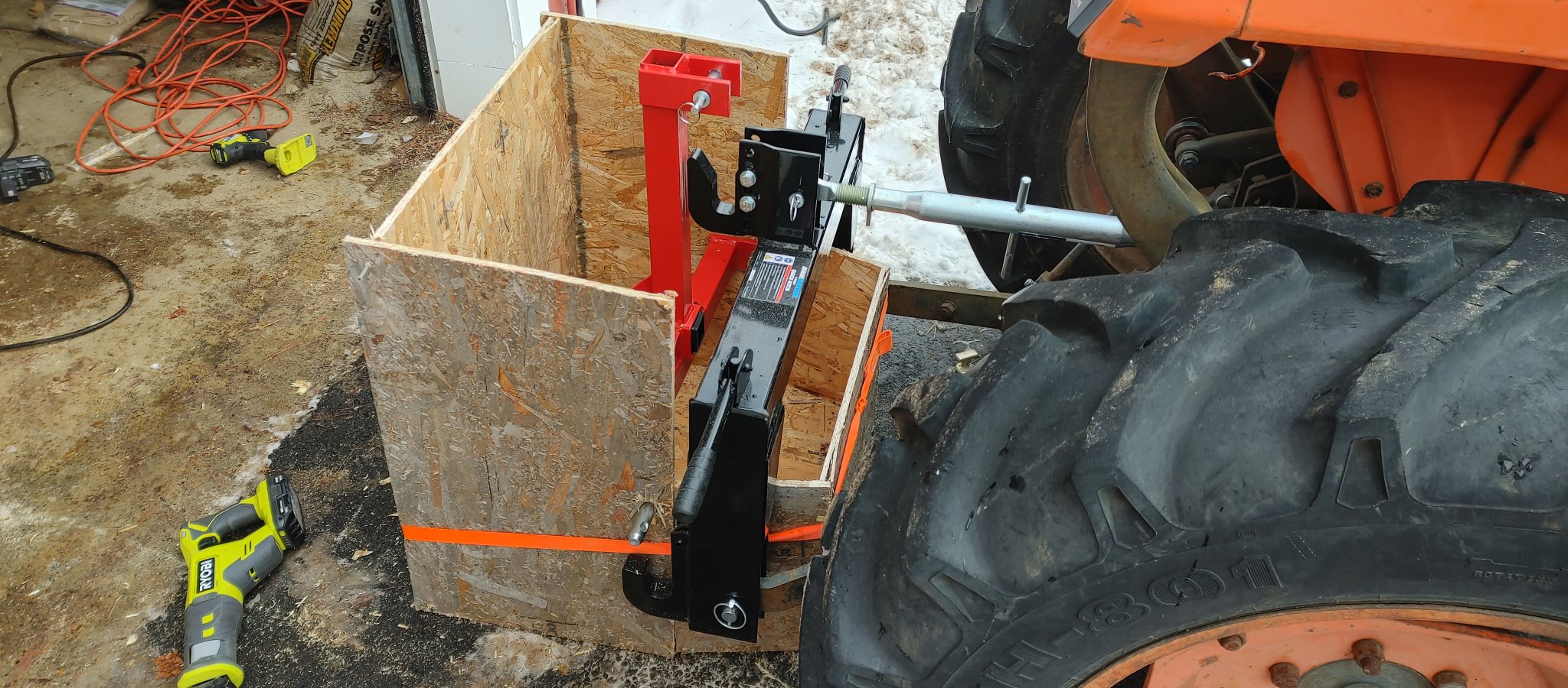

Halfway done, the PVC pipes were already planned. I'm also going to cast some coupler nuts into the sides so I could mount stuff on there later. Just got back with the second batch of concrete. My back hurts.

Got it all done a couple hours ago. I added some coupler nuts on the sides so I can bolt stuff on later and Wolfman made me paranoid, so I added the extra strap (there was some extra blocking that wasn't obvious already).
Cranked the wood stove and the space heater and got the garage to 58F, going to let it gradually cool down now, but it should stay 38 or higher overnight and then hit the fifties tomorrow.
