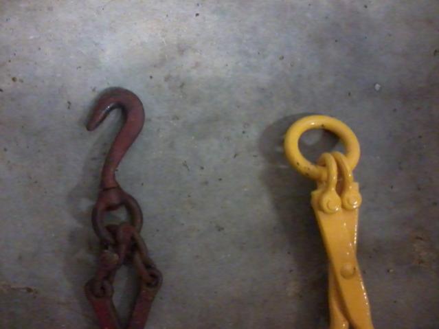

I have two tongs that are not identical. One has a ring and the other has a swivel hook. Both will hang off a grab hook so I think that's the way to go.

I think I misspoke in the above post because I was not clear on what a Grab hook is. Upon further review those are the ones with a slot sized for chain to slip into. Neither of my tongs will hang off one of those - the one with a hook on it is far to fat, and the ring on the other one is almost 3/4" diameter steel. I think I would need the big round open type of hook, sometimes called a 'sling hook'.
I don't see those as an option on the Bolt On Hooks site. I wonder if the ring shackle would work, at least for the tongs with the hook on them. For the others I'd need something in between to connect ring to shackle. Durn it. :(

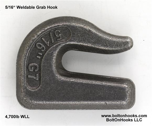

We do not make "bolt on 'SLIP'" hooks for one simple reason: There is NOT a suitable slip hook made for welding at this time. They ALL have some type of clevis or other such attachment on the end for rope/chain/wire rope, are already plated (health risk and possible porosity while welding), and NONE are beveled properly to ensure a strong weld like the weldable grabs are (see attached pic), and NONE are "rated" or intended for welding from the manufacturer.
Any slip hook option your see that is welded or otherwise attached to a bucket has been in some way modified to make it work, period.

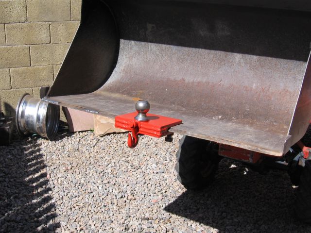

Probably no structural reason to not attach a hook to the bottom, but it may get in the way of other tasks.
I made this hitch/hook contraption, attaches to the bottom lip of bucket, can be used left/center/right, handy as all get out, and is easily removable for other tasks.
