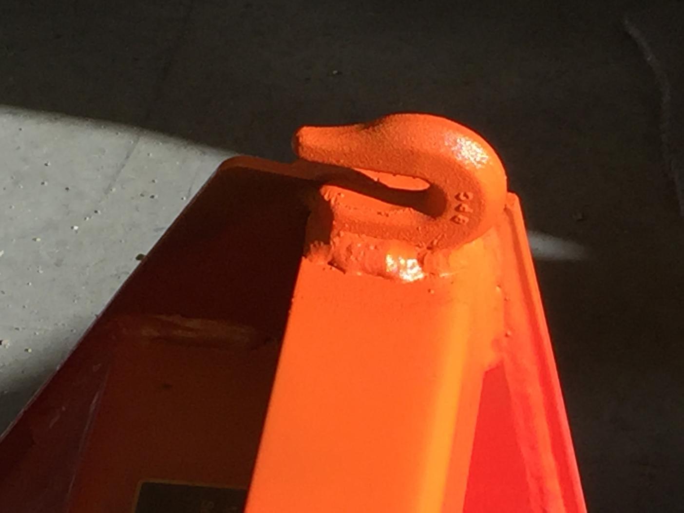

Just another option for you to look at with 3/8 hooks on each side and a center safety latch excavator hook for chains or straps in the center.

Kens Bolt on hooks.... google them. Put some on my B 2620 lifted a 600# gun safe with them, biggest thing i used them on so far. Works fine wished the hooks were a little bigger. Can barely get a chain link under them. Easy to install.

I can second the recommendation of Kenny's Bolt on Hooks.
It was one of the first mod's I did to my tractor.
Two years and lots of stuff moved.
He also sells Oblong Rings that fit the hooks. I use them when I am using a rope or strap.

Another thumbs up for Ken's Bolt-on hooks. I thought it was going to be a half-day project to install them. Took me a total of 10 minutes to install 2. Very happy with result.
P.S. I ordered his drill bit and deburring tool. Well worth it just to get the job done right and quickly.

The shear weight of the chain keeps it in the bucket mounted hooks, no latch or keeper is required especially since the open part of the hook is facing up most of the time.
We do have some "Twist-Lock" grab and slipp hooks for the chain though, great because the hooks cannot come off the chain when it goes slack.

In the conversion of my LA504 Loader to SSQA for the Artillian Fork frame, I purchased a new bucket and no bucket should be without hooks. :cool:
My set of Kennys hooks arrived today.
The SSQA bucket has a seam where the front edge of the bucket rolls back underneath the SSQA mount. After considering other mounting options and not finding anything I liked better than my original choice I decided to "just deal with it".
Drilling the holes was a bit of a bugger once I got to the seam since I was only drilling through half of it. A dremel tool helped to clean up the half hole.
I needed to fill the gap behind the seam so I made some spacers to fill the void. I wanted to fill the gap so that the bolt would tighten down straight and I wanted to fully support the washer(s) under the nut.
Now if I just had 3 more Grade 8 1/2" x 2" bolts.....:rolleyes: The 1 1/2" bolts that come with the hooks will not be long enough due to the additional thickness since I am using both USS and SAE washers under the nut to lock the spacer into place.
* - Kenny provides all the hardware necessary for a "typical" installation, which includes (grade 8) 1/2" x 1 1/2" bolts, USS and SAE washers, and nylock nuts. This is usually sufficient to mount the hooks "in most applications".
There are a lot of options for Orange buckets.....and locations that you can put the hooks.
If you have a "unique" application for the hooks or you are a certified anal retentive obsessive compulsive over achiever like me....
Consider ordering just the hook (without the hardware) or just make a trip to the local hardware for some longer bolts.
Kenny also offers pre-drilled backing plates and blank plates as well. I made my spacer out of one of the blanks.
