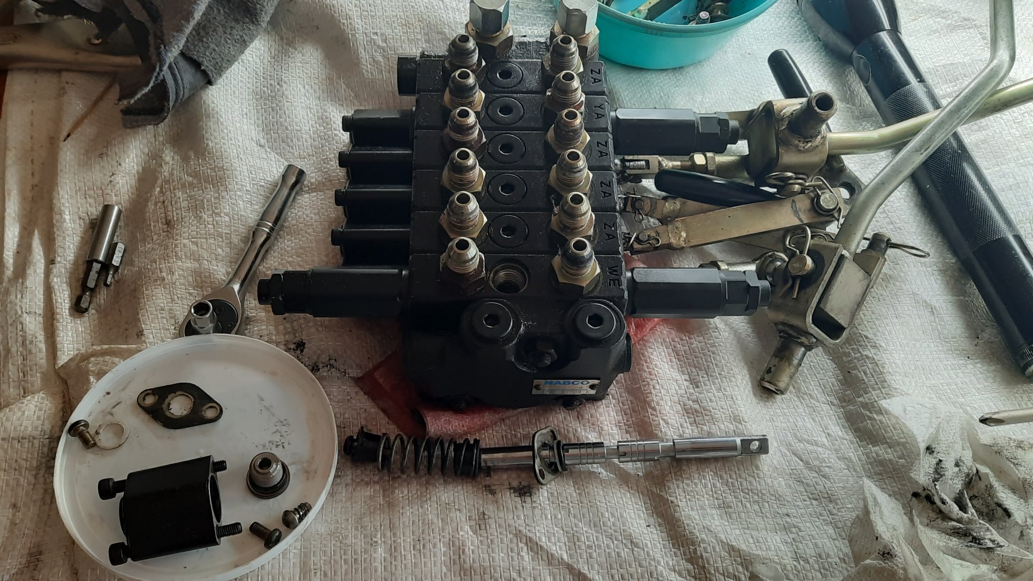

Update. Swing control valve disassembled. Spool removed and inspected. I have seen nothing remarkable...that is to say, all parts look OK, spring not broken, etc. The only thing that caught me off guard was the amount of "sediment" in the cap. It appeared to be at the bottom of the spring as well, so I'm wondering if that sediment would have prevented the spring from compressing? The sediment was just that...a black sediment. The ports of this valve did expel hydraulic fluid when I took the hoses off. The tractor is 19 years old, so sediment would not surprise me.
I have re-assembled and could press that spool down now even though it is not attached to the backhoe unit yet. I did not try to depress it prior to taking it apart...wish I would have. Maybe it will go now since there is no fluid.
Here's the dis-assembled valve. And, by the way, it was easy to take apart. Fortunately, I had purchased a set of hex bits; otherwise, I would've been "...without a paddle."
Any speculations are always welcomed. :)
TG

Looks like the control lever assembly is part of what you took off. Before you put the valve back in can you verify that the levers work the spools as expected?
If they do, chances are it will work fine when you put it back in place...

Yes any contamination in the cap can prevent some movement of the spool in that direction. Clean it up and reassemble. I would coat the spring assembly lightly with oil before installing the can to help with rust.
Was the screw that holds the spring to the spool loose or did you remove it? That could cause the issue as well.

No the lever assemblies pivot in the cover assembly that bolts to the frame of the step assembly.
In that case I suppose they can't be checked before assembly then because they don't have a solid point to mount to.
I don't know the setup and can't visualize what is there to be honest. Just know it pays to check what one can before assembly if possible. In any event, what's the chances that the problem was in the lever assembly mechanicals? Probably slim.

I would say you have done excellent. I am inclined to say you found your problem, and in the process have learned a great deal.
[/QUOTE]
No more calls...we have a winner! Apparently it was the sediment, keeping the spring from compressing totally. Personally, I can't believe it but, nonetheless, I feel like a million dollars...all green and wrinkled :)

Good deal. While you have it off, I'd probably take the caps off the other spools, flush them out/off, and coat them with oil like Ruger1980 suggested. Then make sure they work both ways and reinstall. Job well done!

Yes, I should have done that. But...I didn't. It was in my mind that if one had sediment, probably the others would, too. Today, I was looking forward to finding out if the main problem was solved. Now that I see how to remove all the components, I may decide to do that, especially now that the weather will be cold for a while. Thanks for the reminder.
